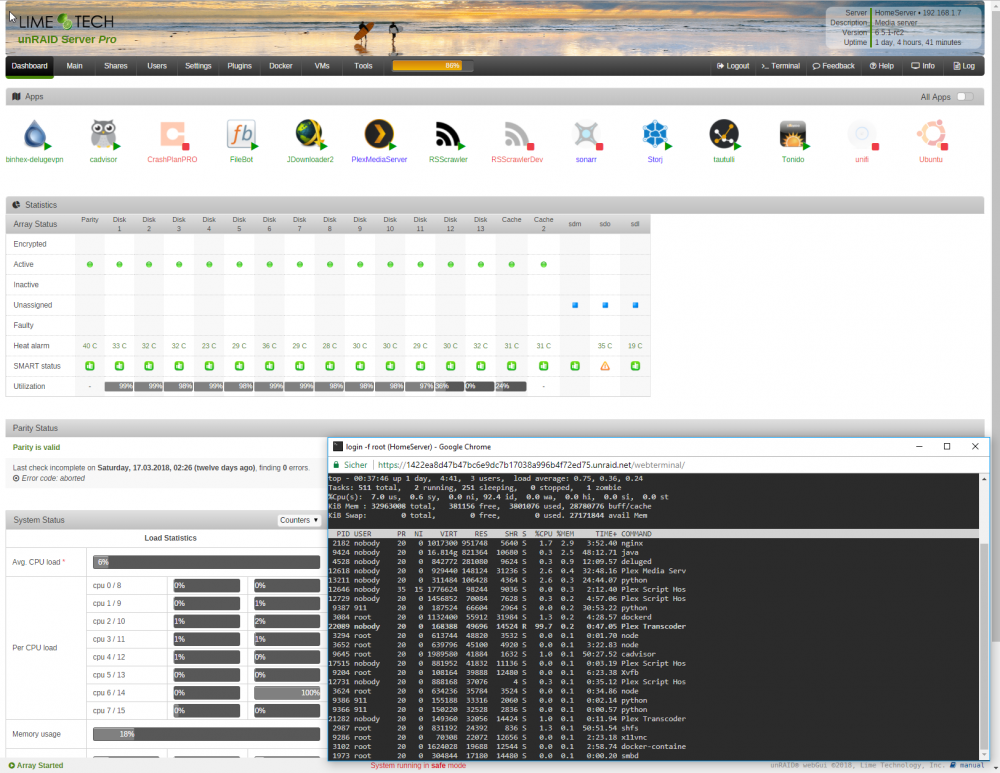

Hello,
like you can see in the screenshot below nginx uses 30% of my installed ram. Up to the point where the webinterface states that 100% of my ram is used and the system pauses till it somehow freed up some ram. This now happened the second time and i only noticed that with the newest 6.5 version.
And the 30% stays the same even when i stop all my docker containers. (the java process which also uses 30% ram is from crashplan and a 40tb+ backup)
So my guess is that the nginx process could be from the new webinterface, am i right with that?
Does anybody have any tip to further investigate what is causing this?

Java Process 17011 using 17 Gig Virtual and 3.2 Gig Resident is from JDownloader
Java Process 535 using 26 Gig Virtual and 9.8 Gig Resident is from Crashplan
nginx process 18016 seems to be spawned from the main process thread and is not from any docker.
Memory indicates 24 Gig of 31 Gig is in use, with 6.1 Gig used as various buffers.
root      6472  0.0  0.0  68520  5580 ?        Ss   Mar17   0:00 nginx: master process /usr/sbin/nginx -c /etc/nginx/nginx.conf
nobody   18016  0.2 29.4 9773584 9707828 ?     S    Mar20  14:04  \_ nginx: worker process
Edited by BRiT

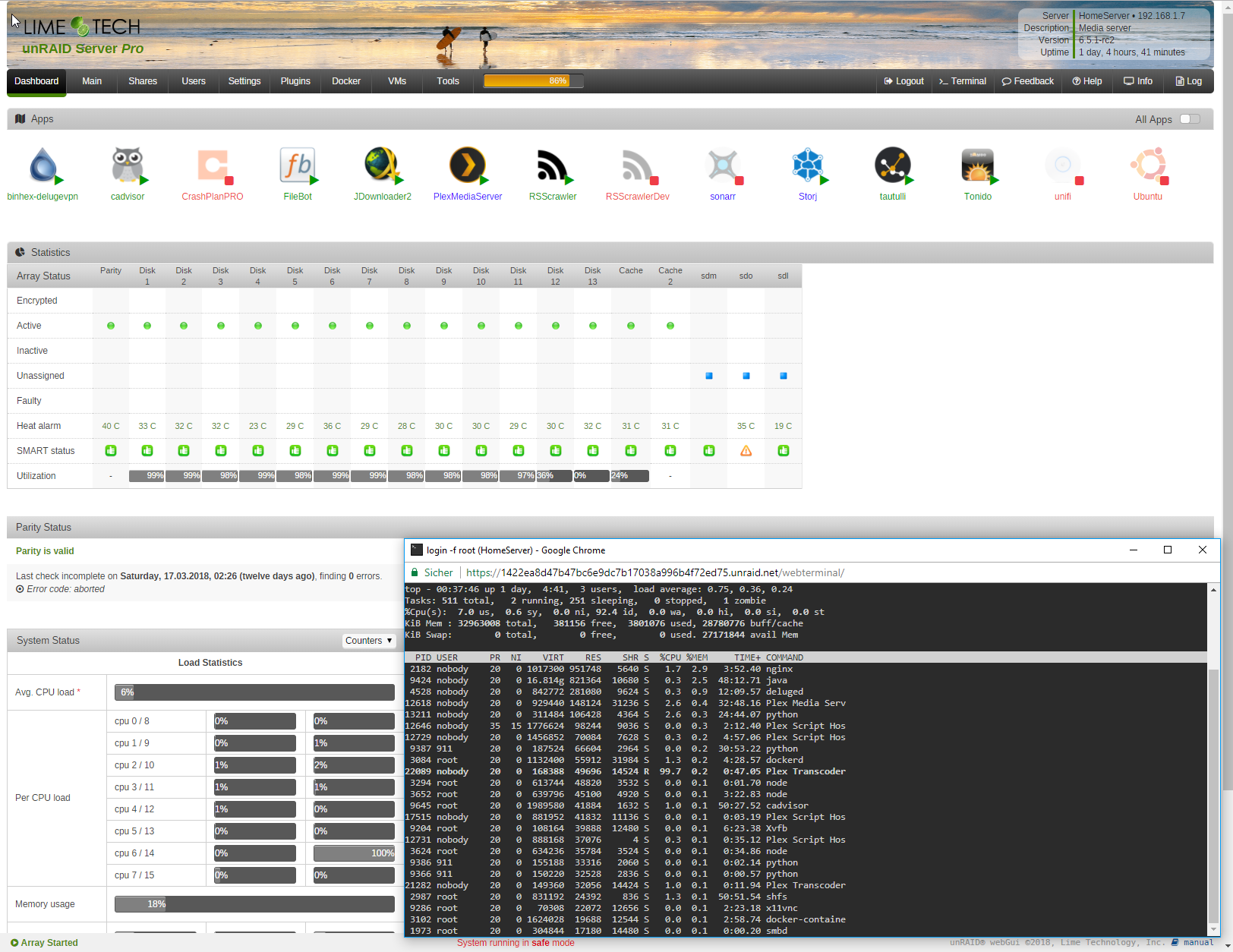

yes the screenshot isnt right from the moment when the system was at 100% and when unraid had to force close some processes. To further clarify this i post a screenshot of my processes now.
as you can see the nginx process is slowly but steadily growing over time. And 9GB+ only for the nginx process of the webgui seems extremly high to me.
if also seen that the last time that happened unraid also wrote an "out of memory" warning into the log file

top - 19:36:49 up 2 days, 15:08,  2 users,  load average: 0.99, 1.11, 1.13
Tasks: 566 total,   1 running, 301 sleeping,   0 stopped,   3 zombie
%Cpu(s):  1.8 us,  0.5 sy,  0.0 ni, 97.6 id,  0.1 wa,  0.0 hi,  0.1 si,  0.0 st
KiB Mem : 32963008 total,   305096 free, 23242512 used,  9415400 buff/cache
KiB Swap:        0 total,        0 free,        0 used.  8397600 avail Mem
  PID USER      PR  NI    VIRT    RES    SHR S  %CPU %MEM     TIME+ COMMAND
22004 nobody    20   0 26.181g 8.252g   6220 S  22.8 26.3   1216:15 java
 6472 nobody    20   0 7123612 6.731g   5572 S   0.7 21.4   6:12.96 nginx
12952 nobody    20   0 17.710g 4.418g   1532 S   2.0 14.1   1040:45 java
18234 nobody    20   0 1822460 481152   5124 S   0.0  1.5  10:26.53 mono
16792 nobody    20   0 11.242g 403552      0 S   0.7  1.2  13:23.23 java
11712 nobody    20   0  736736 256936      0 S   0.7  0.8  46:29.59 deluged
23729 nobody    20   0  640628  98488  24776 S   2.3  0.3   0:43.52 Plex Media Serv
26124 nobody    20   0 1041788  92304  30720 S   0.7  0.3  41:51.87 crashplan
 7108 root      20   0 1797884  83028    908 S   1.3  0.3   1445:05 shfs
11074 nobody    20   0  291752  78904      0 S   0.7  0.2  11:20.86 python
23855 nobody    20   0 1456456  65948   8152 S   0.0  0.2   0:08.27 Plex Script Hos
 5352 911       20   0  183340  65372   4388 S   0.0  0.2   0:38.10 python
24768 nobody    20   0  991312  64984  22408 S   0.7  0.2  14:42.84 crashplan
 8727 root      20   0 1801636  59992  32432 S   0.3  0.2   8:17.56 dockerd
19291 root      20   0 2394616  52016   5436 S   2.0  0.2 118:24.18 cadvisor
23756 nobody    35  15 1772784  51480   6012 S   0.3  0.2   0:09.86 Plex Script Hos
 9071 root      20   0  613768  47096   1492 S   0.0  0.1   0:01.67 node
12271 root      20   0  118376  45936  16380 S   0.3  0.1  44:00.27 Xvfb
 9576 root      20   0  644548  45688      0 S   0.0  0.1   6:27.17 node
23857 nobody    20   0  888440  42492   5496 S   0.0  0.1   0:05.07 Plex Script Hos
 5329 911       20   0  150216  39100   9408 S   0.0  0.1   0:00.37 python
17742 nobody    20   0 1596200  34532      0 S   0.3  0.1  15:50.35 mongod
 5351 911       20   0  154316  33880   3488 S   0.0  0.1   0:00.01 python
 9482 root      20   0  634132  32976    988 S   0.0  0.1   0:59.54 node
12914 root      20   0   71300  25848  16080 S   0.0  0.1  18:31.11 x11vnc
 7147 root      20   0  184744  23284  17904 S   0.0  0.1   0:05.59 auto_turbo.php
 8746 root      20   0 1570868  21920  13376 S   0.3  0.1   5:38.43 docker-containe
21951 root      20   0   93376  20476   9144 S   0.0  0.1   0:09.82 Xvfb
24753 root      20   0   72516  18620   9180 S   0.0  0.1   2:16.73 x11vnc
 2004 root      20   0  304844  17252  14480 S   0.0  0.1   0:00.37 smbd
 9318 root      20   0 1367272  16556  10644 S   0.0  0.1   0:00.44 libvirtd
 4477 root      20   0  309700  15804  12768 S   0.0  0.0   0:00.02 smbd
21625 root      20   0  187244  14968   9224 S   0.0  0.0   0:00.09 php-fpm

okay i start testing with safe mode now. I just wanted to know at what point i should worry about ram usage of the nginx process while running in safe mode.
it seems like its happening again in safe mode:
