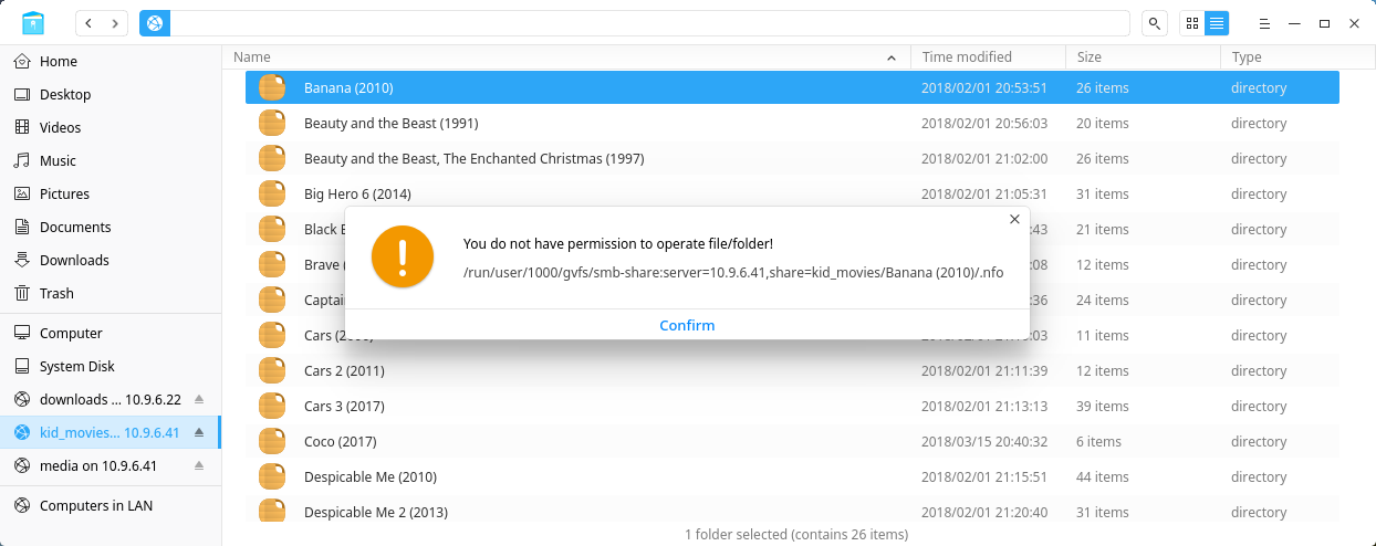

I am having a problem with the permissions with smb from my linux PC i can connect to any share but i can not write or make any changes. with my windows PC i get block from access. i believe started today. I also have another unraid server and have no problems at all both are running ver. 6.5.  any help would be great thanks
