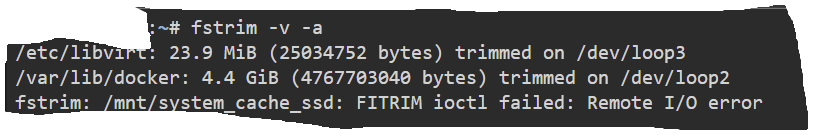

October 23, 20214 yr buyed for first time 9207-8i and connected 2 SSD to it, also see this error . so i understand i need to flash it from p20 to p16 for trim will work on unraid 6.9.2 too? i have kingston :SSD 1. sv300 ------ 2. suv500 - Deterministic read data after TRIM i can see that only suv500 trim not working ?
July 12, 20224 yr Digging this up to say that I recently bought a 2TB Samsung 970 EVO for a Nextcloud cache, and had totally forgotten that my Dell PERC H310 didn't support TRIM until I received the "fstrim: /mnt/ssd2tb: FITRIM ioctl failed: Remote I/O error" email from Dynamix SSD TRIM yesterday morning. While my onboard SAS port does support TRIM, it only has 2x SATAIII ports, with the others being SATAII - and the two SATAIII ports are already taken up by the 2x 850 EVO SSDs in my (regular) cache pool. So, a very big thanks to @ezhik for their work finding out that P16 works well, as well as providing a copy of the firmware and flashing instructions! After some nail-biting to-and-fro trying to flash the card (getting errors when I tried flashing it in my server - it erased fine, of course though lol - but then it worked when I used my desktop PC), I'm now running P16 and TRIM runs without error.

May 21, 20233 yr So my home built server for 6 plus years has finally given out. I replaced it with a Dell Power Edge T430 with a MD1200 expansion. I am using HBA and I am having 2 issues: 1. twice now the system stopped acknowledging my USB ports 2. I now receive the following: fstrim: /mnt/cache: FITRIM ioctl failed: Remote I/O error I've read about downgrading the firmware for the fstrim issue - but was wondering if anything has changed since the post in 2021. Also were to start with the USB driver issue or at least I think it is a driver issue. I can supply logs, but just need to know best place to start the research to fix. I told my wife the NEW system was going to be a breeze to setup... wishful thinking on my part 🤬😡😠
