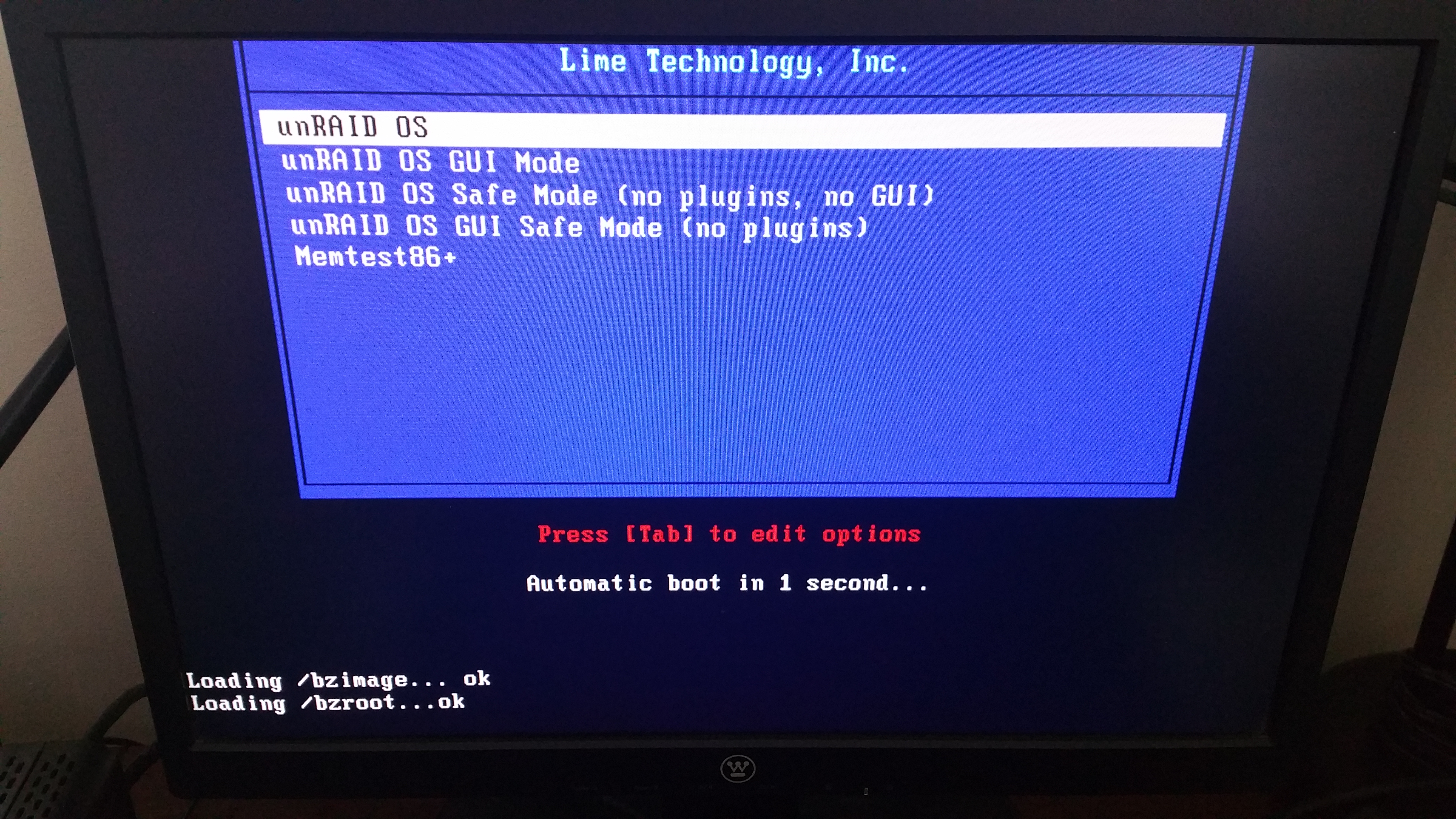

My config is as follows: ASRock - H170A-X1, Celeron G3930, single 8gb DDR4 450w bronze PSU. I'm running 6.4.0. When I first started, I had an ancient ATI GPU (x1900) installed because I needed a VGA port and the mobo didn't have one. I removed it when I got a monitor with DVI, that's when this issue started.
I've been all over the Google looking for a solution to this problem, but the only thing that I've found helpful is the advice to boot into GUI mode. The picture attached shows what happens when I try to boot normally. It stays there indefinitely. Booting into GUI mode seems to fix it for now, but that's a band-aid and I know it.
Any ideas what could be causing this issue and/or ideas on how to fix it? Is there anything I've left out that could be helpful?

Would you confirm unRAID not starting in background, i.e. access the GUI in remote ?
Indeed. I get a page not found when I try to get into the webui.
Same issue have some reported, but seems no followup or solution share.

20 hours ago, bonienl said:
People with ASRock motherboards may try this solution.
Funny enough, I went to do that this morning and decided to see if ASRock had a Spectre/Meltdown BIOS since I'd be messing with it anyways. Installed new BIOS, reset my fan curves, and now it's fine.
To my credit, I was on the most recent until earlier this month. Even if "most recent" was 2016, lol. Should it happen again I'll check the legacy mode settings.
