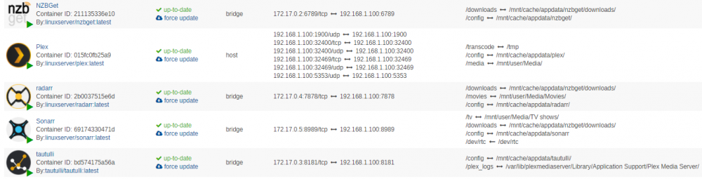

I have checked all my docker paths and im pretty sure they're correct? (see image)

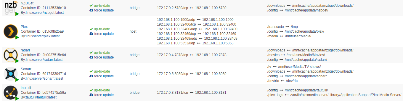

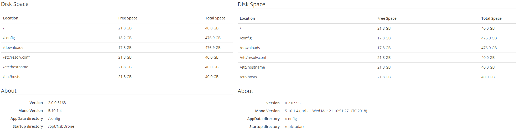

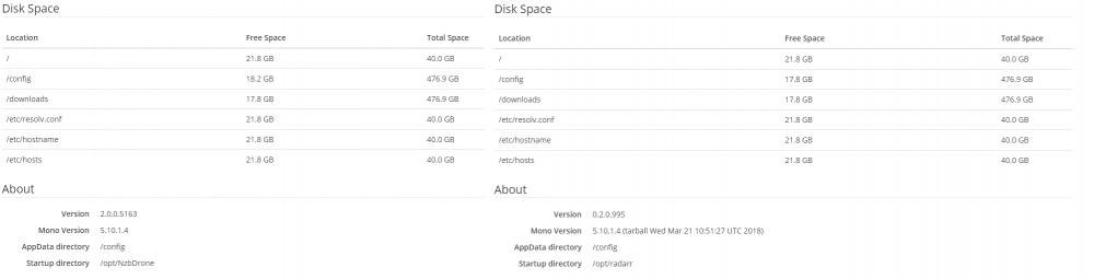

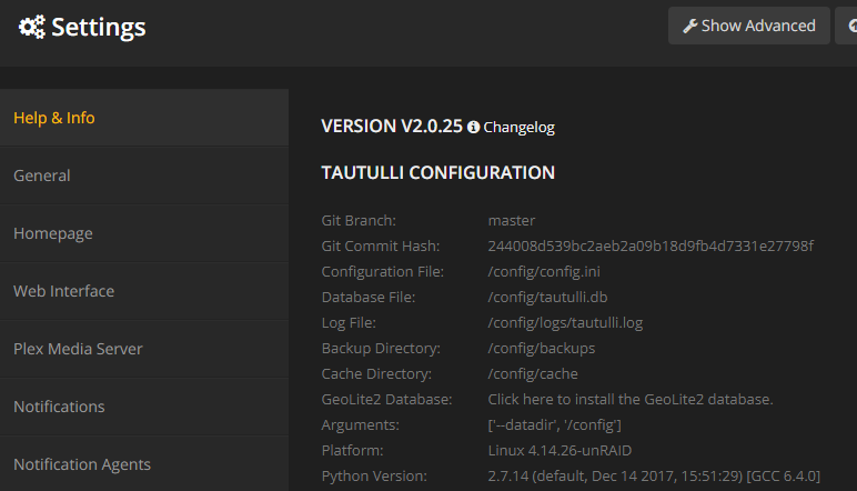

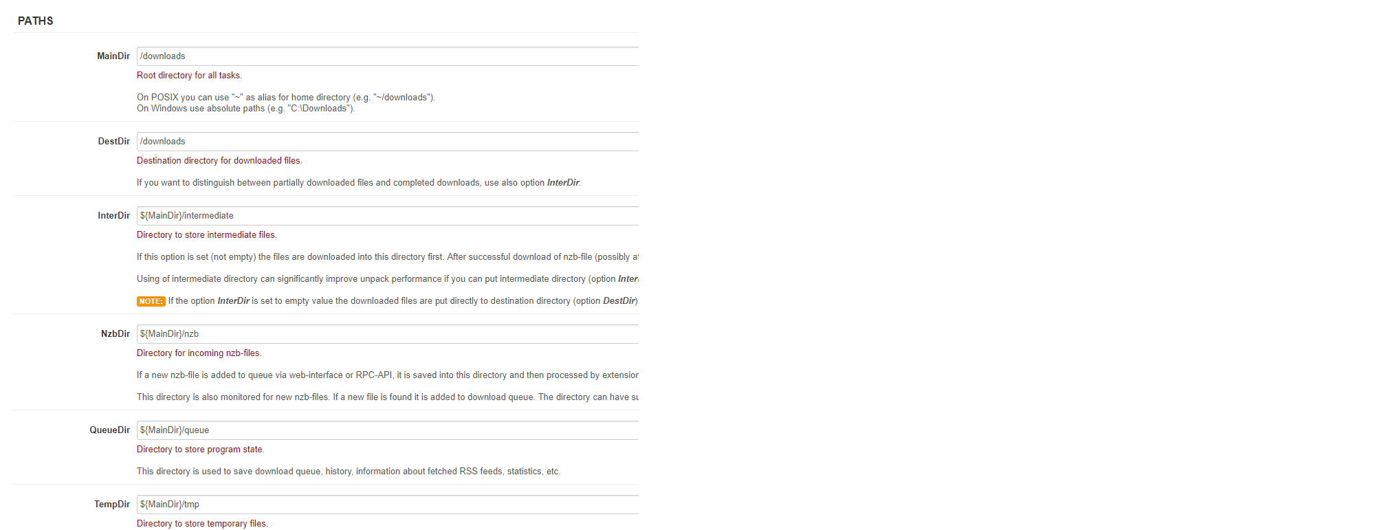

Ive gone through all dockers i have and got the screenshots below. To me they look fine?
I don't see anything obvious in the screenshots. You might take a look at the section of the Docker FAQ that talks about filling up due to excessive logging.
