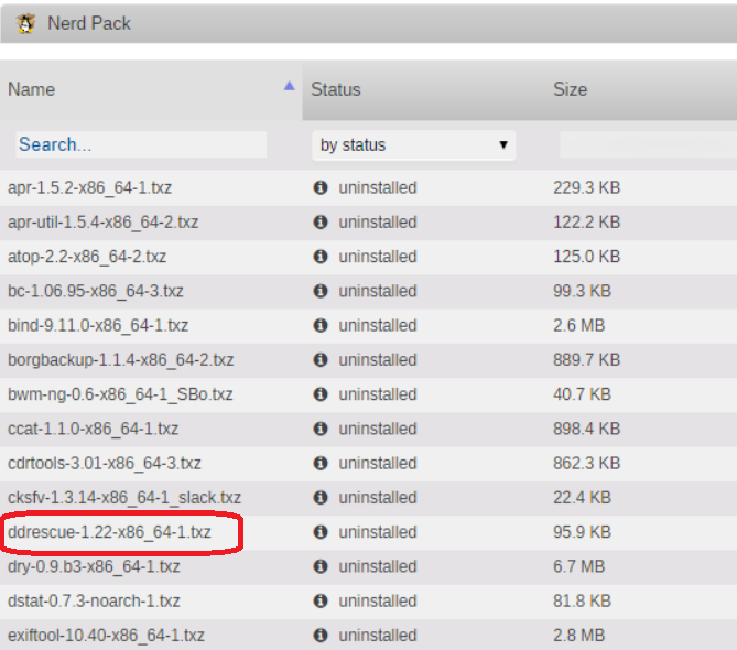

I installed Nerd Pack already. Why command not found?
Nerdpack doesn't install any of its packages by default. It allows you to choose which to install.
So how do I install ddrescue?
What name? There is no ddrescue as such.
nerdpack.pngNerd Pack

No updates when checked. Just installed last week.
No idea then, post in the plugin thread.
Now that I think about possibly because you're on a very old unRAID release, some utils might require a more recent one.
Can I safely upgrade in my situation?
