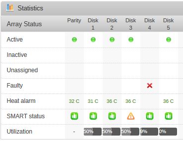

I've attached an image to further clarify of my current predicament.
Have you studied the wiki on parity swap? Here is the link:
https://lime-technology.com/wiki/The_parity_swap_procedure
I suggest you read it all and ask if you have any questions. You can start at step 5 since the disk is already disabled.
You can remove the disabled disk since it is not used during the procedure. So, you don't actually need any more drives than you have currently.
Double check all connections and hang on to the original disk in case there are any problems.
You can test the new disk on another computer first if you want. Since the drives you are talking about are fairly small none of this should take more than several hours.
