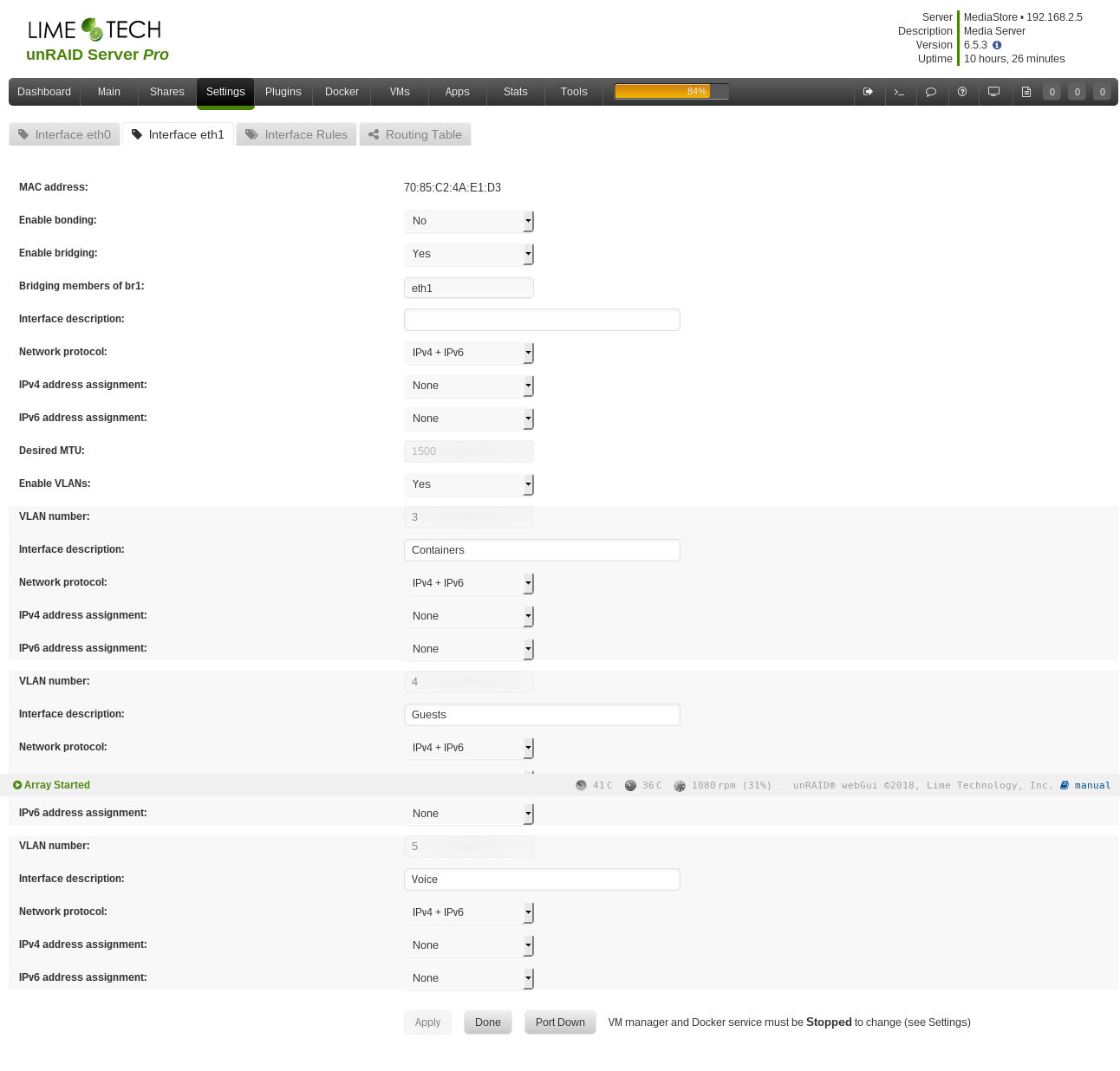

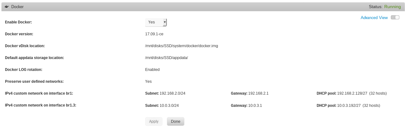

Currently using a mix of everything:
bridge
host
br1 (custom IP)
br1.3 (VLAN)
but not using br0 or br0.x
and so far no call traces...
current NICs are
Intel I211 (igb) - eth0
Intel I219-V (e1000e) -eth1

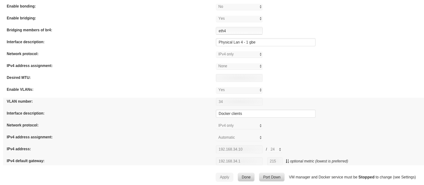

  • I was getting macvlan call traces this past year on Unraid 6.8 and 6.9. I have unifi hardware also and have always had vlans and static ip's for dockers. Here's some things I have done since I started
So I finally decided that using ( br0 which unraid runs on ) with VLAN's is not a good idea for me.
Since I have more ethernet adapters on my server, I decided to use eth4 and put all my docker VLAN's on that.
It's fairly early, but I'm pretty sure that I have gotten rid of my call traces.
One note, you have to set interface IPv4 address assignment to None.  If you don't do that, unraid will assign an arbitrary ip address.  But the bigger problem especially with my network is that you will constantly loose and regain an ip address on the main VLAN interface from the dhcp server.  This would occur randomly between 15 minutes to two hours.

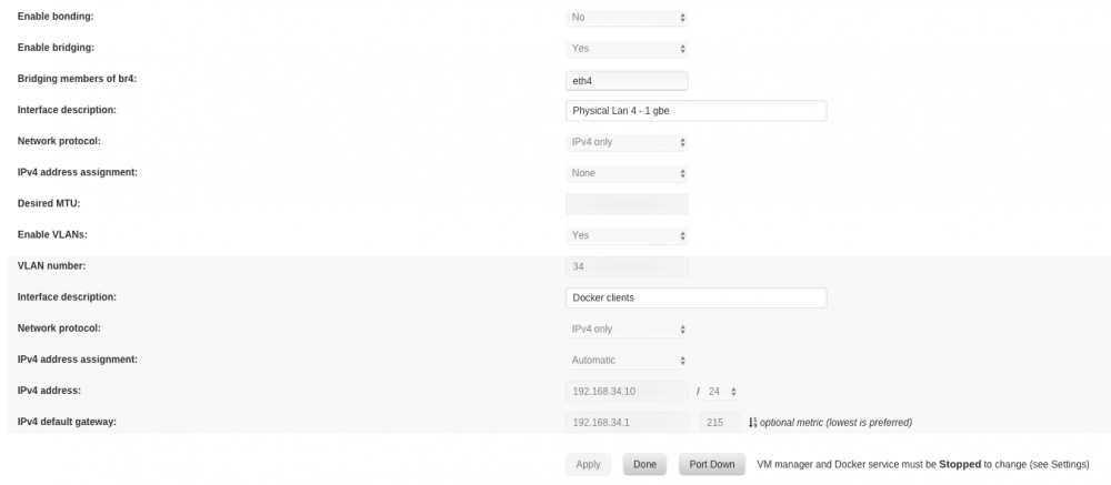

So my final setup for the VLAN is as follows:
1168687376_ScreenShot2018-06-12at5_06_47PM.thumb.png.894343d1adbc3c4c38e10eb3c874e3a8.png

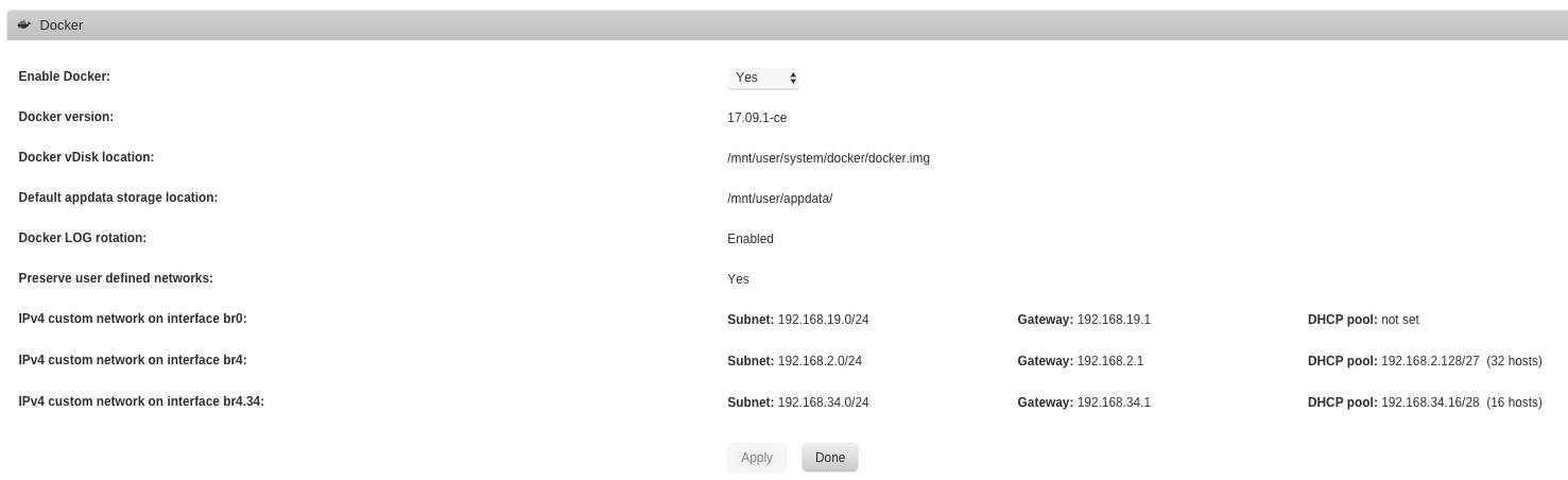

And I have a docker pool setup as:
889359873_ScreenShot2018-06-12at5_11_04PM.thumb.png.719f4e76755f9aa0a69c6202b5008fb6.png
Hope this helps anyone with VLAN problems.

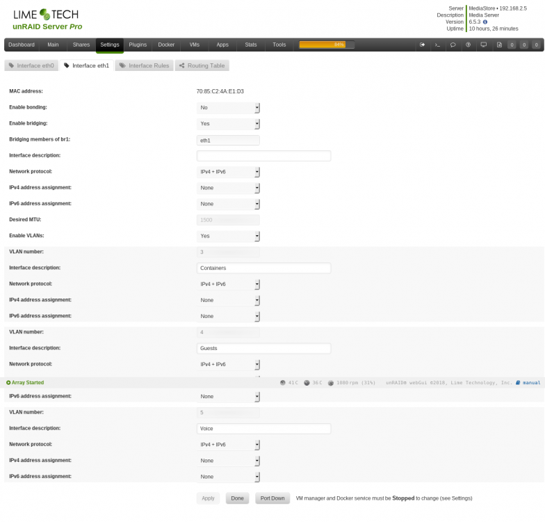

My network settings for eth1
My Docker Settings
Hope this helps.
Hi ken-ji,
Posting that helped a lot and I was able to figure out my issue.  Apparently I needed to assign a pool to br4 as well in order for br4.34 to be available.  So my docker settings now look as follows:
2056989612_ScreenShot2018-06-13at8_47_45AM.thumb.png.d9ebdda34c17df3a6e341daf9427857b.png
Just out of curiosity, are you actually using 192.168.2.XXX for anything in your system.  Or did you just set this up for isolation.
Thanks for you help.  I will see if this rids me of the call traces.
Odd. You shouldn't need to since from the docker networking point of view br4 should be independent of br4.34
I'll look into stopping my array to help check that out or maybe @bonienl can confirm.
192.168.2.xxx is my main network.
I've assigned it to br1 so as to allow any dockers running on br1 to be able to access unraid (nginx reverse proxy, etc) and vice versa, otherwise the macvlan security limitation kicks in.
you can just nuke the docker network on br0 and place it in br1. which might be why I never see call traces :D
Main interface (eth4) and VLAN interface (br4.34) work completely independent from each other. And each may have different settings.
As @ken-ji suggests the easiest approch is to uncheck br0 under docker settings and assign the same network settings to either a VLAN interface or another physical interface.
If you don't specify a DHCP pool then docker will do DHCP assignment which may interfere with your router DHCP server.

6 hours ago, Limy said:
in the Docker Settings a pool should always be assigned otherwise Docker is running a DHCP server and is competing with my routers DHCP server
Docker itself is unaware of the IP addresses handed out by your regular DHCP server. If no explicit DHCP pool is configured, docker will simply start with the first IP address in the range (usually .1) as assignment. This may or may not interfere depending on your current IP assignments.
It is safer to set up a docker DHCP pool, which is in a range not used by your router or other devices.
