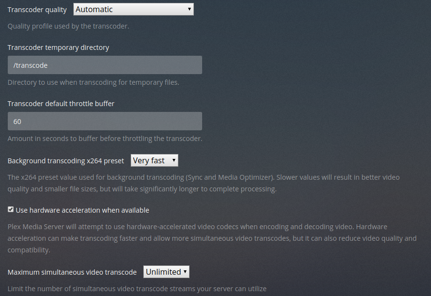

I've been trying to enable HW transcoding by doing the steps in that thread above and what I found online but to no luck. Here's what I've done so far.
Set the container like this:
Executed these commands and there were no errors when using the `modprobe` command.

Then started the Plex container back up and -> Transcoding -> Advanced -> Enabled HW transcoding.

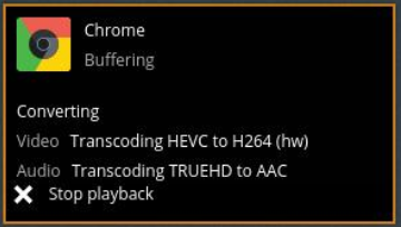

Playback is still a no-go. If it's any help I'm trying to transcode HEVC to H264. But I think I'm getting a bit of contradictory info from Plex (probably just me not understanding what it means).
According to that, the stream is using HW encoding.
From the logs, however, I get a `HW device failed` error but then it looks like it starts with hardware decoding. Maybe the 6700 iGPU isn't fast enough?.

Skylake can only decode hevc up to 8bit in hardware.
H264(hw) means that it encodes the video in hardware, but the decoding is not hardware, thats why you dont have hevc(hw).
Ah, I didn't know that. Then that's most likely the issue as the info for what I'm trying to decode says...
Codec HEVC
Bitrate 53049 kbps
Bit Depth 10
Well, at least I got actual HW acceleration in Plex working for other stuff... I think haha.
