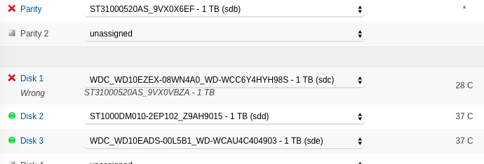

HI all,
Need some help I am a newbie to Unraid, although it has been running flawlessly for 3 months. I had a drive fail, showing as unmountable. So got a replacement drive added it and unplugged the parity drive instead of the failed drive. I booted and noticed parity was gone powered down and reconnected the parity and removed the failed drive. When I booted back up it is showing no drive assigned for parity and I can select from 2 drives. Both of these show up as new devices. Did I just kill all the data? If not how can I resolve this mess. Sorry for being a newbie dumbass.

Your diagnostics seems to think that X9SZ (last 4 characters of serial) is newly assigned to parity, but that H98S is wrongly assigned as disk1. Do you know which disk is the new disk?
Usually we would assign NO disks to parity and assign ALL disks as data disks, then try to start the array, and if only one disk is unmountable then that is the parity disk. But you said you had intended to replace a disk that was already unmountable (which wasn't the correct way to proceed in that case) so you will probably have 2 unmountable disks. We really need some way to know which disk is which.

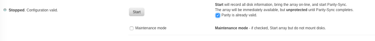

Parity drive has a warning - All existing data on this device will be OVERWRITTEN. So I guess Parity is not valid. Is there another route?
That is just a warning, as long as "parity is already valid" is checked it won't be overwritten.
Just making sure this is what you are talking about (see screen shot attached)image.thumb.png.c715a11ae11e56da873b55d15e2b4f69.pngScreen Shot 2018-03-31 at 2.24.15 PM
Awesome all is as it was. Thank you! It even mounted Disk1. Do I still need to replace it or is there a repair I can do on the disk?
