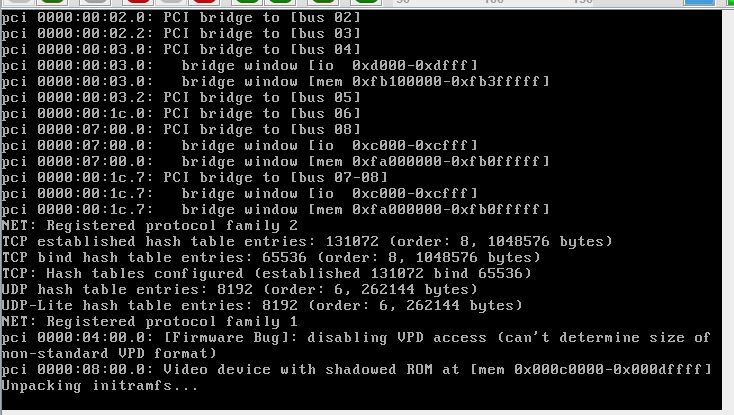

Hello I have the X540-T2 Anyfabric card and after upgrading to 6.5 I keep getting this during the kernel load
"pci 0000:08:00.0: [firmware bug]: disabling VPD access (can't determine size of non-standard VPD format)"               - Picture attached.
