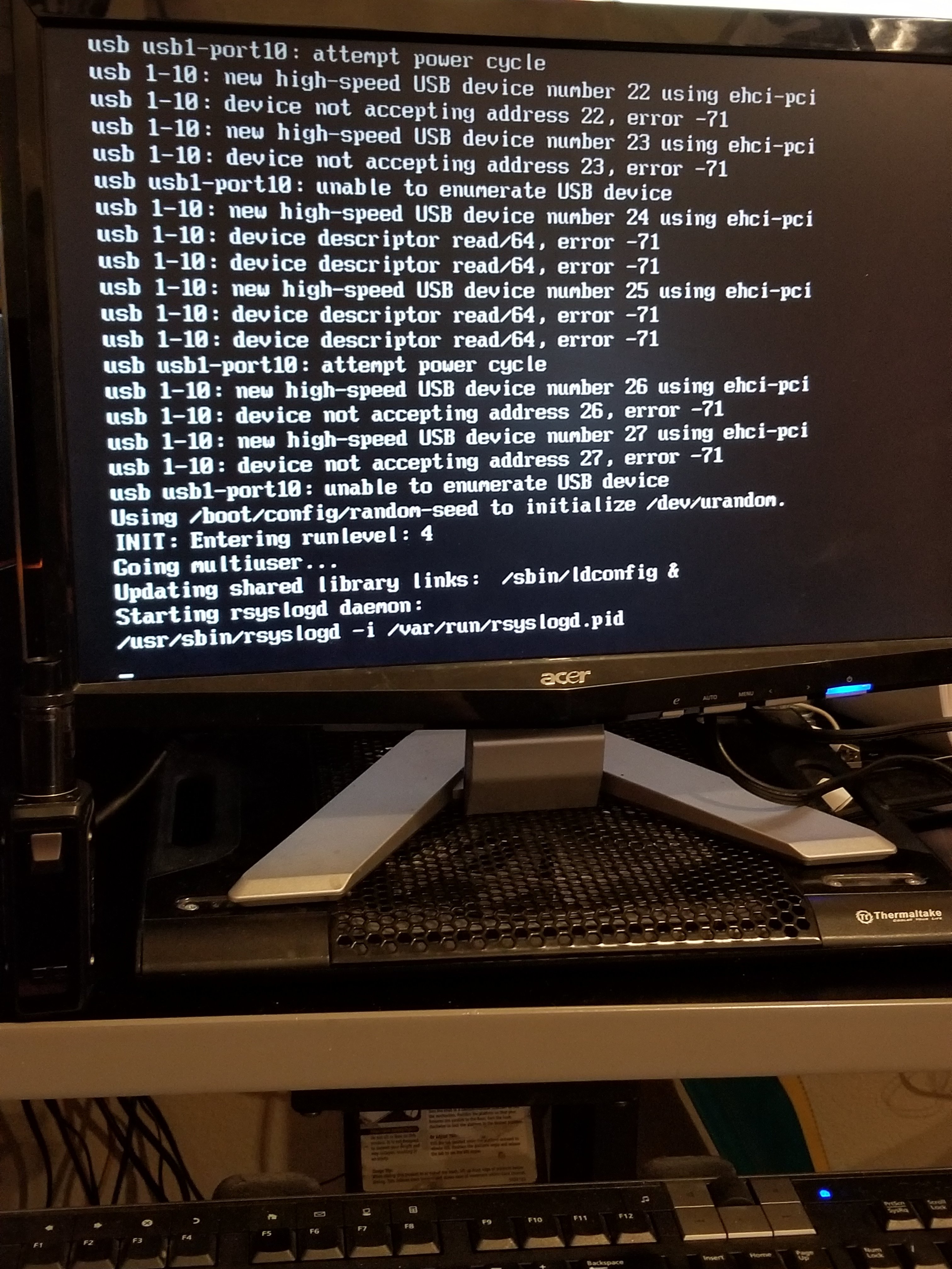

I am attaching the contents of the flash drive (click on link) as I see nothing that tells me why its not working. In the meantime, I can still run the server using 6.3.5.
When I boot up on the 6.5 version the first time, it works, subsequent boots fail and lock up at the same spot every time.
/usr/sbin/rsyslogd -i /var/run/rsyslogd.pid
(see attached pic)
I get the same exact failure on 6.4 and 6.4.1.

There's no information from which to attempt a diagnosis, other than what looks like a faulty USB device. Have you tried your USB boot flash in all available sockets? You might want to try unRAID 6.5.1-rc3 instead of 6.5.
I have, and as I mentioned, it works fine in 6.3.5.
I am not sure what other information I can gather as it seems the the logs are blanks at this point in the boot sequence. Is there a way or place to find the rest of the output to the screen for the rest of the boot?
It may be important to note that this server only has 2 USB ports. I am not sure where the serer is getting usb1-port10 from, unless its just an override in the boot process to ensure that all possible ports are turned up.
With regards to trying the rc3, is this really advisable since the 6.4 and 6.4.1 also do not work?

So, im going to ask this again. because i haven't seen an answer and cant find one online either.
Is there a way to capture the screen output during the boot sequence?
