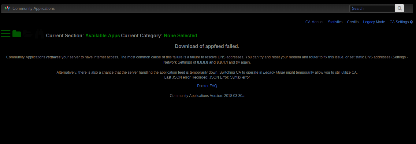

Hi Guys,
Is this the same error(attached image) you guys are getting?
I just updated to 6.5.0, since update CA is not starting up, i also tried setting Static DNS as recommended but in vain.
Kindly suggest solutions.

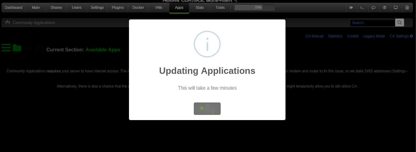

Hi @Squid,
Thanks for your reply.
I tried loading legacy mode, but its still showing status as below, its still loading.
Please advise how to proceed further. Should I abort It?
23 minutes ago, Squid said:
Getting Legacy Mode to work on a slow internet connection (where it takes more than 2 minutes to do its thing) is on the to-do list.  It just doesn't come up very often that legacy mode is even required (but it is there for this eventuality), and combined with a slow internet.
If it takes longer than two minutes, the "Updating" screen will never disappear, but it still does the thing in the background.  Give it say 10 minutes, then just reload the page and you're in business
@Squid
Thanx a lot it worked :)

Trying to troubleshoot a different problem by removing and re-installing plugins, I have a server stuck (in Legacy mode) on "Updating Applications This will take a few minutes".
The more than 2 minute thing (This is an exact time by the way) is a by-product of how unRaid works and CA works.  This has been changed in the next rev of CA which will be released once the appfeed server is operational (so I can verify everything still works).  In the meantime, give it a couple more minutes and then just reload the page.
It's just never been a priority until today, because
  1. I didn't think it would affect a fair amount of users (if any)
  2. We haven't as of yet had an extended server outage, where a ton of people bored on Easter Sunday would be playing with their server's all at the same time.
Edited by Squid
Sorry, I missed that bit, as did others, it seems.

when i click legacy mode, i get a pop up that says 'switch to legacy mode?' I can 'update lists' or 'cancel'...when i click update lists, it says its updating applications, this will take a few mins.....i let it do its thing,  but after a couple minutes the message disappears and i still cant access the CA.  If i refresh the screen, i just go through the entire process again...
Im sure im missing something very basic, Im not the most advanced unraid user.
unraid 6.3.5
any ideas? just trying to get a sabnzbd docker installed....
