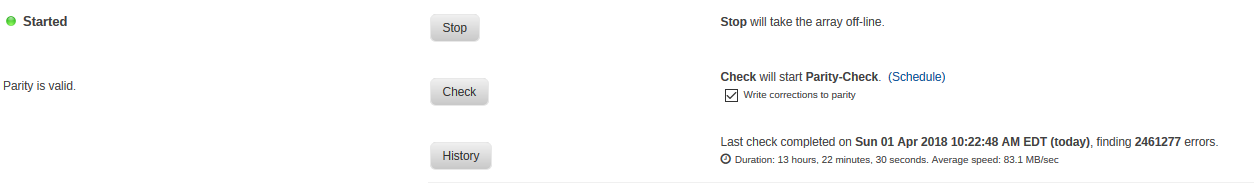

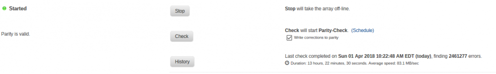

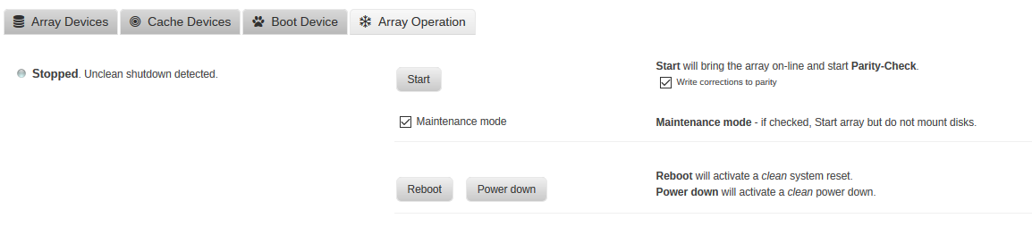

After trying to run xfs_repair w/o -n and ultimately with -L those errors stay, so I restarted the array and let it run a parity check through the night.  It found 2.4 million errors. and when I just took the array offline (stopped, restarted in maintenance mode to get the errors above) it told me I had an unclean shutdown and needed another parity check.
I'm attaching some screen shots, and a diagnostics report from just now after the parity.

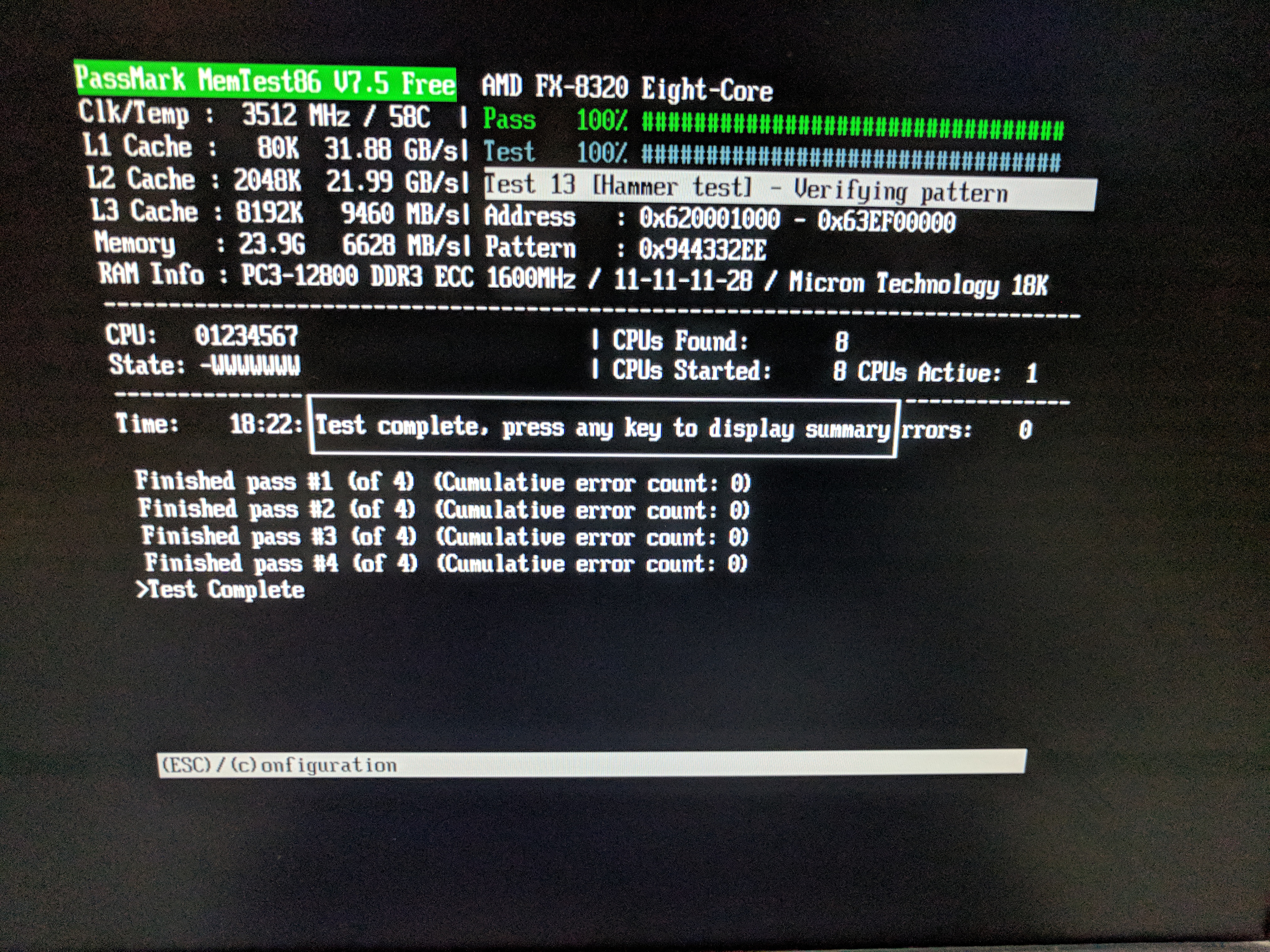

Corrupt cache filesystem and parity sync errors to me suggest a hardware problem, I would start by running memtest for a few hours, ideally 24
So, I cleaned up the cache drive, formatted it clean and deleted the libvirt image and started fresh.  Started installing windows again fresh.  While trying to install a service pack I see this pop up in the logs.  No indication there  were any issues until just now. (no errors in log)
I shut everything down, and reseated the ram, and am running memtest86 on it.  We'll see what happens I guess.  MB/Build is from 9/2014

So, as an update. I let memtest run 4 tests (about 19 hours) and it found no errors.  I've decided to try going back to my previous build of unRAID (6.3.5) (did a full restore of the zip I took before upgrading).  Put my app drive and cache spinner back in, and rebooted.
I copied off the date from the app drive, cleaned it up by reformatting it, then moved my VM/Dockers back on.  Things seem back up, and no errors in the log(yet).  I'm about 20% through a parity check now.  Once that completes I'll try some tests load tests within the VM to see if the problem returns.
I'm starting to wonder if it's a 6.5.0 issues, but time will tell I guess.
