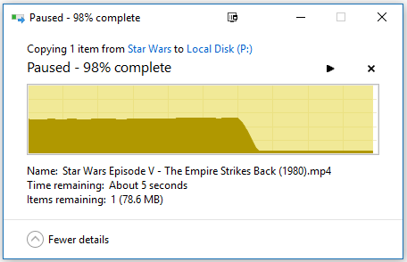

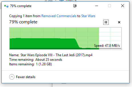

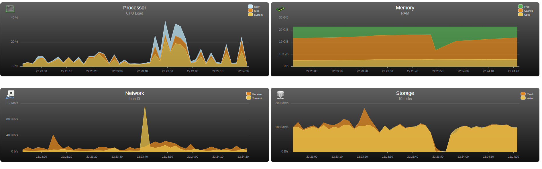

Yes that is right 32 gb or ram and the 850 evo is actually 500 gb.  (About 400 free)  Yes this share is using the cache disk.  I verified that.  When I go from Unraid to Windows this is what it looked like.  The windows was not using the ram disk in this instance but it seems like I get the same thing either way.  My Windows PC only has 16 GB or ram in it if that matters.
