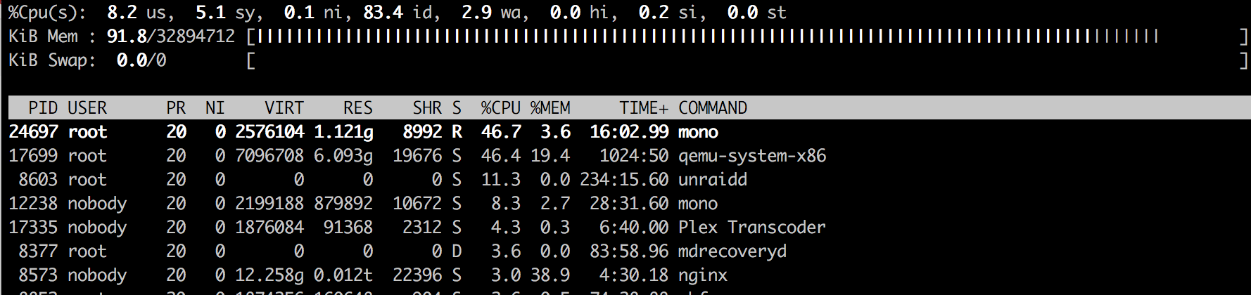

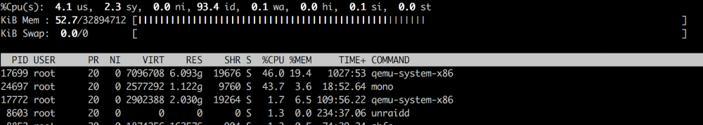

Any ideas how to figure out the cause of this spike in memory usage?
ngnix shouldn't be using close to 40%...
^^^the last line, nginx..
Restart nginx and memory usage drops.
