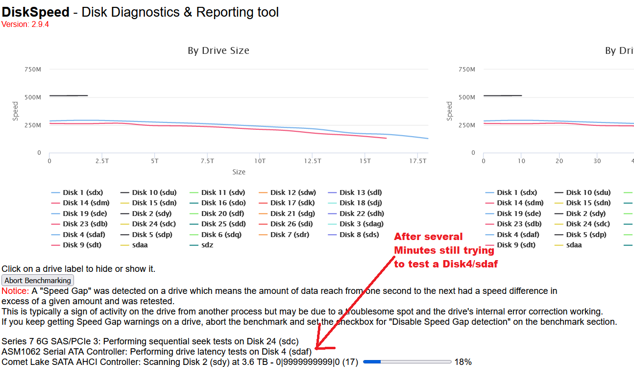

Thank you. I did so on my 1st unraid machine.
And I am surprised.
Diskspeed tries to test/bench a Device Disk4 sdaf  on the ASM1062 controller (and seems to be stuck at it).
I can't figure out which device it is. When I look in the main tab and search for an sdaf   I can't find any.
Even at the "Tools/System Devices" I can't find a Disk4 sdaf on my only ASM 1062 controller.
It seems diskspeed does not use the same naming  like unraid in the Main tab or in the Tools/System Devices Section.
Tools/System Devices:

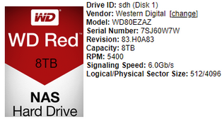

I should add that according to the manual for the mobo, this slot is suposed to be PCIe v.2  (PCI Express 2.0 x16 Slot (PCIE5 @ x4 mode) which seems different with what Diskspeed is reporting.
and I get the following error (the error appears when the "Benchmarking Parity (sdp)" bar reaches 100%).. What could be causing it?

I'm having some strange behavior on one drive where the first 80% or so is just flat then it starts to drop down.
Disk 1 threw a "Bandwidth was capped on drive" but I'm not sure how to remedy the situation.
Disks 13 and 15 showed the most wobble on the chart, maybe those are to be replaced next?
Graph strongly suggests disk is linking @ SATA1 (150MB/s), SMART report will confirm.
@jbartlettIMHO it would be more useful to instead of showing the device max linking speed show the actual linking speed, or both.
Here is what I pulled from that drive's SMART report.
It does show: SATA Version is:  SATA 3.2, 6.0 Gb/s (current: 1.5 Gb/s)
Any idea how that could be? I've got all my drives on a SAS2008 PCI-Express Fusion-MPT SAS-2, with a 24Bay SAS backplane.
WDC_WD80EZAZ-11TDBA0_7SJ60W7W-20220629-1111.txt
Your WD80EFZX shows a normal curve line on the HDDB Heatmap but there have been others that show a wave something like yours. But the way yours vary from it's previous scan and what others have gotten has me doubting the good health of the drive. Personally, I'd replace it.
Try a different slot.

On 6/29/2022 at 1:44 PM, FlyAg said:
I'm going to double check the cabling on that slot and also try a different slot. I'm glad I found this tool because I don't think I would have ever detected this otherwise!
I believe that backplane I had was faulty. I had to get a new backplane anyway and now everything works well
