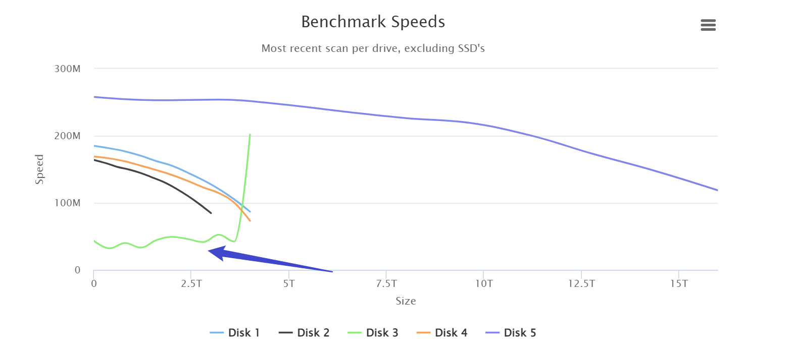

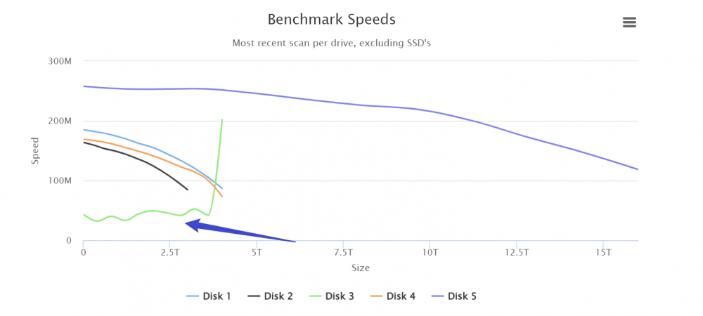

image.thumb.png.48ee2a97581715a775da4c8e3b493551.pngHey guys, does this curve mean my drive is going to die soon?
Have you looked at SMART report?
What's the drive manufacturer & model?
