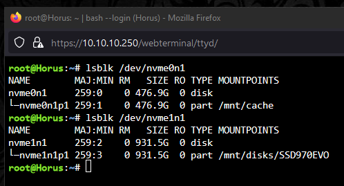

Please open a command shell to your unraid box or the DiskSpeed app and enter the following commands and reply with the result:
lsblk /dev/nvme0n1
lsblk /dev/nvme1n1
Look at this
FYI: None of this three mentioned conditions are true...
.) Drive not mounted - No - alle drives are mounted
.) Less the 25GB free - No - 467GB/585GB free
.) Part of a pool - No
So there must be some other error 🤣

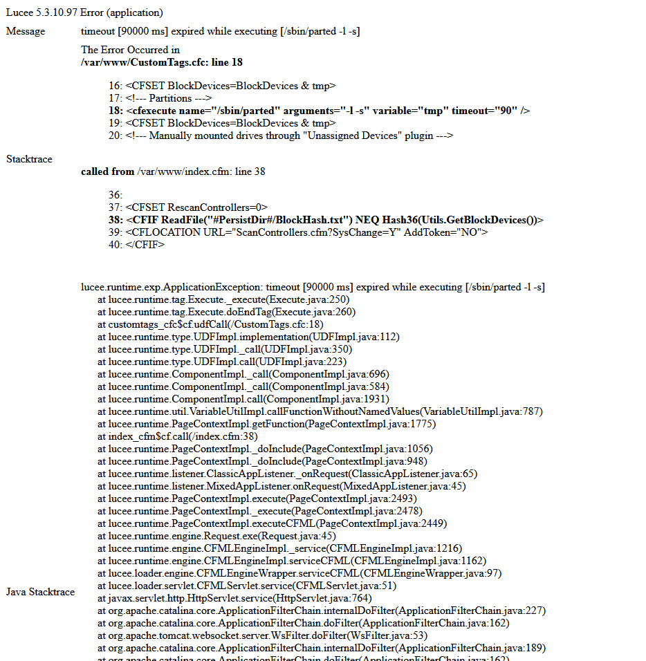

Getting an error starting DiskSpeed GUI. Its been a little bit since I've run it, so not sure if this is an issue since upgrading to 6.11.5 or with a new drive model I have installed, Toshiba MG04SCA60EA.
DiskSpeed ERROR.txt
That drive has an interesting block size of either 4,096 / 4,160 / 4,224 bytes.
Please update the Docker DiskSpeed settings to pull from repository "jbartlett777/diskspeed:2.10a" - this version has more robust logging plus additional error trapping added. It should allow you to get past that point (but may error elsewhere) and will display a link at the bottom to create a debug file if it successfully finishes. However, prior to doing so, please click on the DiskSpeed icon in Unraid and select "Console" and then enter the following command: cp /tmp/DiskSpeedTmp/spinup.sh /tmp/DiskSpeed/spinup.sh
If it errors again, update the URL to replace "/ScanControllers.cfm" with "/isolated/CreateDebugInfo.cfm?Back=1"
When creating the debug file, please select the middle option for missing controllers or drives.

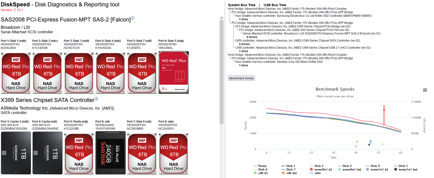

I ran the diskspeed without issue, which displayed a nice webview of the results. Accidentally I closed the browser and could not get to display again. Even looked in my history. Is there a way to display the results from previous tests using the browser to view them?
Thanks
Thanks
If you are running DiskSpeed via UNRAID, click on the Docker tab and then click on the DiskSpeed icon. Select "WebUI".
For other installations, use the given IP of the machine running Docker with port 18888.
Examples:
http://localhost:18888/
http://192.168.1.2:18888/

I installed DiskSpeed today. All harddiks in the array are benchmarked OK. But for my SSD (cache configured in RAID1) and my unassigned NVME (formatted and has already used as dedicated VM drive with unassigned plugin) disk, it refused to benchmark:
Unable to benchmark for the following reason
* No mounted partitions were found.
You will need to restart the DiskSpeed docker after making changes to mounted drives for changes to take effect.
I guess it is a common problem.
I'm also getting this issue.  I recently added 4 500GB nvme drives, with a total of 8 nvme drives. the first four used to bench, now none of them do.
I sent the debug file in email. I moved the docker back to 2.10.1 and DiskSpeed was able to start and found all my drives. However I can't benchmark any drives;

Version: 2.9.7.1
Scanning Hardware
08:09:48 Spinning up hard drives
Lucee 5.3.9.166 Error (application)
MessageError invoking external process
6 hours ago, jsmontague said:
I am still unable to spin up drives on any version below 2.10.1.
Version: 2.9.7.1
Scanning Hardware
Version 2.10.1 has error trapping added around calling the Spinup function. It's probably still happening, but it ignores the spinup issue and keeps moving forward.

Here's how it looks on my system
Edited by jbartlett
Thanks. I wanted to start from scratch so I purged and doing a scan now.
