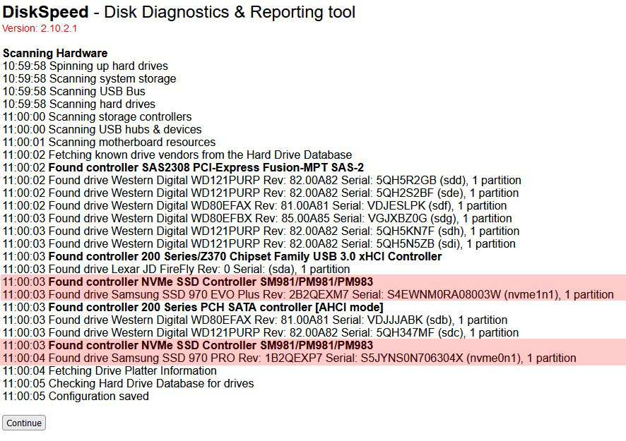

@d3m3zs@jsmontague@Zonediver@emb531@youngfish@deepinder27@mayberts
Please update DiskSpeed to 2.10.2. I found an issue with detecting partitions on nvme drives and added additional error trapping with logging during the scan process. If you continue to have any issues, please create a new Debug File from inside the app or by using:
http://[IP]:18888/isolated/CreateDebugInfo.cfm
The new debug file will also contain a html file of the hardware scan so I'll be able to see exactly what you saw if there was an issue during the scan process.

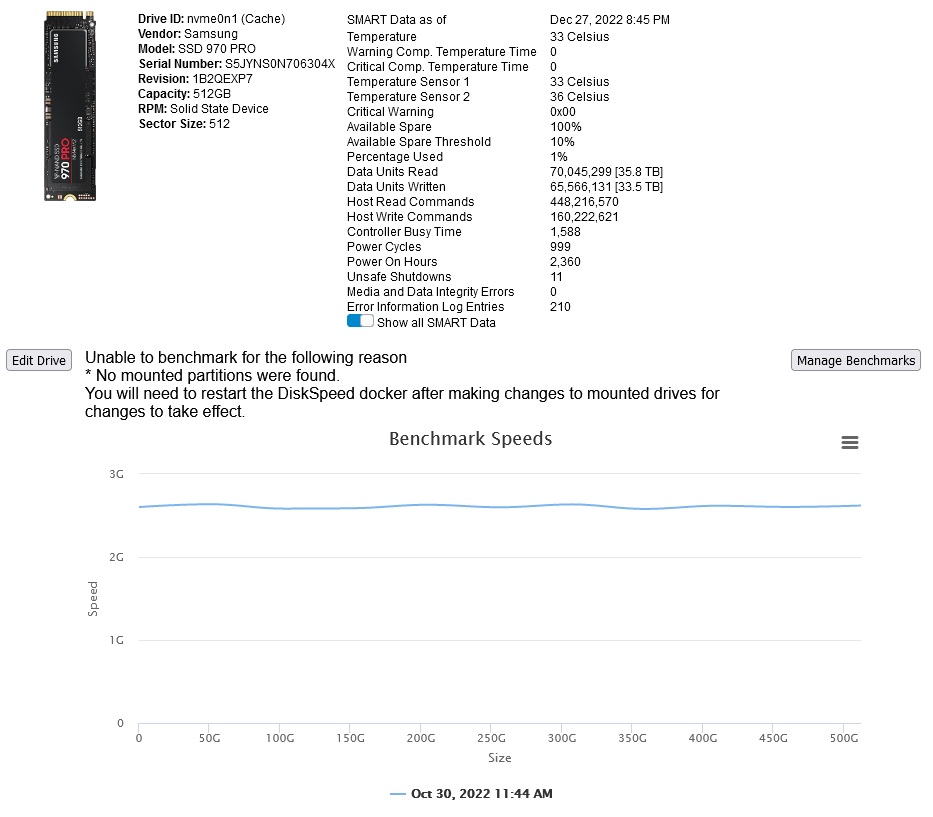

Keep in mind that SSD's and NVME drives can't be benchmarked if they are not operating as solitary drives - that means no RAID, multi-pool BTRFS setups, etc. If you want to benchmark such drives, it has to be done prior to adding them to a multi-drive setup.
@d3m3zs - the debug file you sent didn't include the hardware info on the MAIWO KT015 adapter so I went ahead and ordered one and a couple very cheap drives to go with it (SSD+NVMe). This one has me a little perplexed, it looks like it has a nvme port and a separate sata port - to date, the only nvme devices I've seen have their own built in controller. I'm wondering if the card provides a SATA port for one drive and a passthrough for the nvme.... It's interesting enough I want one for my collection and the price is good too.
...still the same problem... (thats my cache-SSD)
Unable to benchmark for the following reason
* No mounted partitions were found.
You will need to restart the DiskSpeed docker after making changes to mounted drives for changes to take effect.

5 hours ago, d3m3zs said:
Hi! Thank you! Unfortunately, nothing changes, I can send a letter in few hours with debug log.
DiskSpeed - Disk Diagnostics & Reporting tool
Version: 2.10.2
Scanning Hardware
14:47:19 Spinning up hard drives
14:47:19 Scanning system storage
14:47:19 Scanning USB Bus
14:47:20 Scanning hard drives
14:47:20 Scanning storage controllers
14:47:20 Scanning USB hubs & devices
14:47:20 Drive sda was added to the Host after this DiskSpeed Docker was started (restart if so) or is an empty card reader.
14:47:20 Drive sdb was added to the Host after this DiskSpeed Docker was started (restart if so) or is an empty card reader.
14:47:20 Drive sdc was added to the Host after this DiskSpeed Docker was started (restart if so) or is an empty card reader.
14:47:20 Drive sdd was added to the Host after this DiskSpeed Docker was started (restart if so) or is an empty card reader.
14:47:20 Drive sde was added to the Host after this DiskSpeed Docker was started (restart if so) or is an empty card reader.
14:47:20 Scanning motherboard resources

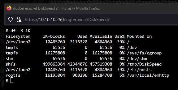

For those who are getting the Unable to benchmark, please open a command shell into the docker via the Docker icon for DiskSpeed or entering "docker exec -it DiskSpeed bash", then enter the following command.
df -B 1K
On my system, I see the following:
root@86294dbd858a:/usr/local/tomcat# df -B 1K
Filesystem       1K-blocks       Used   Available Use% Mounted on
/dev/loop2        20971520    2051948    16950884  11% /
tmpfs                65536          0       65536   0% /dev
tmpfs             16403820          0    16403820   0% /sys/fs/cgroup
shm                  65536          0       65536   0% /dev/shm
shfs             250058072  182053732    66697420  74% /tmp/DiskSpeed
rootfs            16321016    1005828    15315188   7% /mnt/UNRAID
tmpfs                 1024          0        1024   0% /mnt/UNRAID/disks
tmpfs                 1024          0        1024   0% /mnt/UNRAID/remotes
tmpfs                 1024          0        1024   0% /mnt/UNRAID/rootshare
/dev/md1        9766436812       3872  9764322240   1% /mnt/UNRAID/disk1
/dev/md2        7814026532 4864992872  2948204344  63% /mnt/UNRAID/disk2
/dev/md3        7814026532 3530133468  4284356260  46% /mnt/UNRAID/disk3
/dev/nvme0n1p1   250058072  182053732    66697420  74% /mnt/UNRAID/cache
shfs           25394489876 8395130212 16996882844  34% /mnt/UNRAID/user0
/dev/loop2        20971520    2051948    16950884  11% /etc/hosts
My nvmeon1p1 partition for my cache drive is listed showing the mount point to be "/mnt/UNRAID/cache" (note that inside the docker, your expected mount points will include "UNRAID").
I'm betting that if you can't benchmark your nvme drive, you're not seeing it listed in this list. One of the checks is for amount of free space and it gets that from this df command. If it can't find an entry, it assume it's not mounted even though it found it's mount point. This also means I need to find an alternate method.
Edited by jbartlett

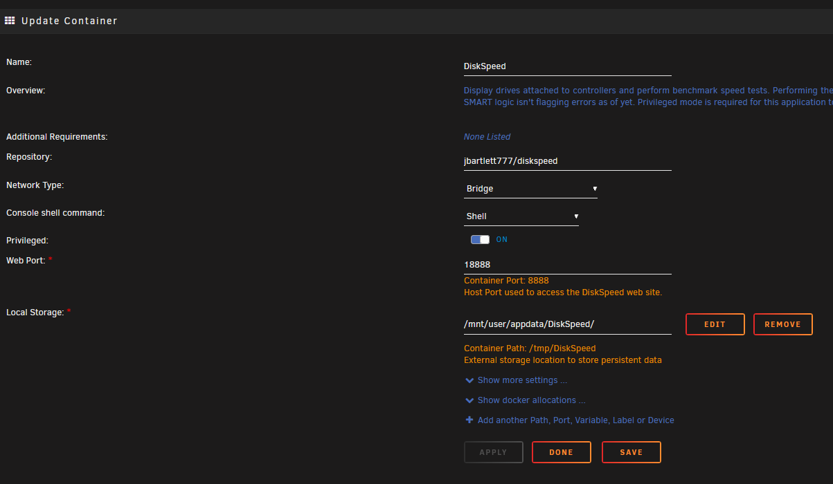

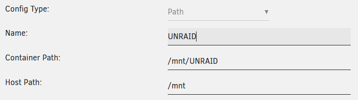

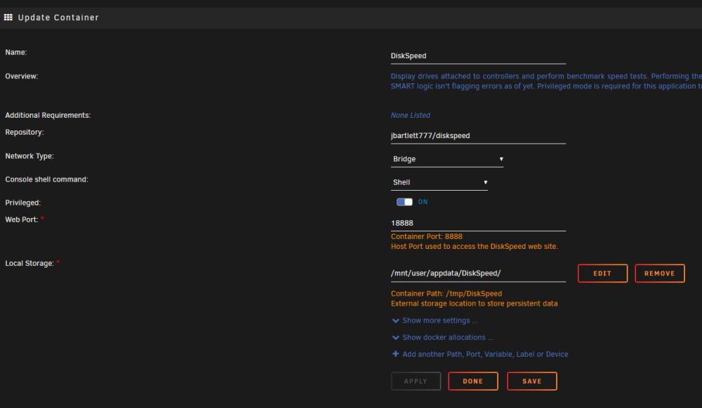

Question - can you check your DiskSpeed docker settings for this path?
...hmmm... dont have this settings...
