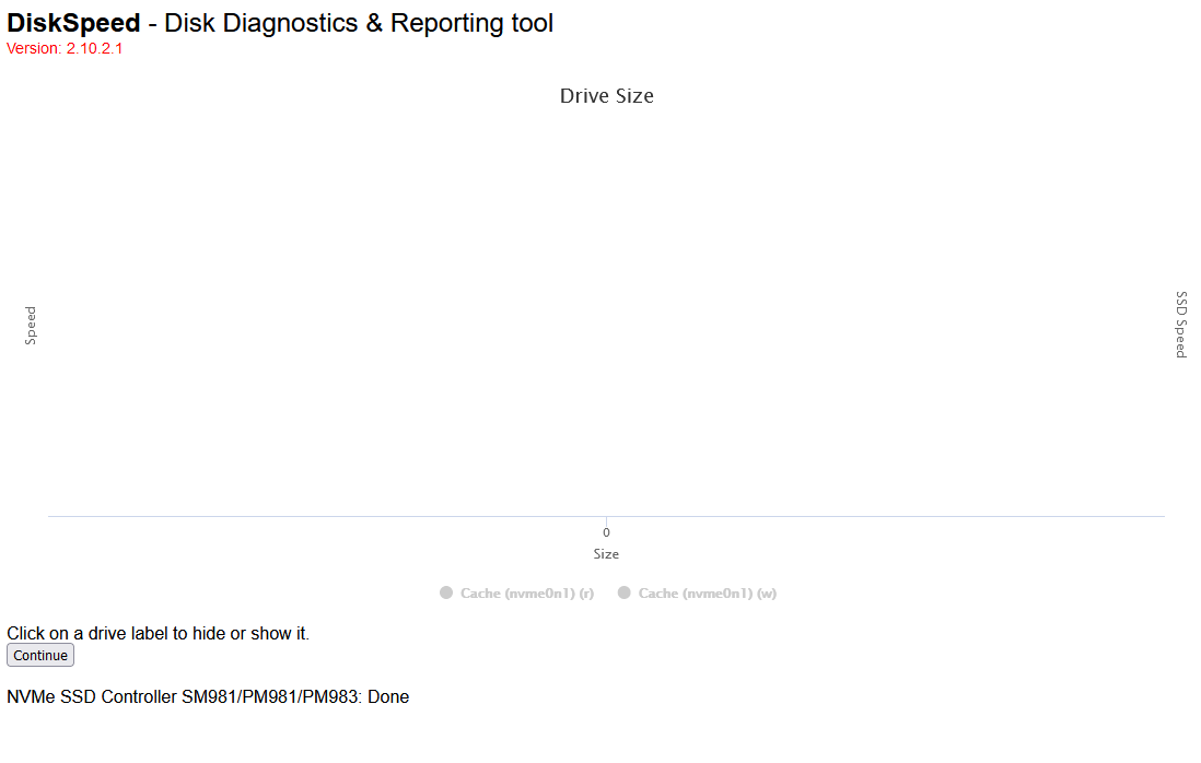

1 hour ago, jbartlett said:
Please add it and see if you can benchmark your nvme drives.
What shall i add and were? I am not a Docker-Expert...
Edited by Zonediver

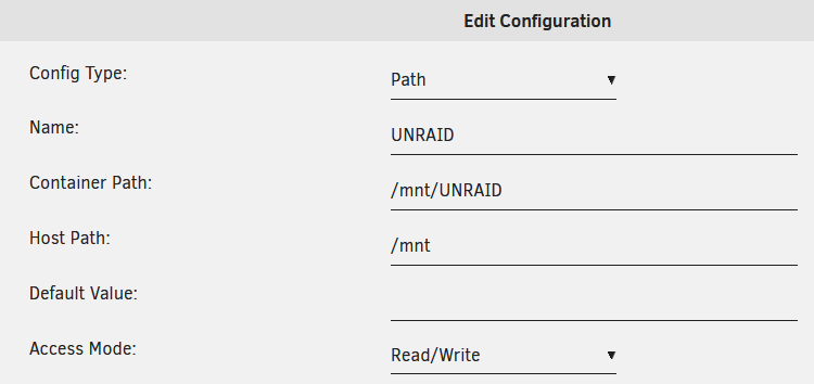

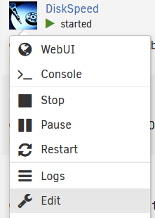

Click on the icon as if you were going to launch the app but instead click "Edit"
At the bottom of the page, click on
Set to the following:
Note on Access Mode: Since the docker app runs in Privileged mode, it doesn't matter if it's Read Only or Read/Write, but might as well select Read/Write as future enhancements to allow the app to run outside of Privileged mode will require this.
Save the new setting, then click on the "Apply" button for the Docker (not the Save button).
Then launch DiskSpeed as per normal.
This did the trick - thanks for your detailed help.

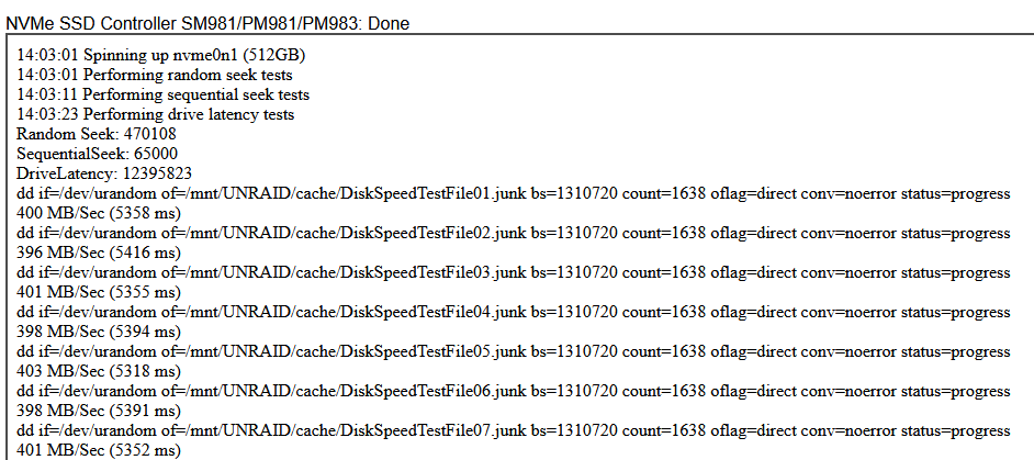

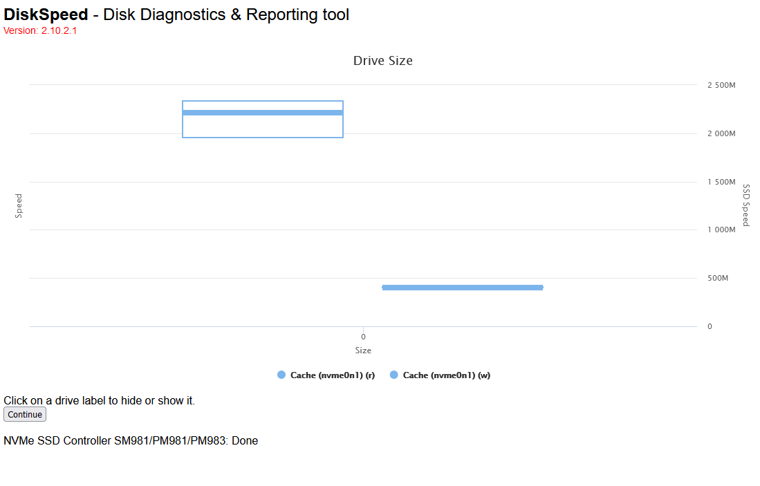

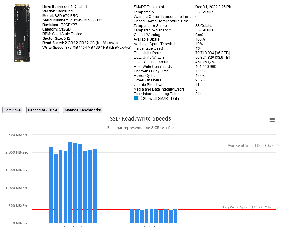

EDIT: There is something strange at the write-speeds...
The Samsung SSD 970 PRO is far more faster then 397MB/s.
When i transfere data over my 10GBit NIC, i reach up to 1189MB/s constantly...
The constant write speed of this SSD is 2300MB/s.
Edited by Zonediver
I was able to get one of my TOSHIBA drives to finally benchmark in the tool, not sure whats different, changed etc, only 1 of them would load into the benchmarking screen, all the rest are still unable to. However it hangs at "trimming drive". Should it be trying to trim a spinning disk drive?
The question is now: Why was this Docker installed at the other path?
And why did it work before?
I installed it over the Apps-function - so i did not set this path - the install-process did this...
One thing to keep in mind is that when you're copying files, it takes advantage of both system and device cache and DiskSpeed specifically requests that "dd" to not utilize any system caches - though that doesn't mean the device has to honor the request.
The 970 Pro is supposed to get 2.700 MB/S on write so something's strange going on. View the drive and click the Benchmark button. While it's benchmarking, look at the "Click on a drive label to hide or show it." line under the graph and click just to the right of the period at the end - this will toggle the visibility of the hidden iframes doing the actual work. When it's writing the files, take note of lines like this and reply with what you got.
dd if=/dev/urandom of=/mnt/UNRAID/cache/DiskSpeedTestFile01.junk bs=131072 count=16384 oflag=direct conv=noerror status=progress
231 MB/Sec (9260 ms)

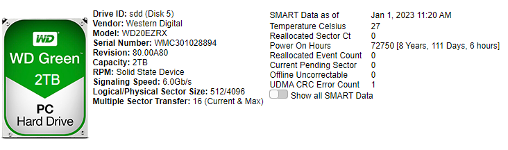

Just following on though, this is something I don't think I have seen before when running diskspeed:
The drive is an old 2TB platter type, is it correct that it is trimming? Also it looks to be stuck on 0%. This drive has not benchmarked, either.
Edit: this drive seems to be getting detected as a SSD...
Edited by anthropoidape

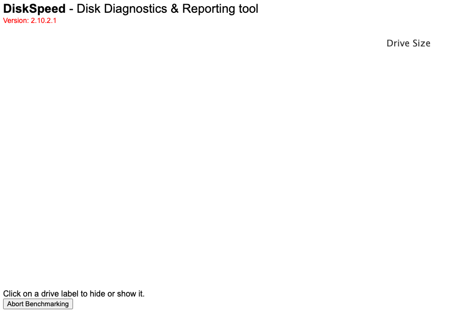

...there is nothing to "click"... just hide or show (r/w) - but no further infos there...
Edited by Zonediver
It's the "nothing" you click on. :) - in this orange area just to the right of the period. Your mouse pointer should still be in the text highlight pointer and not a mouse pointer (on Windows)
image.png.a1b6d826cd359196f5dba6d31e833b06.png <= Click in orange area
Well... maybe i am too sily, but there is no "orange area"... nowere... sorry
EDIT: Now i got it 🤣
These are the values of my SSD 970 Pro from Samsung:
Edited by Zonediver

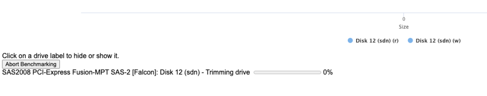

10:23:16 Spinning up sdu (6TB)
10:23:16 Performing random seek tests
10:23:26 Performing sequential seek tests
10:23:38 Performing drive latency tests
Random Seek: 101
SequentialSeek: 155
DriveLatency: 8229412
Lucee 5.3.10.97 Error (application)
Message	Error invoking external process
Detail	fstrim: /mnt/UNRAID/disk14: the discard operation is not supported
Stacktrace	The Error Occurred in
/var/www/BenchmarkDriveController.cfm: line 131
129:
130: <CFFILE action="write" file="#OutDir#/trim.sh" mode="766" output="fstrim #MountPoint#" addnewline="NO">
131: <CFEXECUTE name="#OutDir#/trim.sh" timeout="3060" />
132: <CFSET WriteSpeedList="">
133: <CFLOOP index="i" from="1" to="#SSDBenchmarkTestFiles#">
Was able to get one to benchmark and this is the output as it gets stuck at trimming.

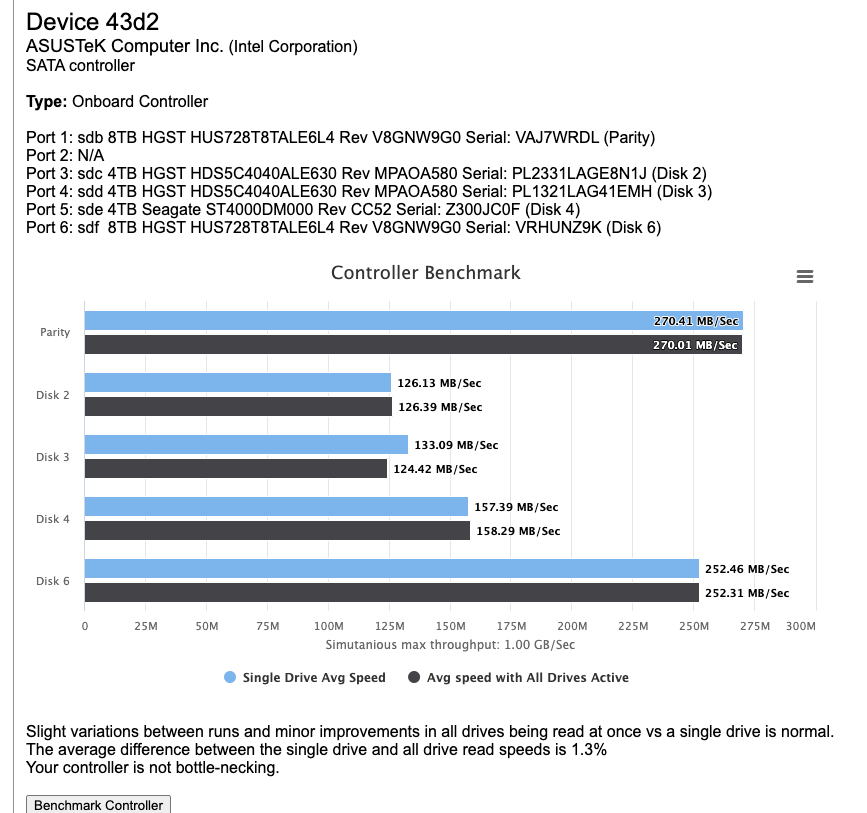

One more thing - when I benchmark the controller, it does include the drives that it won't benchmark when I benchmark the disks...

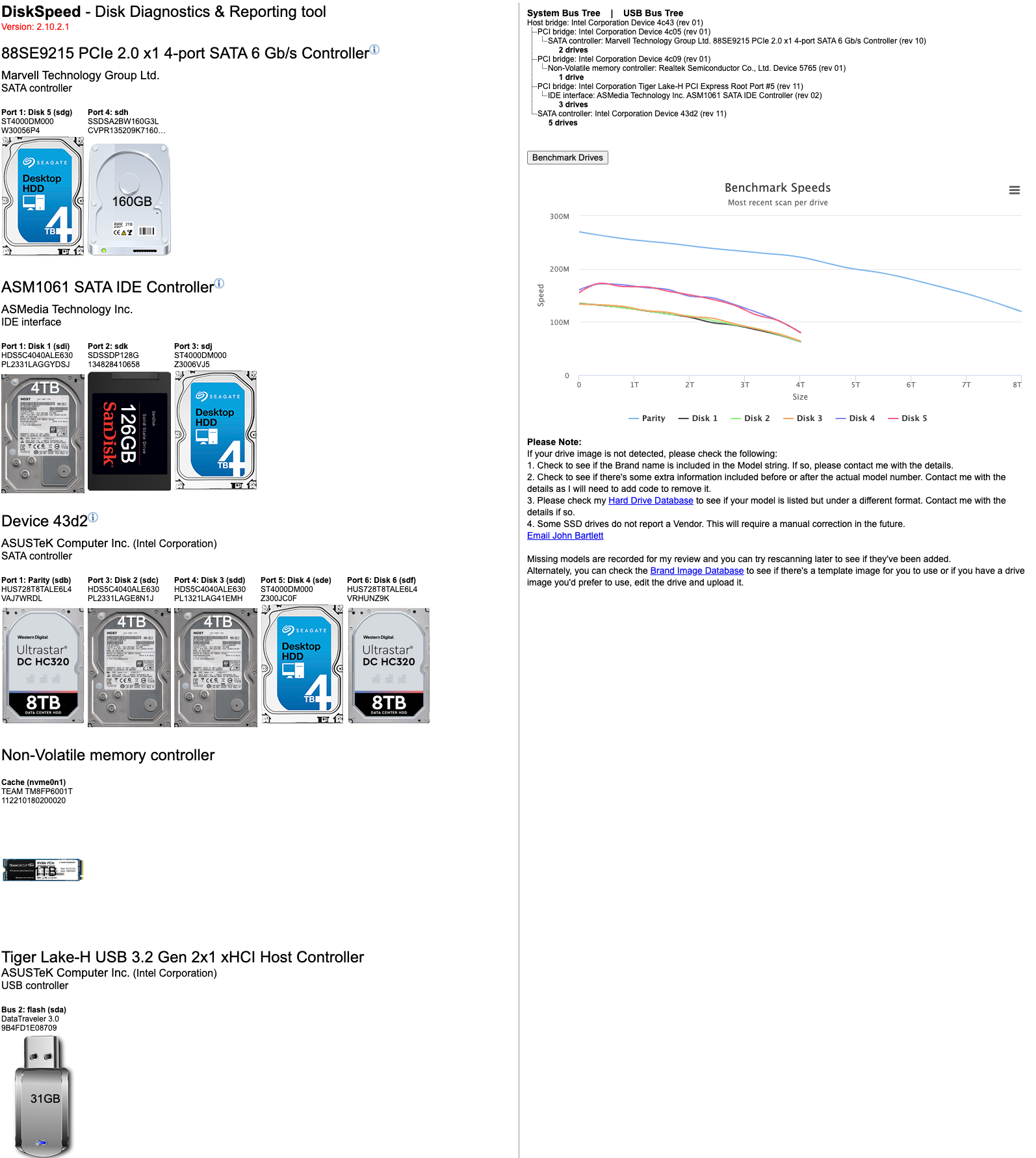

@ToastinJam - You can select a 1% test range from the "Benchmark Drives" button on the main page. Clicking the banner will take you there.
@GrahamTWatson - The benchmark graph on the main page only displays drives you've done benchmarks on. If you've purged the settings, it erases past benchmarks too though you can recover them if you uploaded your benchmark data. To do so, click on any drive and click the Maintain Benchmark button - though you have to have at least one benchmark already stored for it to display.

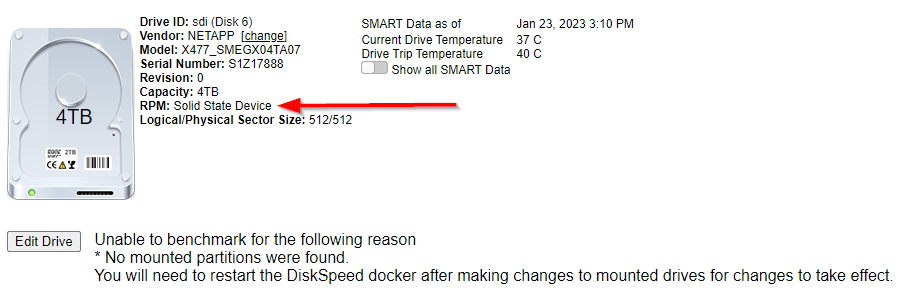

On 1/1/2023 at 3:30 AM, mayberts said:
So I can benchmark my xfs nvme array now, thank you. I'm currious as to why I can no longer benchmark my btrfs nvme's?  I can on diskspeed version :2.9.7
Same.
BTRFS NVME solo drive with a single VM on it says:
"Unable to benchmark for the following reason
* No mounted partitions were found.
You will need to restart the DiskSpeed docker after making changes to mounted drives for changes to take effect."
Been working with it all day so I know it has a fs. :)

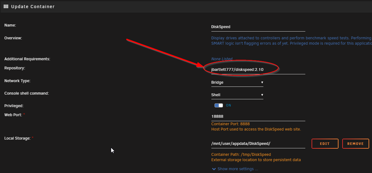

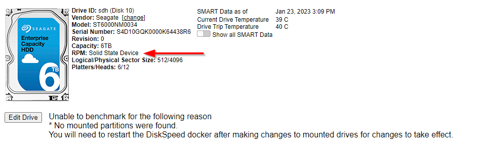

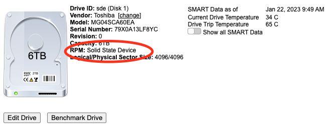

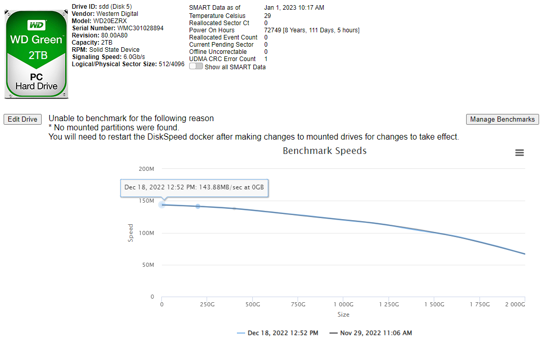

@jbartlett I still am unable to benchmark these drives as the tool thinks they are SSDs and tries to trim them.
Unfortunately, it seems recently some HDD models get recognized as SSD and I'm unable to bench them...
Guys for anyone having the issue of some HDD models recognized as SSD, I found a temporary fix: rollback to version 2.10.
How to do that? Just edit the docker settings and set this field as follows:
if the issue still persists, just remove the docker, delete the following folder "/mnt/user/appdata/DiskSpeed/" or wherever you've saved the app data of this docker, then when you reinstall the docker, set the repository field as "jbartlett777/diskspeed:2.10".
In the future, when the bug will be fixed you'll just have to edit the docker again and set the repository to pull the latest version as follows: "jbartlett777/diskspeed".
Hope this will help! ;)
Thanks @endystrike. I went back to 2.10 and was able to run benchmark on drives individually. When I try and benchmark all drives at once, I check the box to ignore speed gaps yet during the benchmarking it gets hung up.1876382791_Screenshot2023-01-26at8_33_03AM.thumb.png.62785b2da51d5562a71626d305b788d2.png
