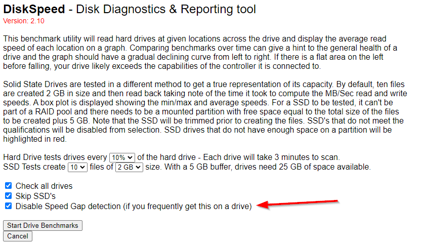

I have that checked already.
try disabling other dockers, sut down VMs, ensure mover is not running and make sure you're not accessing the drives from elsewhere during the benchmark...
This is the main reason why speed gap detection occurs.
By the way, I still get that alert but with that box flagged, the test continues anyway.

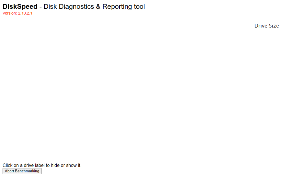

When I start the drive benchmarking, I'm getting a blank screen! Thinking it may be a browser issue, I've used FireFox and Edge. This is on a Dell T320 with an H710 flashed to IT mode. I've got eight very old drives, with Preclear flagging a drive as being slower than the others. Please let me know how to troubleshoot. This is my second go at an UnRAID box, but I still think of myself as a newbie.
And, now it shows, so nevermind...
This is how it looks when the Highcharts graph encountered an error launching. Viewing the browser Console might give hints. In Firefox/Chrome, right-click on a blank area and select "Inspect", then click in the Console tab.
Looks like that's what's happening in my case above (not sure why it worked for a time):
