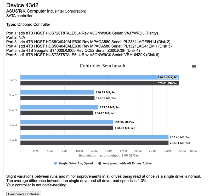

1 hour ago, 4554551n said:
Is it possible to have all disks get tested at once, instead of one after the other?
See the controller tests, look like this:

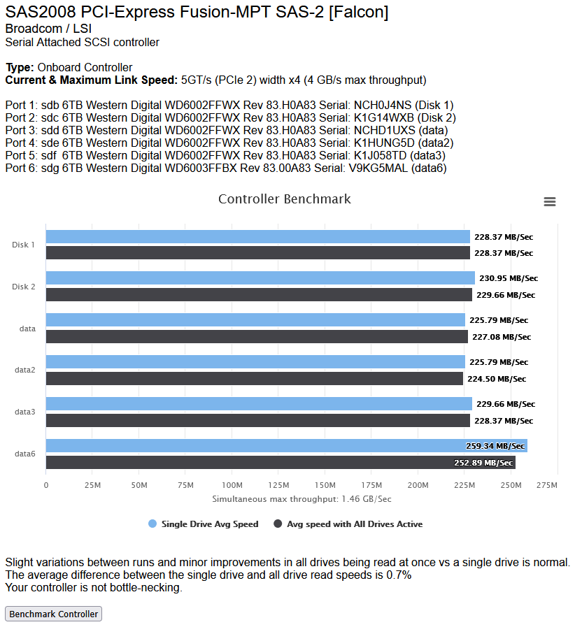

This is great, thank you. I just downgraded to a pcie 3 x1 port for the controller SAS2008 PCI-Express Fusion-MPT SAS-2 [Falcon] so I could slot in a second GPU. So I expected it to be pretty bad, but not quite that bad.
It's telling me my simultaneous max throughput is 655.36 MB/Sec, shouldn't it be 1GB? As per the half duplex of the v3 x1 slot?
SAS2008 is PCIe 2.0, so with a x1 slot it would be limited to <500MB/s.
That's a good catch, thank you.
Price I pay for 2 GPU I suppose.
So then if it should be <500, why am I seeing 655?
You shouldn't, post the diags and the test result.
I would like to use this to test a RAID card in a pci slot, to see if it's bottle necking the drives when multiple are used at once.
You can do this by clicking on the image.png.1e5d0b7bcfcc1ee5ef6caf110f19ec48.png icon next to your controller.
Then click on the "Benchmark Controller" button. It will then read all drives attached to the controller for 15 seconds each in sequence, then all of the drives on the controller at the same time for 15 seconds, then display a graph showing both the isolated speed and the speed the drives got when reading all at the same time.

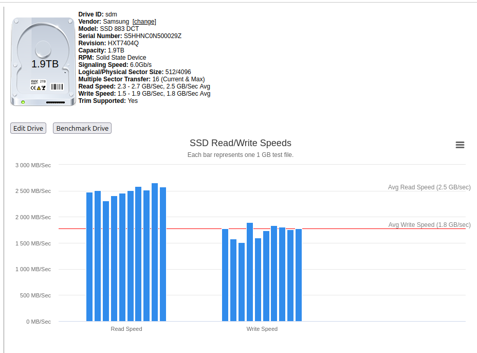

Any idea why i would be getting more than the 550MB/s on a sata ssd?

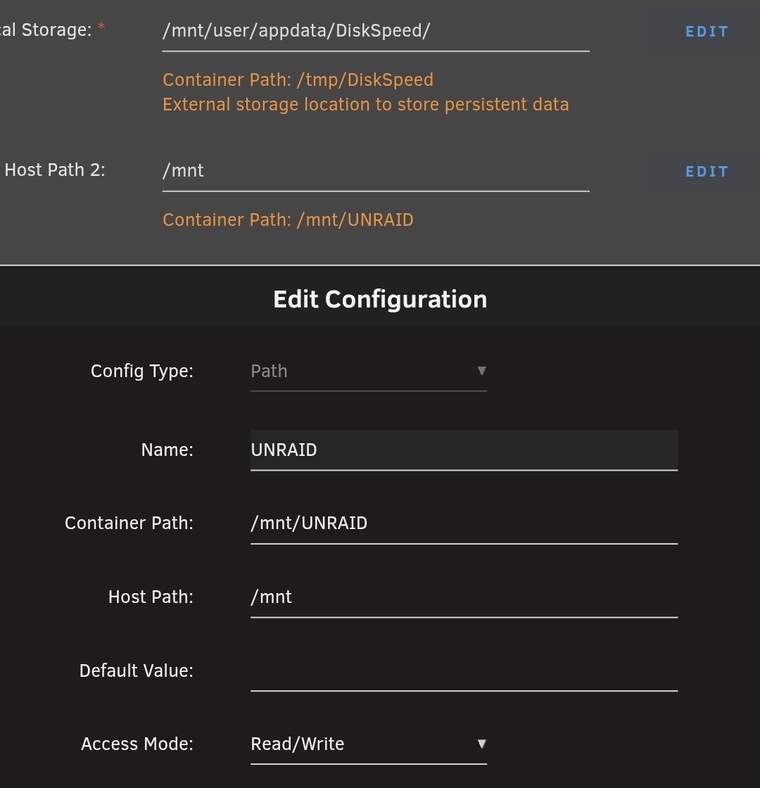

I seem to be having the "Docker volume mount not detected" issue on my NVME drives (image attached).
I have already checked here, and the 'solution' says to add a path to the docker (also image attached).
However while that does trigger a rescan of the drives when booting up diskspeed, the error doesn't change. All four of the NVME drives are still erroring.
I have the exact same situation for my NVME Cache pool, all my drives show up, but say "Docker volume mount not detected"
There's something caching the read/writes and isn't honoring the cache bypass. The program uses FIO to do the benchmarking, try using a larger file size in the benchmark scan.
