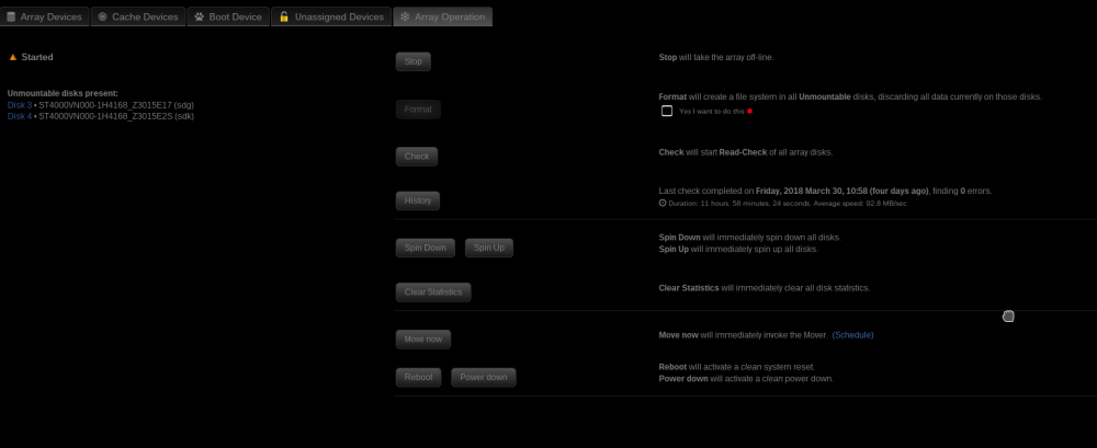

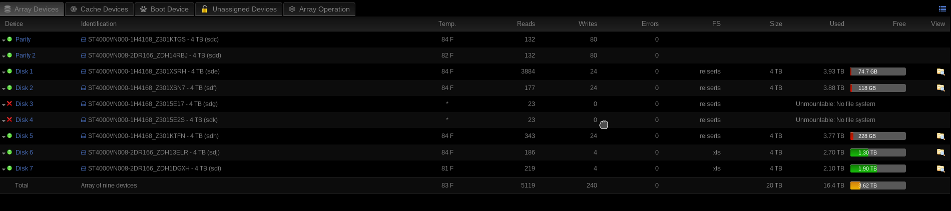

Here is what my array screen looks like.  I swapped all the drives back to the failing internal controller because atleast it's stable when it boots up...It sometimes doesn't reconized drives on boot but when it does it works fine.
Here is another screen shot
What should I do to recover the drives?

Rocketraid use a Marvell chipset and not recommended for unRAID anymore, one of the issues is that they tend to drop disks, and while the diags are after reboot so and can't say for sure, problem was most likely controller related, as to the data doing a new config *should* get both disks back, but before doing that and unless you're sure the filesystem for disk3 and 4 is reiserfs, change it to auto on both disks and try to start the array again, then post new diags.
Wow, I just spent 618$ on this this thing based on it was the only 24 drive controller I found...I didn't see the not recommended anywhere.  I have no idea if I can return it or not...Is there another 24 drive x16 2.0 card out there?  The are reiserfs as these were the first DATA drives I bought for unRAID when I built the system.  I've been thinking of getting another drive and slowly converting them to xfs.  The server has been rebooted dozens of time and I also checked the disks on another computer and they are bland as the day they were bought...I think the non-persistent logs on unRAID is the only down fall of the OS... I have so much trouble diagnosing problems because I usually find out when the server is unresponsive I had a problem.

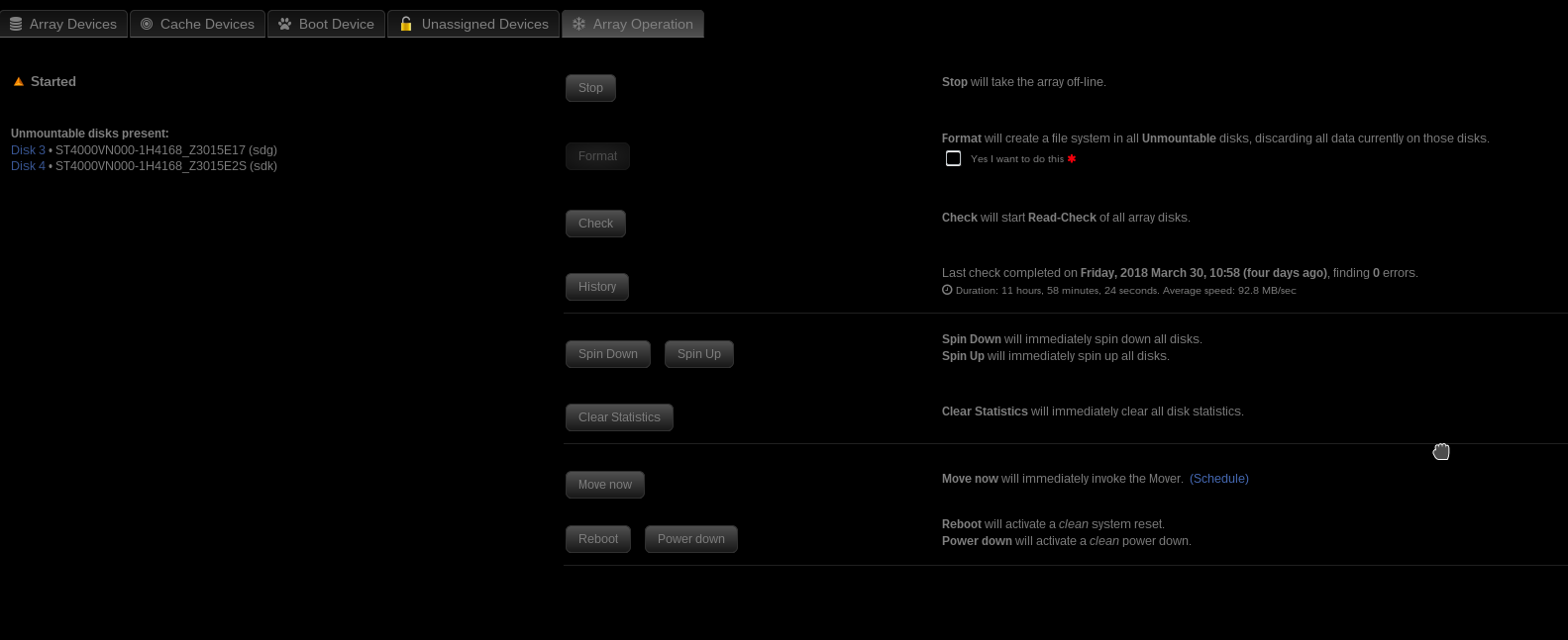

Here is the diags after the array stop and restart

I just noticed...The Data from those 2 disks are all missing.  I know the Parity is good as the last parity check says so.  I thought the data was suppose to be accessible when the disks were disables using the Parity...Unless I'm missing something...

FS is still set to reiserfs on disk3 and 4, and no reiser filesystem is being found, either those disks are not reiser or your parity is invalid.
2 hours ago, Rudder2 said:
What do you mean by new config?
-Tools -> New Config -> Retain current configuration: All -> Apply
-assign any missing disk(s)
check "parity is already valid" before starting the array
-start the array
If disks still unmountable post new diags, if they mount do a parity check.

After doing a new config, and unless something very wrong happened previously, you should get the data from disks 3 and 4 back.

YOU ARE AWESOME!!!!  I decided to trust you and you were right.  There is nothing wrong with the Data on the Disks...They were just disabled!!  THANK YOU!!!!  I will be MUCH more careful when I change critical hardware.  Community will be asked first before ANY upgrade!  Please add the Rocket Raid 2760A as NOT working...It almost made me loose data!!!!
