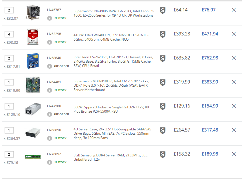

i would like to know if everything on my list is compatible with Unraid i have been watching a few videos on Unraid and thought about buying it for a very long time i am looking at putting a server together to host my Nas Storage and Host A Few virtual machines for some games team-speak and and a website or two and just wanted to know if everything i picked will work well with Unraid so i can go ahead and buy it all
Here is My components so far

Two coolers but one CPU? :)
ill have two 6 cores once i know its all alright :) as i would like to be able to host 2 or more virtual windows server 2012 r2 Machines one for hosting game servers and teamspeak and the other for some websites with IIS
i have no experience with 2U servers and passive CPU coolers - are they moving air with exhaust vents on the back? if so, then they will be very loud if you put some load on your CPUs..
the 2u case has 4 fans installed i am going to run them full speed as this machine will either been in the loft or a room away from everyone i didn't quite know what coolers would fit so went with passive ones
just make sure this server case has specially designed for passive CPU coolers. But, why not to choose 4U server case and use standard heat-sinks with fans?

Following your advice would you say the new Hardware in the image is Better also will Unraid Run with this hardware and be able to use virtualisation host if you know?
i'm on Supermicro X9 generation board, and i don't run unRAID virtualization, but i'm running unRAID VM on top of VMWare ESXi.
according hardware - make sure your CPU cooler fit fine on X10, as on your picture i see it is for X9 boards.. your MB seems to have Narrow ILM..
