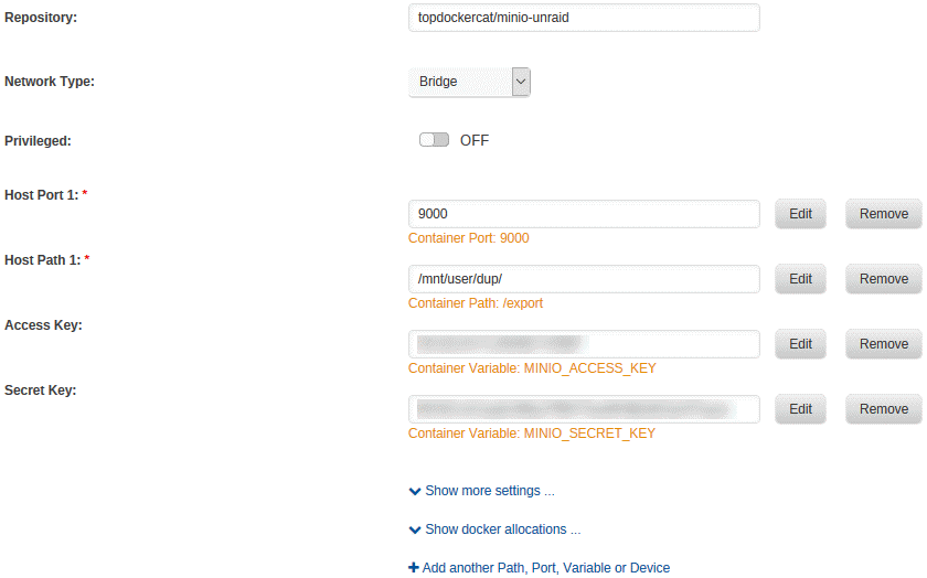

April 17, 20188 yr Did you end up getting Minio docker to work on unRAID? What is the process /configuration you used?I can post some screenshots of the options I added to the container screen after importing it from docker hub.
April 17, 20188 yr 35 minutes ago, digiblur said: I can post some screenshots of the options I added to the container screen after importing it from docker hub. Thank you -- screenshots of working unRAID Minio docker configuration were included in post referenced above. At this point I'm thinking of how (whether?) to harden it against attacks.

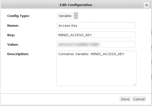

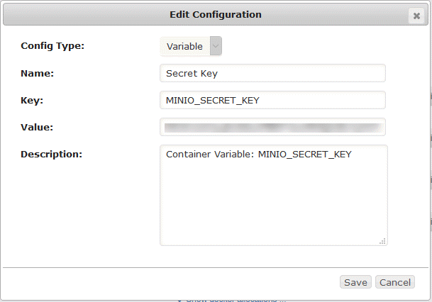

April 24, 20188 yr I did notice recently that the Minio instance I'm running changed its required login info (Access Key and Secret Key) every time the docker container was restarted. In order to remedy this, I set the Access Key and Secret Key as environment variables in the docker container settings. Per the instructions here: https://docs.minio.io/docs/minio-docker-quickstart-guide Here are some screenshots to help out other noobs like me. Then I can see that the Access Key and Secret Key are the values I set them to be in the container's log. Hopefully that helps. Ari

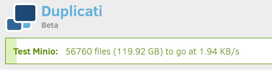

May 5, 20188 yr I am doing some testing of Duplicati to see how I like it. I've run two tests to see how Minio performs vs. SMB. Something has to be seriously wrong with my config/setup because Minio is capping out at only 2 KB/s ! On the same system, I did the same backup but instead targeting a SMB folder - it went reasonably fast (7-10MB/s). Both tests were run in identical environments (over wifi, same location, same backup set, same filters in Duplicati, etc.) - the only thing different was the backup target. Any thoughts on starting to investigate where the problem is?
May 6, 20188 yr Following up here... I let the Minio + Duplicati backup run to completion, and it completed in nearly the same time as the same test to the SMB destination. So, I'm just going to conclude that the KB/s reporting while it's backing up is just wrong because calculating the actual speed is closer to 7-10 MB/s on both configurations.

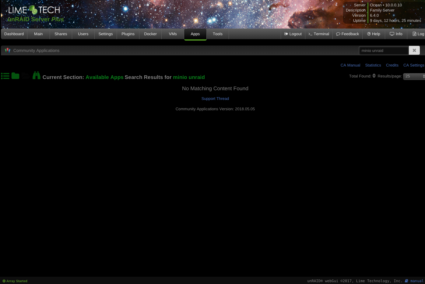

May 16, 20188 yr So I'd like to install Minio but so far I haven't installed any dockers that didn't have entries/pages in Community Applications. How do I install this on unRAID? (I've tried the docker pull from this docker's github page, but that didn't seem to do anything.) Thanks!
May 16, 20188 yr 57 minutes ago, ksignorini said: So I'd like to install Minio but so far I haven't installed any dockers that didn't have entries/pages in Community Applications. How do I install this on unRAID? (I've tried the docker pull from this docker's github page, but that didn't seem to do anything.) Thanks! Here's how I installed it. Hope this helps. Ari
May 16, 20188 yr Here's the thing... When I search Apps for Minio, it doesn't come up. That's what's throwing me.
May 16, 20188 yr OK, try searching community apps for "minio unraid" and then click on the "Click here to get more results from Docker Hub" link in the results page.
May 16, 20188 yr Maybe it's not in the default template repository? The only one I have is: https://github.com/limetech/docker-templates
