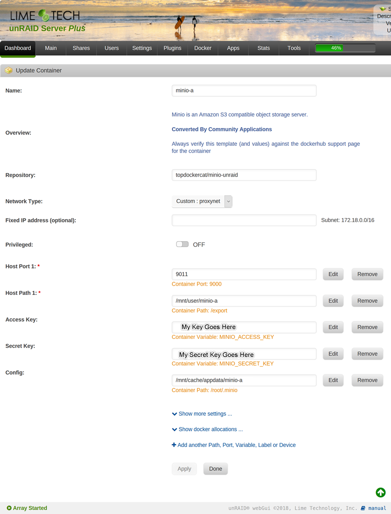

Now to configure a couple Minio dockers, all I had to do was:
Install Minio docker (instructions above in this thread)
Set the Minio docker onto the custom subnet I had defined using the video instructions referenced above, entering the key and secret key, and defining the port.
Then I go into unRAID's mnt/user/appdata/letsencrypt/ngnix/proxy-confs and copy the configuration file I made for nextcloud using the videos above, and save it as a new subdomain for the minio docker.
Note: 1) the subdomain should already be defined by your DNS host (in my case, CloudFlare), 2) should already be listed in the LetsEncrypt settings so that a certificate is generated for it, 3) should be unique, so you could have a few different Minio servers running if you wanted (like one for each family member if you don't want them to see each other's (encrypted) files.
What I end up with is a file named mysubdomain.mydomain.conf that looks like this:

		proxy_pass http://192.168.100.100:9011;
For some reason, I wasn't able to get it to work with "proxy_pass https://" such as works with Nextcloud, but rather had to change that to just http to get it to work for Minio. That said, I still get valid certs to Minio over https from the WAN.
I repeated this by setting up a new subdomain and a new Minio instance for each family member I wanted to allow to back up to my server, so they wouldn't be able to see or delete files from each other's buckets (not that the would).
Then I just configure Duplicati as normal to point to the Minio instance as described in previous posts above.
