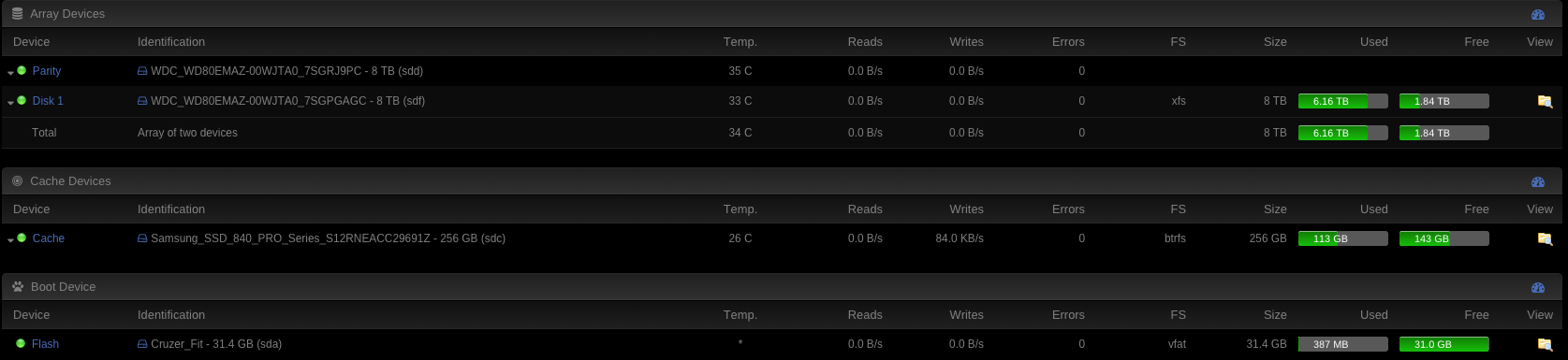

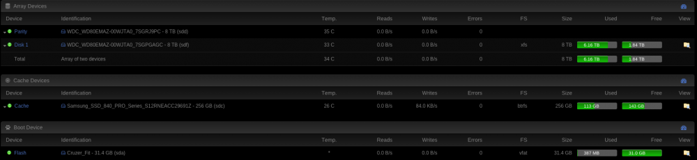

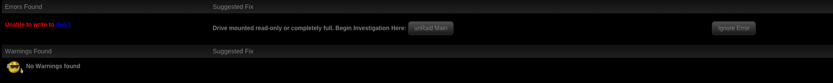

So, I am starting preparation to upgrade my Unraid from 6.4 to 6.5, and went to run the Fix Common problems plugin and am getting the following error:
However, when I go to the Main screen all is good.  My drive is Green, I absolutely can read and write from my shares.  So I'm not sure what is going on here.  My drive was marked as "Warning" because it was over 70% full, but I changed the threshold to 85% and it went back to Normal, but the Fix Common Problems plugin still has the above error after multiple Rescans and Extended Tests.  I'll post some screenshots about the drive, let me know if you have any ideas:
