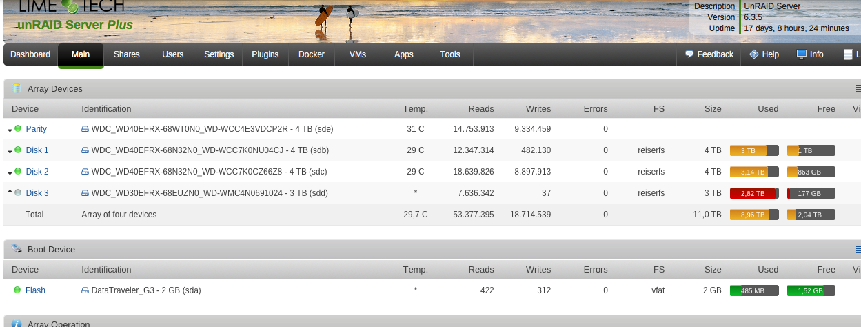

The disks I am using are 3 x WD Red 4Tb and 1 x WD Red 3Tb... but am concerned that the disks are being overworked... any thoughts? See screenshot attached!

Any install of Windows as a VM without a cache drive is going to nail your drives.   Windows isn't exactly known for not reading and more importantly writing constantly.  Beyond that, any mapped drives or libraries you may have assigned to an unRaid share you'd want to make sure that Windows isn't going to be indexing them.
Also you are using Reiserfs which an old and no longer supported file system that is known to cause issues on disks that are running out of space such as yours. I would highly suggest you consider moving to a file system such as XFS. Also, consider buying an SSD for your VM's they will run a whole lot faster and now impact your unRAID drives.
Thanks Squid/Ashman... as it happens I have a couple of 128Gb SSD disks which are 'spares' at the moment. The hardware I am using is an HP Microserver G8, so only has space for 4 disks natively... but I can squeeze 1, or maybe 2, SSDs in where the DVD drive is.

Also, I realise that ReiserFS is a very old file system, but dont know much about XFS... I had a quick Google and it says that UnRAID 6 uses XFS by default. I am guessing that as I have had UnRAID for at least 10 years, mine is still ReserFS as it has been upgraded over time... so is there a way to migrate to XFS, or would I need to dump all my data somewhere - rebuild the system as a fresh setup and then move all my data back? Would I benefit from upgrading to XFS?
No need to guess - it says so right there in your screenshot! You don't need to dump all your data somewhere safe but you do need to free up one disk. Sometimes that can be done by moving files from one disk to another. Yours are pretty full though. There's a lot of information about the process here.
