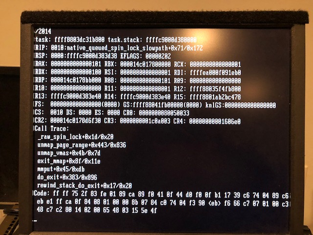

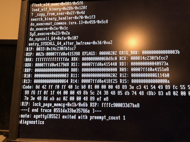

One of the two towers is almost done with parity check without writing corrections and has zero errors.  The other one crashed half way through and had 3 errors.  I was unable to get diagnostics at the machine on keyboard, but took some screen shots which i am attaching.

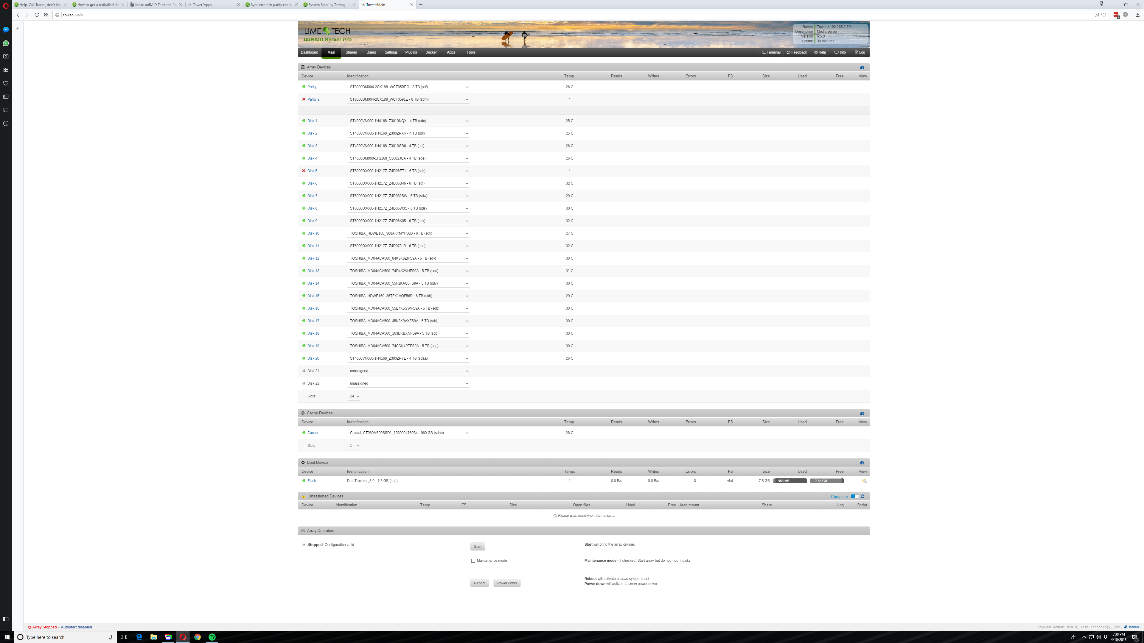

So does this mean your current situation is red balled drives? Diagnostics are helpful, but there is a lot of stuff in them and it can be a lot of work to figure out what you have without any idea of what to look for. Post a screenshot if you don't want to type.
screenshot attached:  Sorry i think my communication skills could use some work.  I am very greatful that you have responded by the way.
Edited by FrozenGamer
Syslog is being spammed with PHP warnings from the preclear plugin. You can turn these off in the Tips and Tweaks plugin (which you don't seem to have installed).
Syslog is also being spammed with wrong csrf token from preclear. Wrong csrf token is typically caused by having multiple browsers open to the webUI.
SMART looks OK for both disabled disks, parity2 and disk5. The usual advice would be to check connections, but considering how many disks you are trying to run with unreliable power I am tempted to blame it on your electric service.
