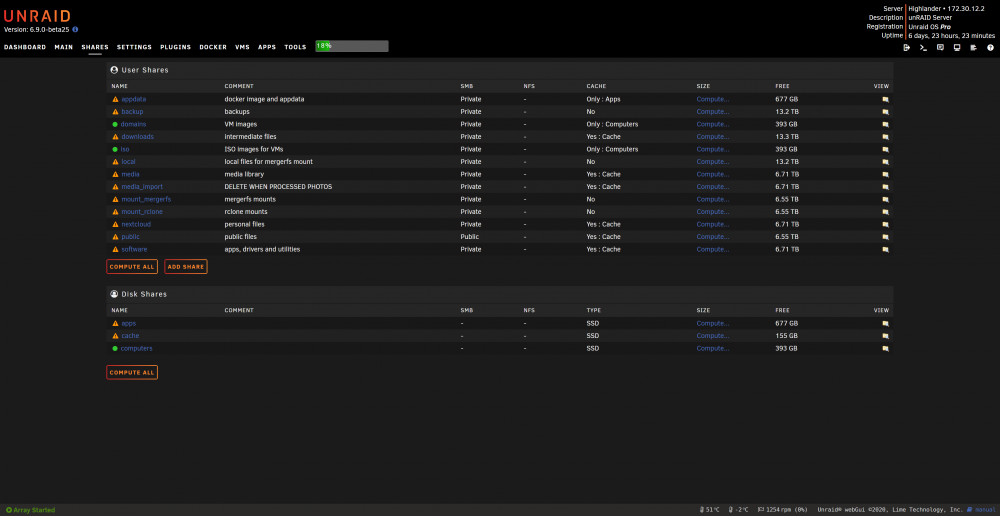

If I don't have multiple cache pools on Beta 25 will this still work?  I just have the standard cache pool named "Cache"

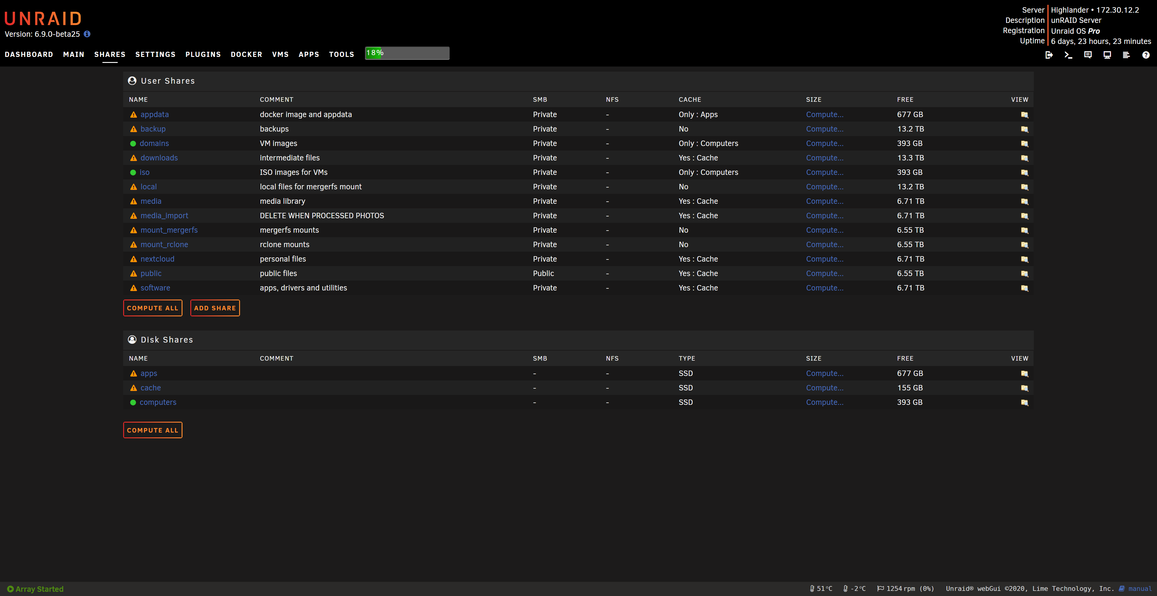

If only the cache pool has shares that are set to yes or prefer, and the other pools are set to Only, will it work?
Depends.  YMMV.  The original plugin is only a front-end to the mover and doesn't replace any coding at all.  The replacement fork replaces the coding in mover.
Net result is that IF you have multiple cache pools then mover will not operate correctly on the replacement.  It should be OK (no guarantees) if all the other pools are set to be only, and you only use the "cache" pool.
The original plugin will work properly but will always execute mover based upon the current state of the "cache" pool.
The original (and now unsupported) plugin's url is https://raw.githubusercontent.com/Squidly271/ca.mover.tuning/master/plugins/ca.mover.tuning.plg

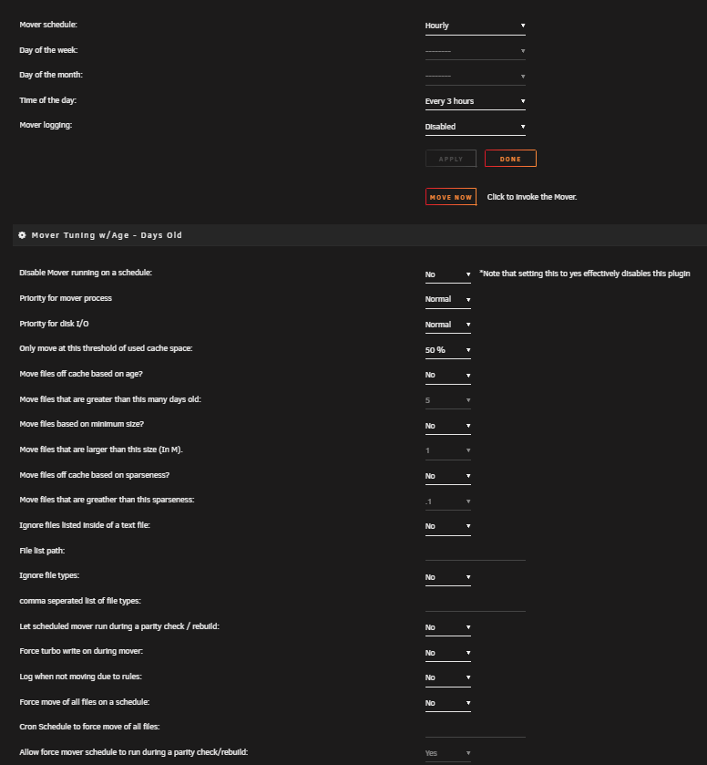

Hey there,
normally mover tuning works fine for me. every 3 hours the mover schedule starts and moves my file, if the cache is fuller than 50%. (i am right?)
i want to replace my cache drives while following this guide: https://wiki.unraid.net/Replace_A_Cache_Drive
now the "move now" button doesn't work. english is not my first language and i think i misunderstand some options. maybe someone can help me.
thanks
On 9/30/2020 at 11:54 AM, sonic6 said:
Hey there,
thanks
I would suggest removing the plug in, then moving everything.

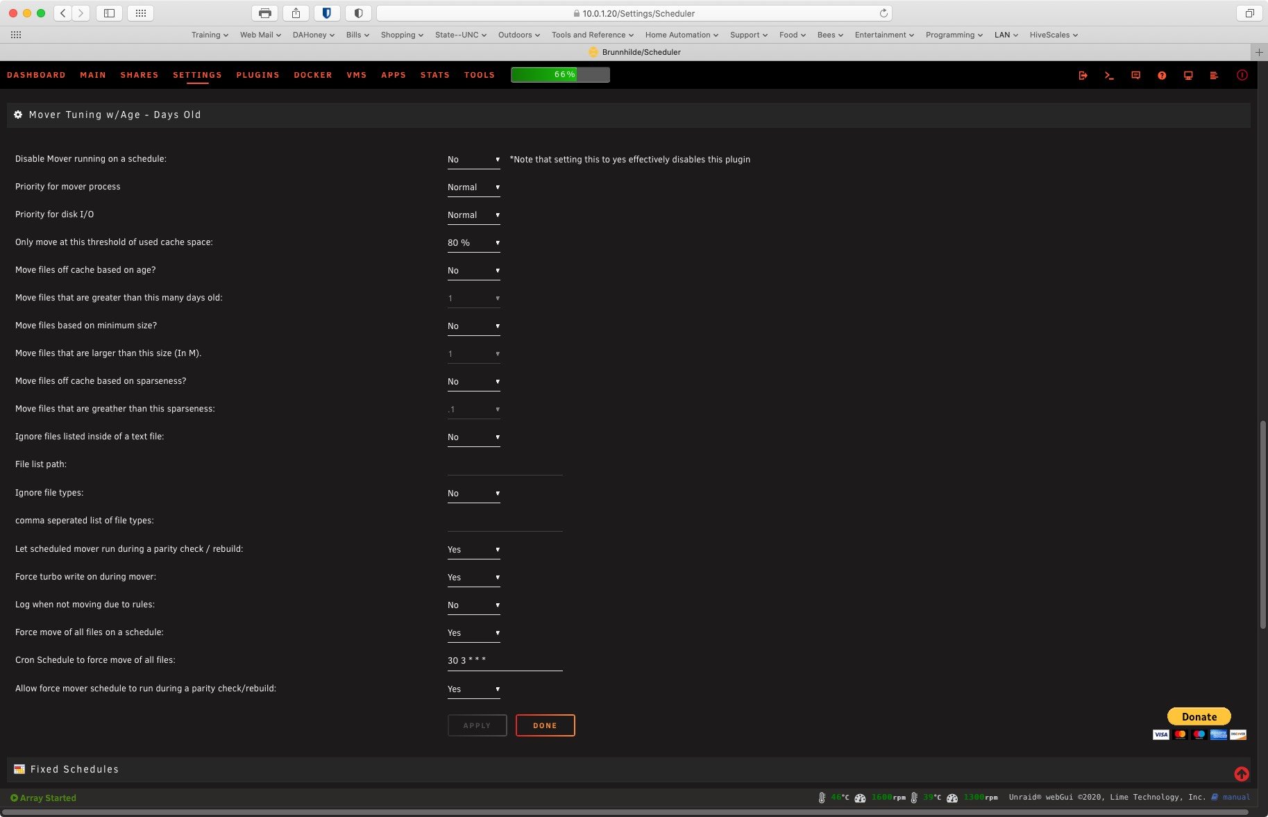

It appears that I must have something configured wrong with mover tuning. I keep getting high disk usage warnings for cache even though I have mover tuning set to start mover at 80% (I think). What do I need to change?

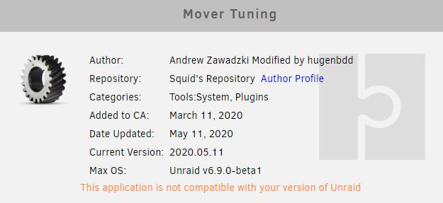

I cannot find this plugin in "Apps", has it been removed?
Edit:
It looks like it is not compatible with my version of unRaid:
Edited by Ballantin

I just updated to 6.9.0 beta 35 and fcp said I needed to uninstall ca mover tuning as it was not compatible with beta35. Any ide if it will be coming to 35 soon?
thx

I can't find this under Apps anymore. I'm on beta 35.
