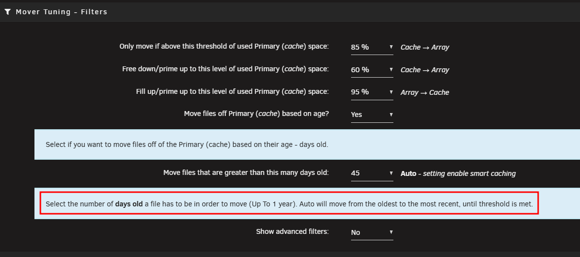

you have small gap between thresholds 5% , try increase it to at least 10-15% :
For example :
movingThreshold="50"
freeingThreshold="35"
For example :
I will change that and test later on.
I guess my assumption in how it worked was wrong, I had assumed any files older than the age set would be moved, as long as it was above threshold.
You are right, but you have also freeing threshold. Please reas help descriptions or press f1 for understanding the treshholds functionality
Also you have warning if low gap between them

it will be 2/ as described
in my case, once > 85 % treehold, mover will start, sorting by age ... freeing down to < 60 %, annything < 45 days old will be kept on cache anyway, so in terms i have alot of fresh files, it may will only free down to 70 % as all other files are "newer".
Set to auto would result in 1/ ...
