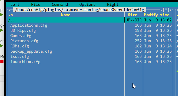

I did find out it has something to do with per-share overrides, or perhaps just a problem with one of my per-share overrides.
12 hours ago, Masterwishx said:
Enable log and debug log, then post debug.zip file
Immediately I'm seeing some weird deviations from my exclude list on my Podcast and TV shares. They're only excluding a few filetypes.
Neither of those shares have an override set.
I did use this plugin, once, a while back, and ended up reverting to the old version; Is it possible there's some leftover config files that need cleared out?
Debug_Mover_tuning_2025-06-09T130503.log
Edited by nmkaufman
Yes if you used some old versions maybe you have wrong configs then, you can reset settings by default button it will delete all overrides.

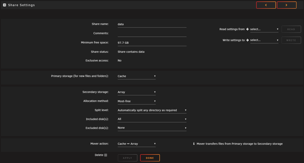

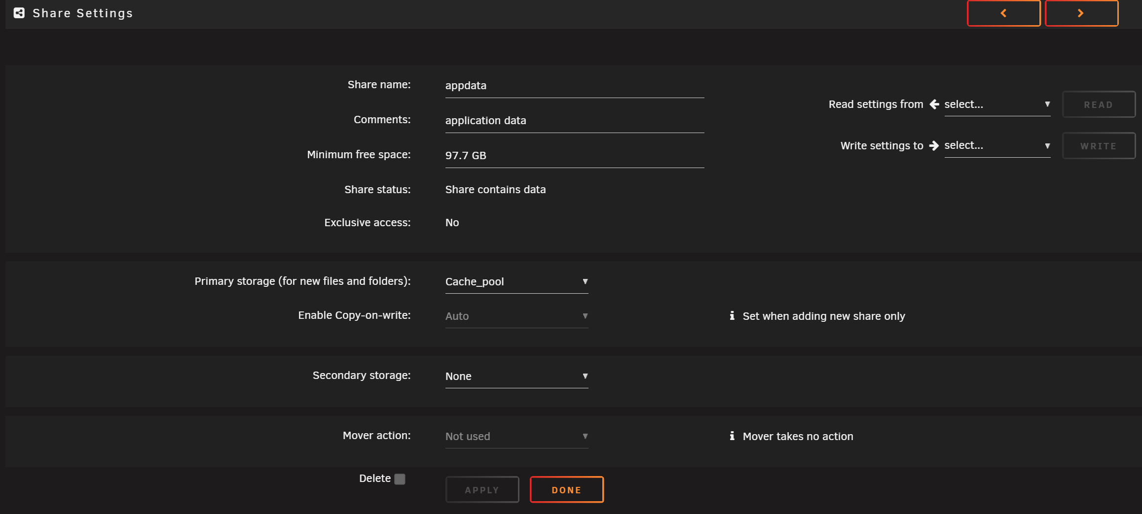

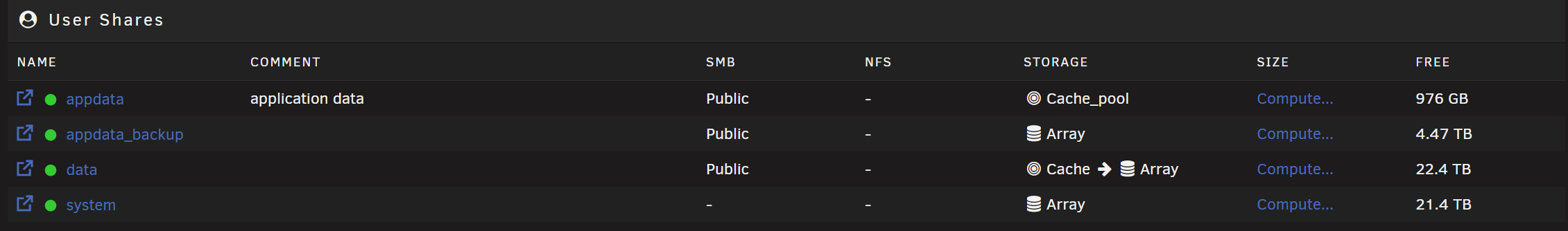

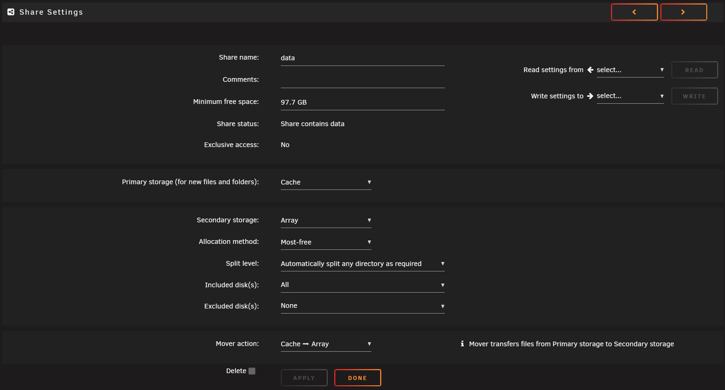

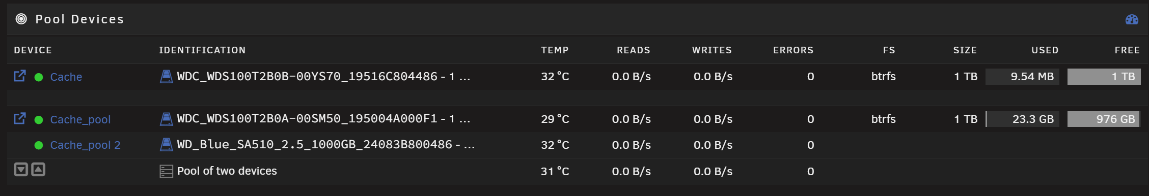

Stilling having the same issue when trying to use the plugin. The default mover works just fine.
I added 2 new ssd and made a new cahce pool of the two and moved my appdata to it. Ever since then the plugin just sits at this. You can see how my shares are setup.
You can see how my Cache Pools are setup.
My appdata share settings
Main data share

7 minutes ago, Masterwishx said:
it seems data share not found somehow i cant reproduce this issue but made small fix try it : https://github.com/masterwishx/ca.mover.tuning/blob/a3efc31abec71fb08e475b620fde962abf6acb31/source/ca.mover.tuning/usr/local/emhttp/plugins/ca.mover.tuning/age_mover copy this file to `usr/local/emhttp/plugins/ca.mover.tuning/`
and give the file chmod +x permissions
did not change anything.. Currently the only way ive gotten it to run is i made a new share and told it to use the same cache pool, after doing that the plugin runs 100% through.
I can live with this i guess.. i just have a share that i cant remove.

21 minutes ago, Masterwishx said:
can you post again debug.zip with new working output maybe it will give something compared to old one ?
ca.mover.tuning-debug-20250611-1318.zip
the cache pool names have been changed in this one since the first debug.zip i thought maybe the since they were named cache and cache_pool that was causing a issue.
IIRC renaming cache pool from cache or/and share named data can solve the issue
I see by logs its fine now ...
