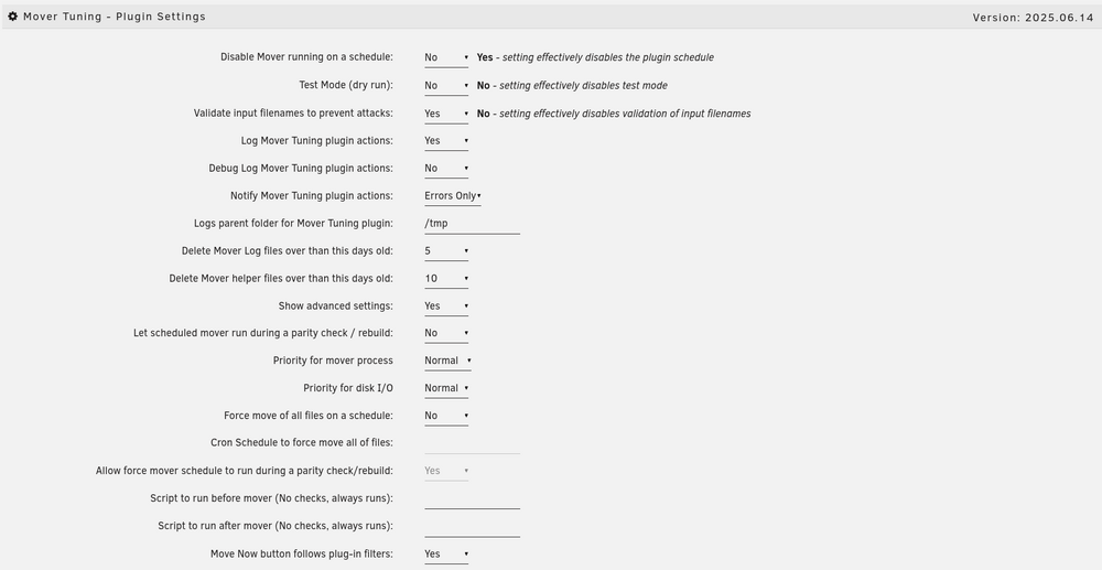

Yes. Same settings. If I run the update, it stops working.
And if I remove it and reinstall, reapply the settings, it also won't work.
It seems to be a combination of settings. If I install the new version with the default settings it does work.
Again, thx for your work! Plugin solves a lot.
Just in case maybe you tryed reset settings?

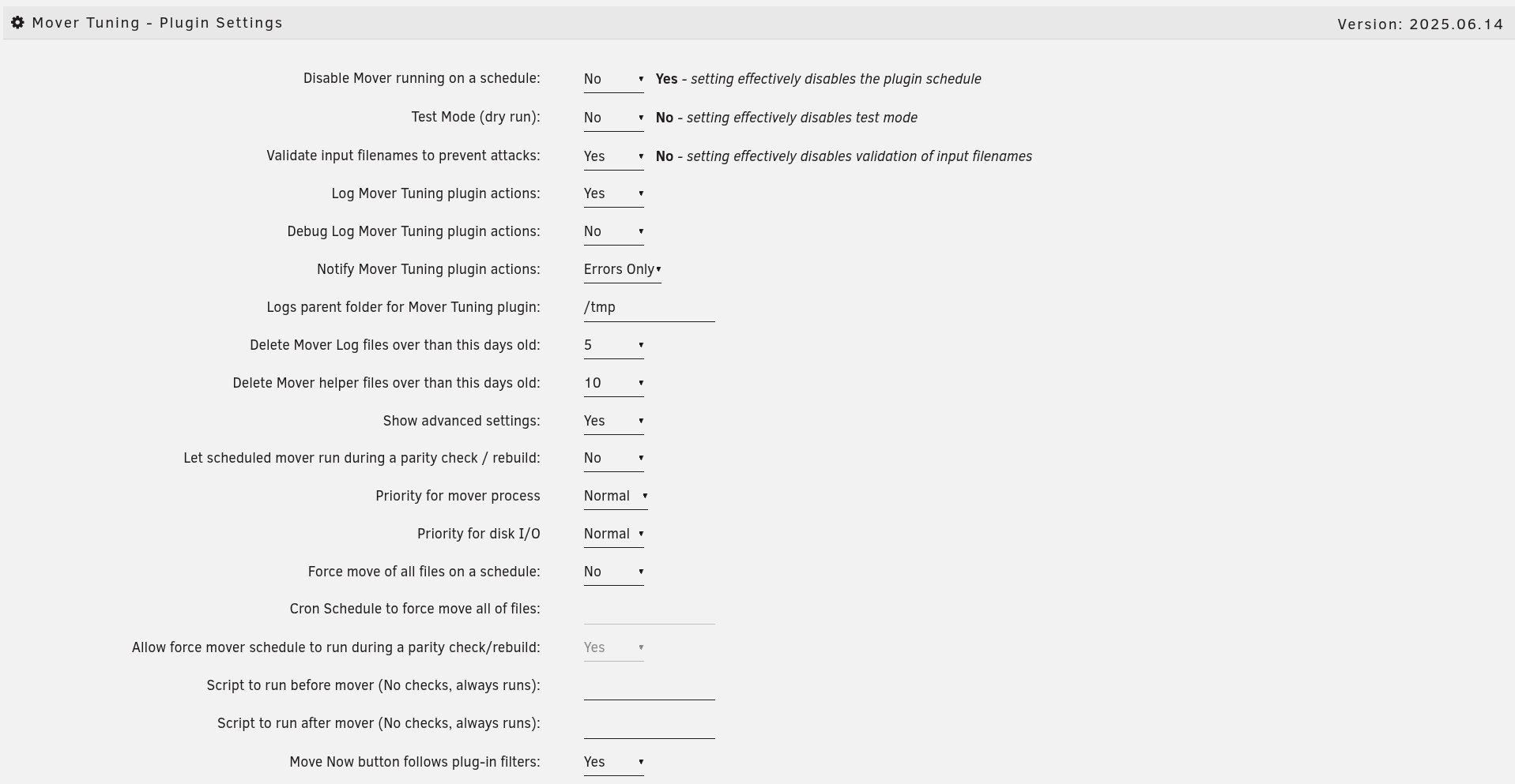

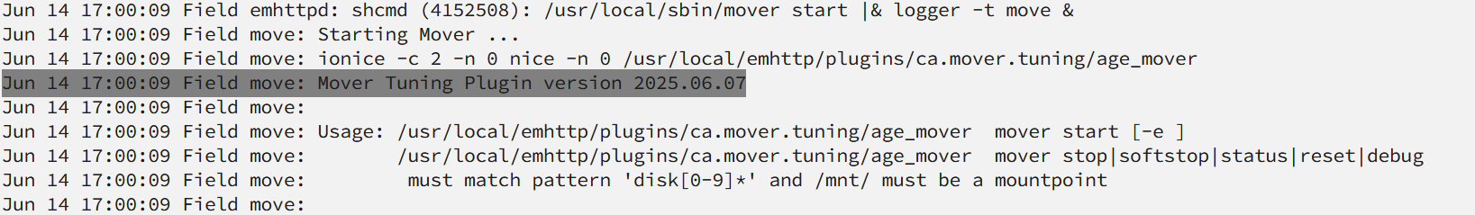

Just so you know it's not an isolated case, I have the same issue when I have the following set:
Logs show:
This impacted standard hourly moves and the 'Move Now' button. I have mover tuning set to run hourly, but runs weren't occurring.
/tmp/ca.mover.tuning has no new logs since June 10, there were no changes to my setup other than updating to 2025.06.07, no changes to my mover tuning settings have happened in a month or so until now due to noticing this issue.
Disabling force moving on a schedule allows the non-forced hourly moves to occur.
Does the force move cron schedule allow standard moving to work for anyone on 2025.06.07?

Thanks, any idea what caused the bug?
Checked my friends server, and it's happening for them as well (also on 2025.06.07 using the same cron schedule), but not my backup server with 2025.05.23.
Some old code + new code coused issue ... i pushed to github if interesed : https://github.com/masterwishx/ca.mover.tuning/pull/71/files
Every update im trying to fix bugs and add new futures so ....
2025.06.14 version Update
- fix: Fix age_mover is missing the "start" parameter in the cron schedule when force move is enabled. **_(masterwishx)_**
- fix: Remove renaming of "mover.cron" to "mover.cron.disabled". No longer necessary with previous version.

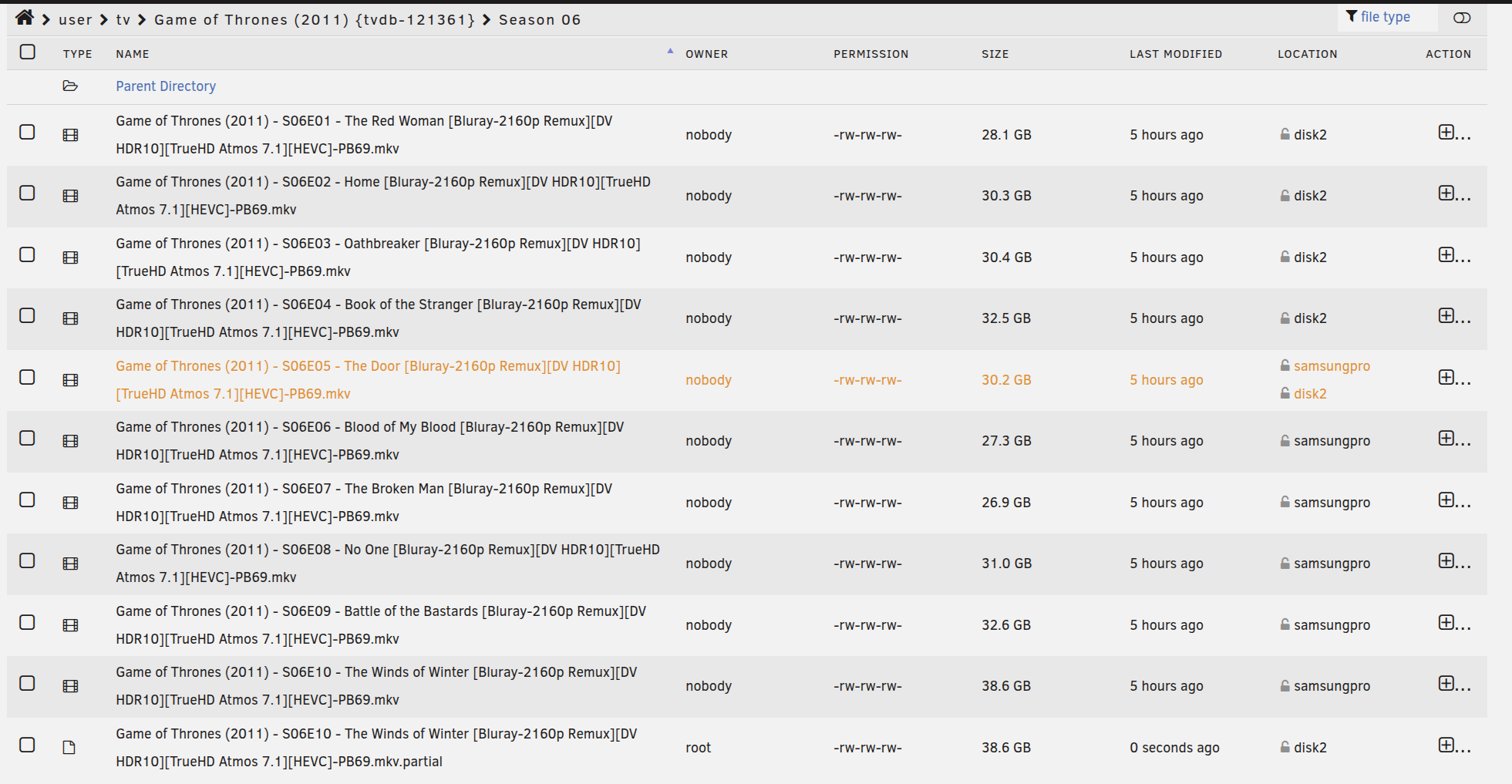

I have also noticed that sometimes the plugin will duplicate a file so I have the file in the cache and the array after a move and it doesn't move all the files sometimes. NB: all dockers access the files using the share ie: "/mnt/user" there is not mix of shares and direct access (ie /mnt/<drive_name>/).
I just updated as well.
TV Shows are downloaded to download_share on a cache
When TV Show is imported it is removed from the download client and the TV Show is moved into tv_share which initially is on the same cache_drive, but periodically the cache_drive is emptied onto the array for long term storage.
I havn't noticed any issues with mover until I've moved to unraid 7.

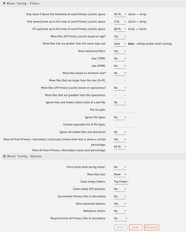

Mover Tuning Plugin Settings: (i just enabled the clean empty folders setting, but previously it was not enabled)
This is a duplicated file from the mover:

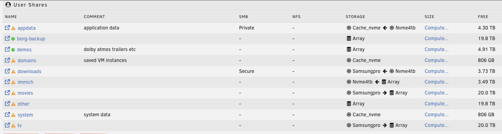

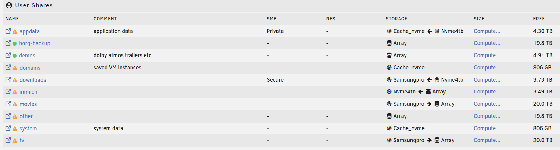

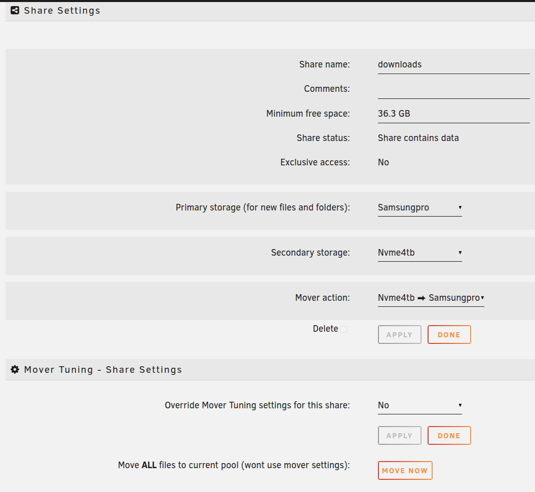

This is the shares setup:

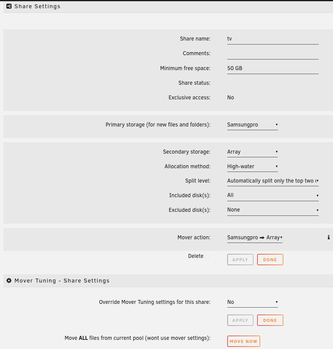

TV Share Settings:
Download Share Settings:

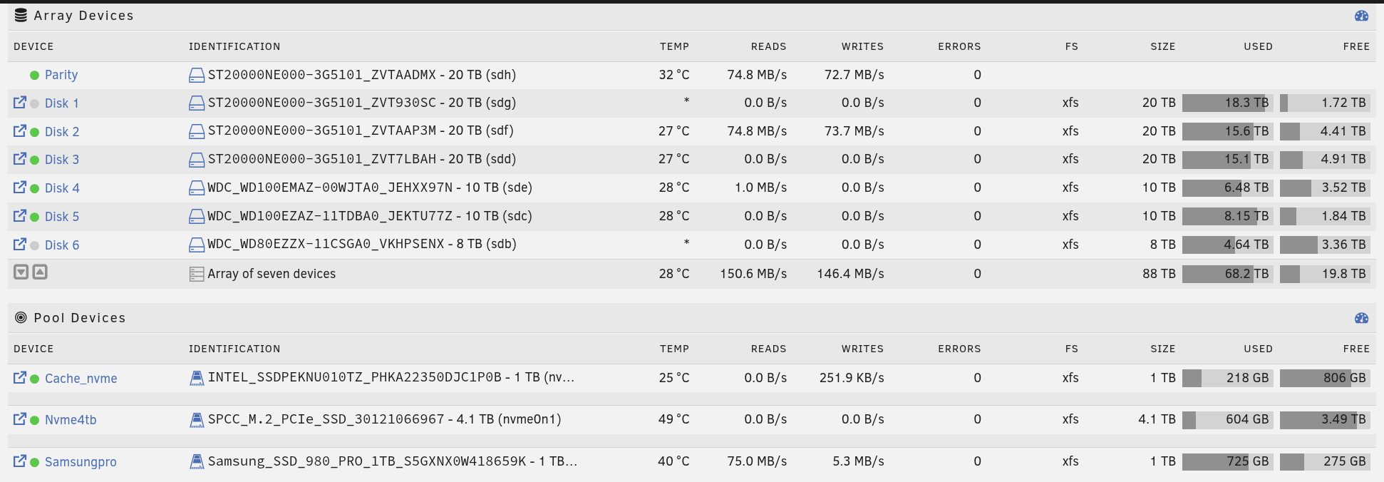

Main view of array / share drives:
Edited by kiwijunglist
More worrying I also noticed that the mover has someone deleted a file. I ran the mover again and it deleted game of thrones S06E09 in the above, it is gone from the samsung_pro and it is not on the array anymore.
This should not happen, I will check your debug.zip
You can check Rsync or move what work better for you.
But folders deleted after files was moved and if only empty folders...

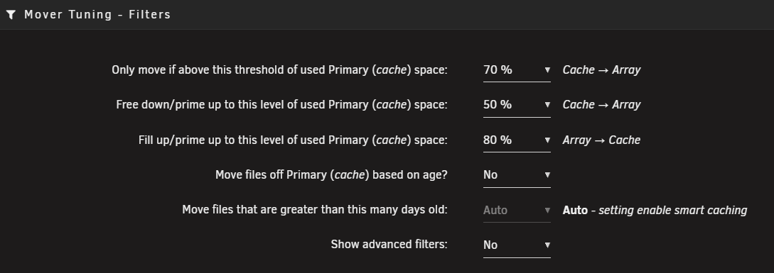

Trying to understand how this works and its little confusing to me (n00b).
My filter settings are here:
Here is how I read what will happen:
  1. once my cache gets to 70% it will attempt to move stuff to the array, basically this is what triggers mover ca
  2. Even though it will get triggered at 70% it will always keep at least 50 % of the data in cache
  3. The mover will move data back to cache until its up to 80 %

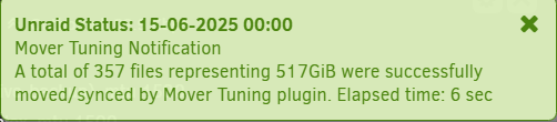

What I see happening is this :
So Reading this I expect that 517GiB was moved off my 2TB cache. Not the case I don't know what it moved but my cache level didn't change
Currently my cache sits at 78% so I'm wondering what this notification is actually four and once I get over 80% cache should it then stay that way all the time and mover is just moving things to keep it at 80%
Am I totally misunderstanding the help hints? TIA
nope, but depends how your shares are setup ...
