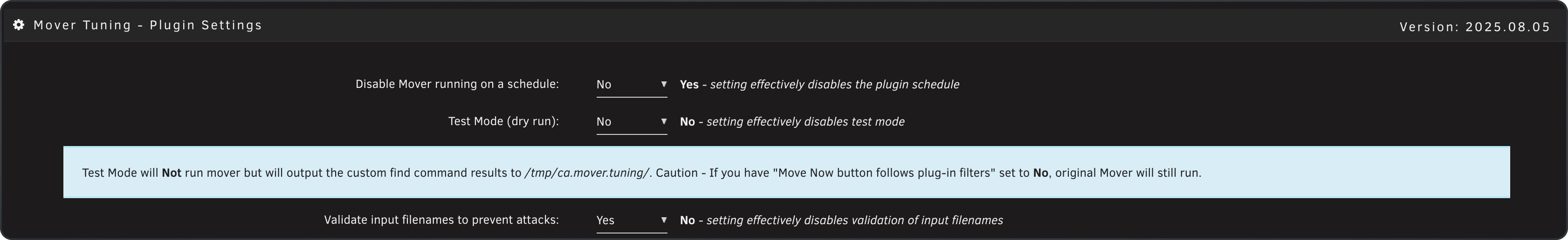

@Masterwishx
Can this helper text be updated for clarity? A standard format could be
" Setting to Yes effectively disables the plugin schedule"
Specifically for the test (dry run) mode; the current help text makes it sound like setting to No would disable the plugin but that's counterintuitive to what "Test Mode: No" reads as
Sure I can update it but you refer to two options that have separare help texts.
In test mode help text refer to another option that if it set to No.
Anyway will try to update it
Edited by Masterwishx
Yes, sorry for the confusion. If it's helpful, here's what I'd put forth:
  1. Disable Mover running on a schedule - "Setting to Yes disables Mover from running automatically"
  2. Test Mode (dry run): - "Setting to Yes enables Test Mode"
  3. Validate input filenames to prevent attacks - "Setting to No disables validation of filenames"
Feel free to copy, modify, or ignore. Thank you, @Masterwishx!
Ohh you mean help from the right, I was thinking we are talking about help text inside, when click on option :)
Yes, sorry haha - the next alongside the setting; not the popup description inside
I will try to change help description inside but, description from right is not clear?
