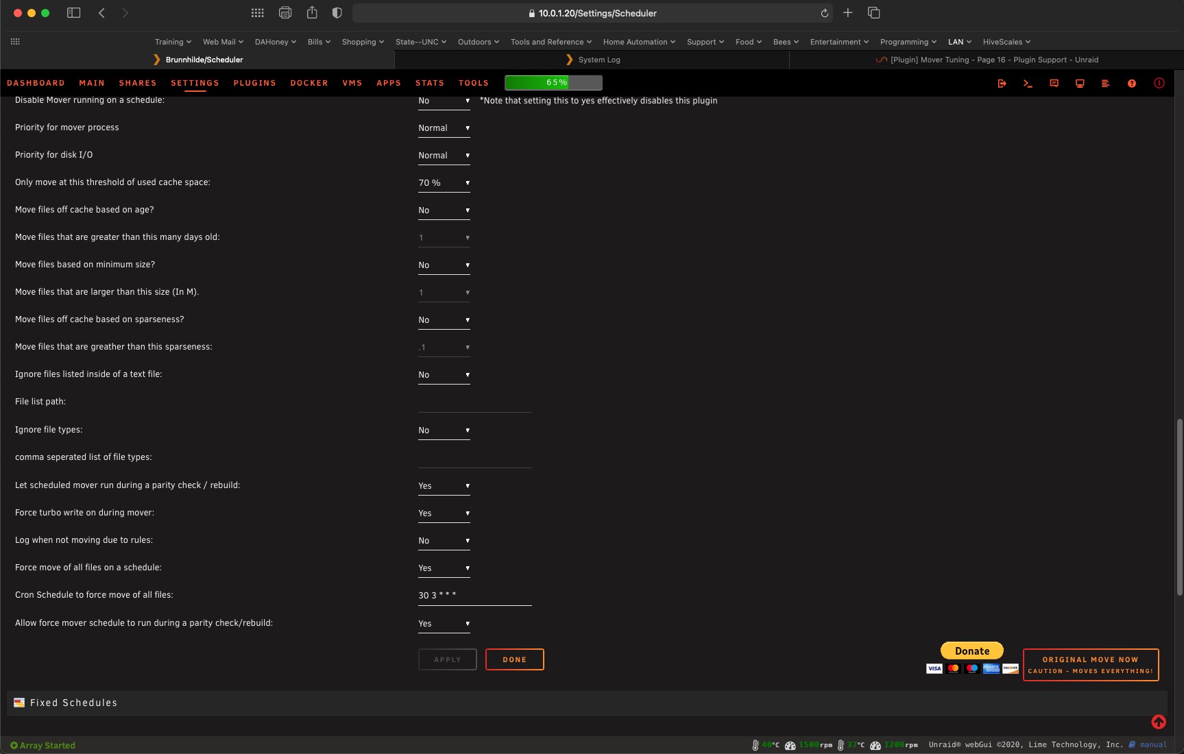

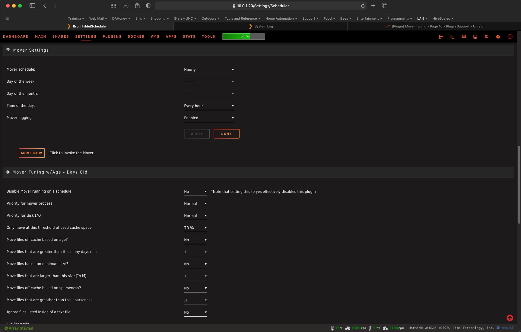

Current settings (might just be user error 😁)-
SafariScreenSnapz006.thumb.jpg.5fc83eb6812657ab4f02f70b467d6671.jpgSafariScreenSnapz007.thumb.jpg.794b2bae2d8f1feb5796d089f5392f82.jpg
13 minutes ago, wgstarks said:
Im testing with a 20GB file. I see this in syslog-
Mar 17 15:00:24 Brunnhilde emhttpd: shcmd (211): /usr/local/sbin/mover |& logger &
Mar 17 15:00:24 Brunnhilde kernel: mdcmd (492): set md_write_method 1
Mar 17 15:00:24 Brunnhilde root: mover: started
Mar 17 15:00:24 Brunnhilde root: mover: finished
Mar 17 15:00:24 Brunnhilde kernel: mdcmd (493): set md_write_method 1
After the move the file is still on the cache.
Edit: I also never get “Mover is running” displayed.

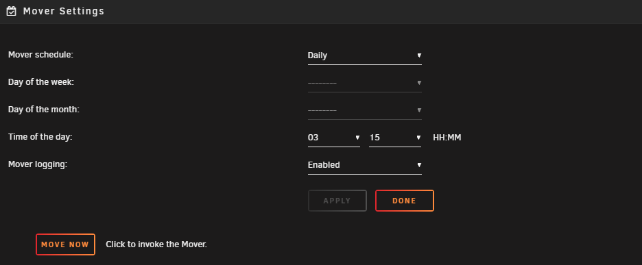

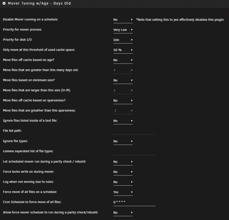

Love the plugin and I'm fine with the emails if it helps out debugging. Got a couple questions.
1. Using tuning, I have mine check for a threshold of 50% each hour on the hour for when I copy large files to the server or download a lot to make sure I don't fill up the cache. Then using the original Mover Settings, I have it move everything every night to make sure everything is protected within 24 hours. Does this sound like a reasonable strategy? Any suggestions or issues?
2. I believe it worked this way last time I messed with the settings months ago. Now I don't think the daily full move from Mover Settings is working, so I only get files moved when I hit 50%, which may not happen for days or weeks of normal use, leaving files unprotected. Here are the settings I settled on when I got it running a while ago using this topic. Do I need to make any adjustments to get it working like I stated in #1, specifically the daily move?
1.) Should be nothing wrong with that.  The only possible issue you may run into, is that if your hourly move is not done when the nightly move kicks off.  The nightly move will see the PID for mover, and will just exit.  Therefore not moving your "nightly everything" request.
2.) This can still be done, but you have to kick off the script in cron with the renamed "original Mover" mover.old    This will mean that you are running the original "unraid" mover script.  Basically, no filters on the "find" command that my plugin creates.

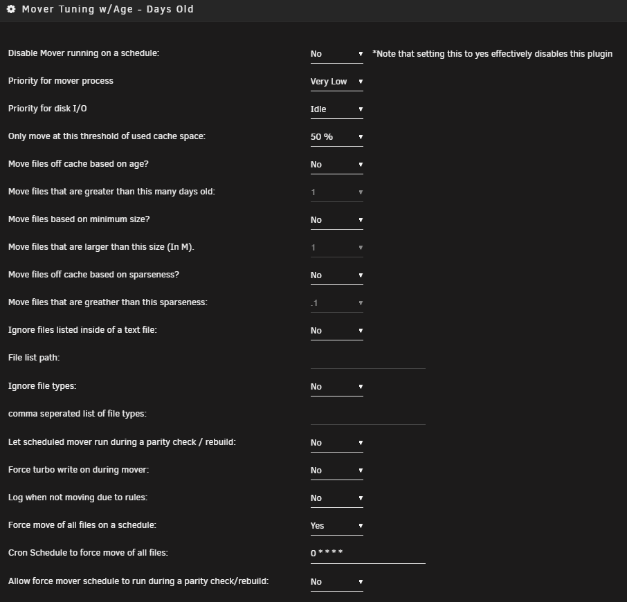

So that means that the Mover Settings section is now ignored if Mover Tuning is enabled? If so, is adding mover.old to cron easy enough that you could show me how to do it? Then I can dig into it and learn more about cron on my own.
no, the opposite.
Scheduler and mover tuning w/age section are followed.
If you setup a cron job with user scripts plug-in, for the original mover, it will not follow any settings, and move files off the cache.

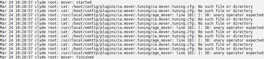

Hello!
Mover tuning seems to be broken after an update to 6.9.1 where it prevents the mover from moving files to the array from cache. It is still broken after re-installing the plugin. The error I get from the logs is attached. Removing the plugin fixes my issue.
Thank you!

5 minutes ago, redeuxx said:
Hello!
Thank you!
What version were you running?
Also, the Line 181 error, should have been fixed in the latest version.  But it's possible there is an error somewhere.  The Share config file does not get updated with the cache pool during an upgrade unless you change the cache pool name in the share GUI screen.  The latest release assumes your cache pool name is cache if it is not found in the config file.
I was running the latest version from CA, 2021.03.17. The name of my cache is "Cache". It was the same name before I upgraded.
If you decide to re-install it, please verify that the plugin config file exists.
ls -ltr /boot/config/plugins/ca.mover.tuning/ca.mover.tuning.cfg
You may have to select some setting in the scheduler (Lower Section) for this file to be created/updated. (i.e. move at 50% usage)
