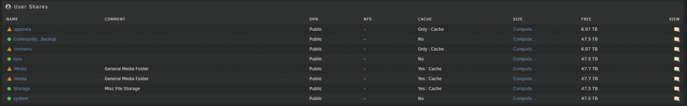

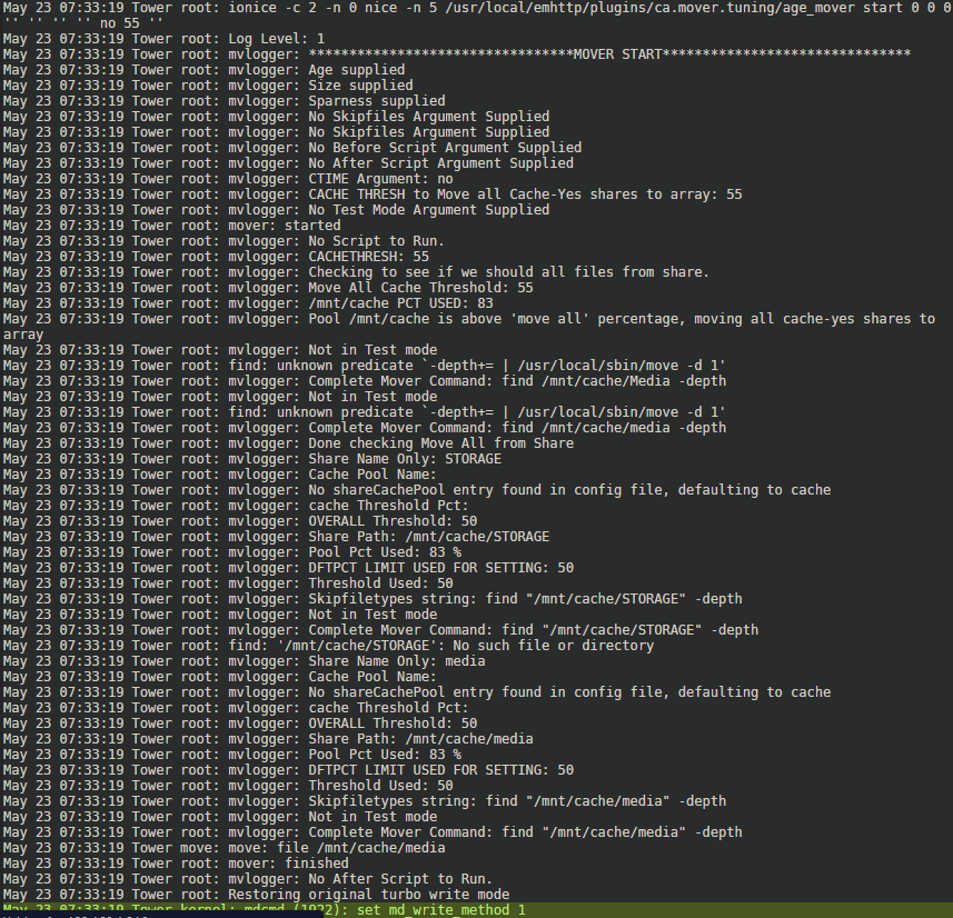

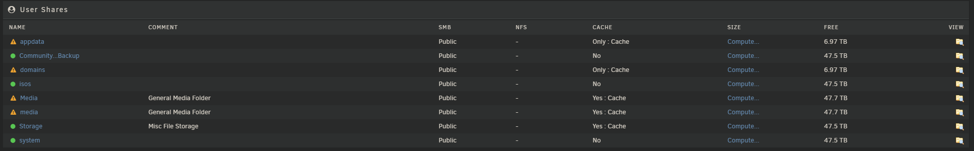

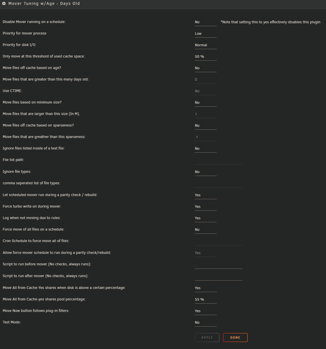

1 hour ago, hugenbdd said:
Can you post what your share config files are listed as?
There is a mis-match somewhere between the config files (Case) and the share names.
ls -ltr /boot/config/shares
If that doesn't fix it can you post your debug file?
original mover loops through the directory on the cache, where I have to loop through by config files.
That was indeed the problem. Thanks! I have fixed the name of the config files and everything is working now. Thanks for the help and keep up the great work you do here!
