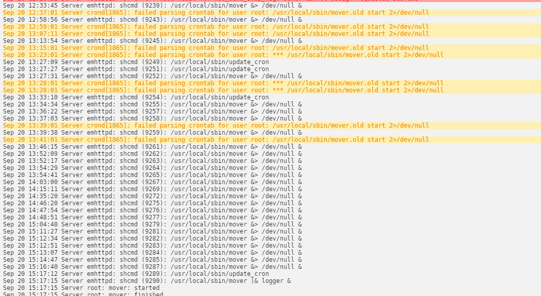

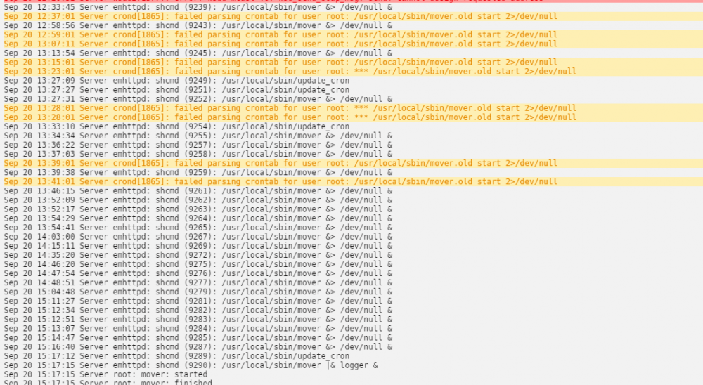

Hmm, will we need an updated plugin for 6.10? It appears to not apply the tuning settings and just uses Unraid's default mover.
Possibly.  I don't have 6.10 yet.  I'm still on 6.9.1
I'll update my dev box this week.
What might have happened is that 6.10 provided a new mover script.  Overwritting the plug-in's script which just points to the plug-in's new script or the original script.  You might be able to get the plug-in working by removing then re-installing the plug-in.
Ahh, I see! No luck on removing / re-adding. Didn't try a reboot between those two, however.
Unraid update would have required a reboot. In fact, the new version isn't loaded until the next boot.
After the new version loads, the built-in mover script is in RAM just like the rest of the OS.
Then any installed plugins are applied.
not sure if this helps but, I verified /usr/local/sbin/mover is the plugin and mover.old is the original. calling mover by itself doesn't work as intended but running /usr/local/emhttp/plugins/ca.mover.tuning/mover.php with the parameters I want does. not sure where the disconnect is happening.

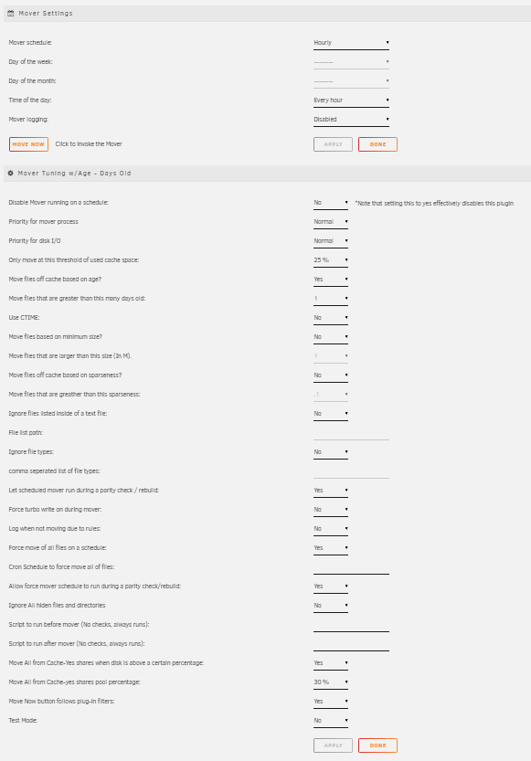

Forgot.. (I have to many options in the plugin....)
But do you have this set? (Second to last question)
Move Now button follows plug-in filters: Yes
Oh my goodness! My apologies. That was it. Is that a new-ish option?

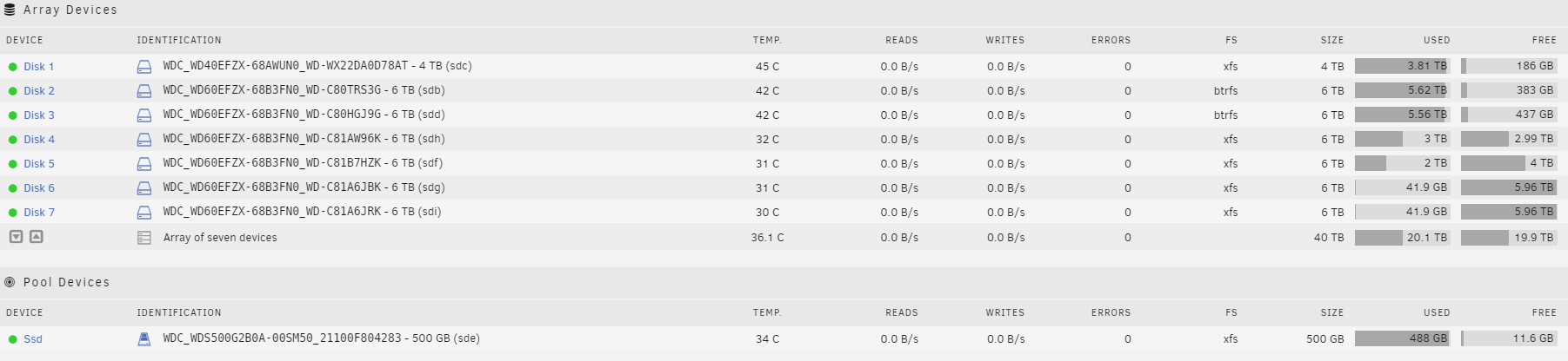

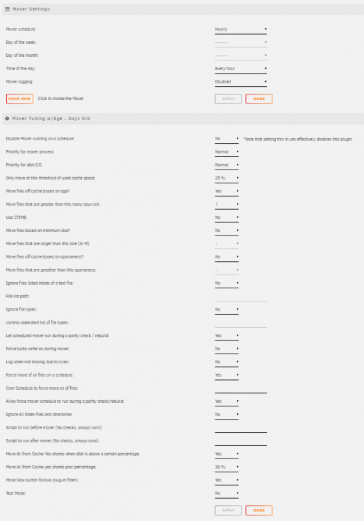

Ok Guys/Girls
i can't figure out why my mover isn't working.
i want to keep my ssd as empty as i can
can you help with settings to make it move everything hourly?
and keep my ssd drive 25% full?
Edited by Vader666
Try setting this to 0 and not 1.
Move files that are greater than this many days old:
You can also run in test mode and review the files it will be selecting.  (see the log file)
  so it gets to 60gig free space and stops moving
Enable logging, then check what files are left.
Do you have other shares using this cache drive?  (i.e. appdata)
And you probably want to set this to no.
Move files off cache based on age?
ok i will change that
