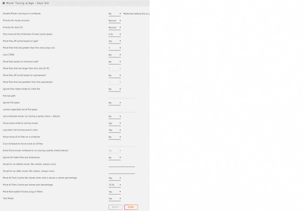

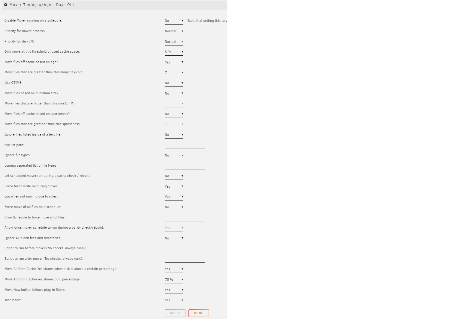

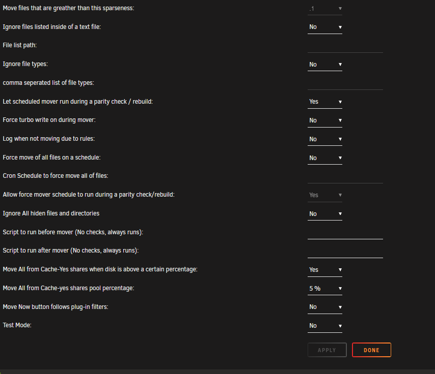

Still not working right. For some reason files are all being moved every hour. Disk usage percentage setting is being ignored.
Current settings-
835058539_ScreenShot2021-10-18at6_44_30AM.thumb.png.059c16d9759c4e636adb58be58d6328e.png
26337263_ScreenShot2021-10-18at6_44_30AM.thumb.png.4f42a9e586b598e3a0f32dc12a50a3fd.png
mover_log.txt
I will be out for a few days and won't be able to look at the issues until Wed. evening at the earliest.
The best way to get the settings you want is to set the plug-in to test mode and enable logging.  Then review the syslog for the cache entries.

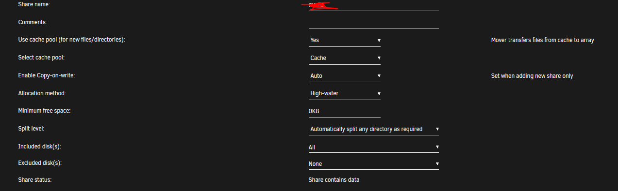

I still have the problem actually. I enabled logging and saw that it tries to move "Media" - but my share is named "media". I have no Idea why it thinks its with capital. Everywhere i used "media" and not "Media". All works except the mover?
Is it save to just rename "media" share to "Media" without breaking everything?
look to see what the config file is set to
ls -ltr /boot/config/shares
If it mis-matches (based on the case of the letter) then that is the problem.  Else, maybe post your debug log files?

There are all my mounts  - and one named "media.cfg". So it seems right there. I dont know though why your mover plugin thinks its "Media"?

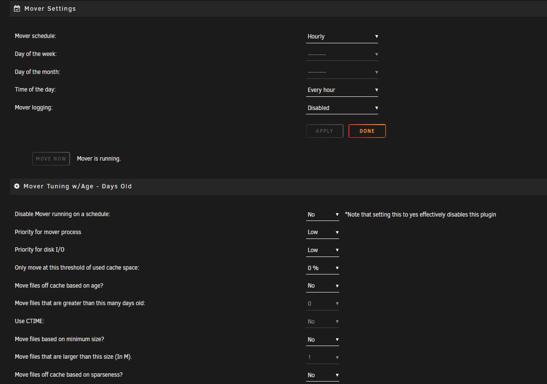

I've noticed that setting mover tuning to move based on age at greater than 1 days old only moves once the file hits 48 hours from MTIME. That makes sense to me, but going with this logic I'd expect setting it to 0 days would move files only when they hit the 24 hour mark using MTIME. Unfortunately, in practice it moves all files even if it's less than 24 hours. Is there a way for me to move files that have been on the cache for at least 24 hours?
Move files off cache based on age? Yes
Move files that are greater than this many days old: 0

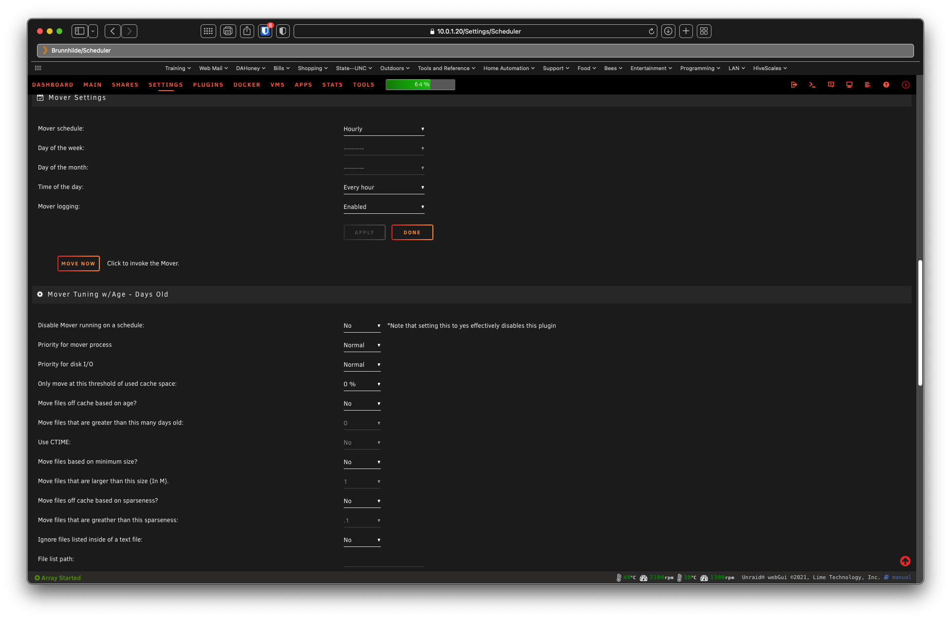

Hello,
Running into an issue with the mover tuner at the moment. The intent is to have the mover run every hour, and only move files that are >7 days old, however if the cache is >75% full, run the standard mover/move everything on a Cache:YES share to the array.
I have my settings set to what I think are correct, i.e. only move files that are greater than 7 days and 'move all from cache:yes shares' to yes and 75%.
When testing the settings with the Move Now button follows plug-in filters and Test Mode set to yes, I can see mover picking up on files that are less than 7 days old in the log. However, once I set test mode to off and manually invoke the Mover, it runs without actually moving any files and doesn't detect any files that need to be moved.
Any idea what's gong on?
