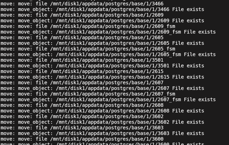

Finaly i added some cache pools and parity drive to array.
having to question:
1. all our shares that prefer cache is marked as unprotected is it OK?
2. when mover regular run having some files exist also not exist on some apps [ appdata is (prefer ssd) that was moved after stopped docker services ] but now like this:
any ideas guys?
Edited by Masterwishx
having to question:
any ideas guys?
Hi Masterwishx
I don't think this is a plug-in issue.  This is a general mover issues.  You would probably have better luck posting a separate thread with debug log attached.

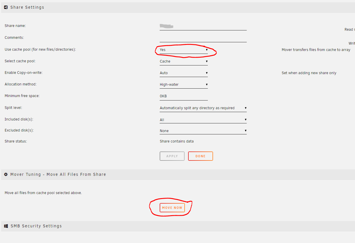

File ignore settings are not working anymore.
I had some .anchor files which are now being moved despite being in the "Ignore file types".
I tried the "Ignore files listed inside of a text" setting, and was not working either.
I finally got around the problem create a script to run after the mover (which is not ideal)

Can you turn on logging and post the entries from the syslog?
makes it easier for me to reproduce.
Think I was able to reproduce.
Nov 11 21:26:33 Tower root: mvlogger: find "/mnt/cache/TV" -depth -type f -mtime +29 -print0 -e '.anchor' | du -shc --files0-from - | tail -n1
Nov 11 21:26:33 Tower root: find: unknown predicate `-e'
Will look at this tomorrow.
Update is out.
(No more sizing of total files in test mode)
Seemed to work with my changes, as I was only getting an error when in test mode.
Please post your settings and the log entries if it still errors for you.

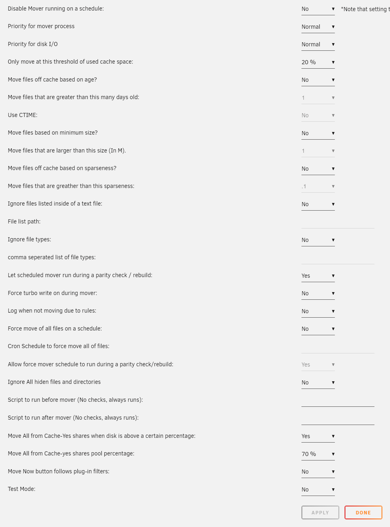

Something change recently? I have my Mover set to move everything 15days old.
Everything Moved.
I haven't changed a setting in months.
Is this New?
Move All from Cache-Yes shares when disk is above a certain percentage: Yes
Move All from Cache-yes shares pool percentage: 10%
Everything Moved.
Is this New?
Yes, can you post your log entries? I tried to test as best I could.
Well if that is new then I had files bigger than 10% of my drive so it moved them per the settings.
I changed them to NO for the future and I'll see what happens. ;)
Not a big deal I just didn't know those settings existed and moved files off my Cache. Lol
Is it possible to add new features and have them default to NO just to avoid future questions/issues. I'm not mad or anything, it just perplexed me when I fired up a Movie I ripped earlier and my drive spun up when it normally doesn't for 15 days.
Looking at my Logs it looks like it did what was intended, I just didn't know about it. Lol
There was some issue with it that was causing it to not move in the past.  I fixed it, and tested as best I could...
That should move everything if the pool is above 10% (I would recommend this be above 60% or more if using it.)

Hello, this is the beginning of my log (I am on 2021.11.12). I Tried with .anchor, anchor, and both.
Nov 15 15:50:44 Tower root: mvlogger: *********************************MOVER START*******************************
Nov 15 15:50:44 Tower root: mvlogger: Age supplied 0
Nov 15 15:50:44 Tower root: mvlogger: Size supplied
Nov 15 15:50:44 Tower root: mvlogger: Sparness supplied
Nov 15 15:50:44 Tower root: mvlogger: No Skipfiles Argument Supplied
Nov 15 15:50:44 Tower root: mvlogger: SKIP FILE TYPES: .anchor,anchor
Nov 15 15:50:44 Tower root: mvlogger: No Before Script Argument Supplied
Nov 15 15:50:44 Tower root: mvlogger: No After Script Argument Supplied
Nov 15 15:50:44 Tower root: mvlogger: No CTIME Argument Supplied
Nov 15 15:50:44 Tower root: mvlogger: CACHE THRESH to Move all Cache-Yes shares to array: 5
Nov 15 15:50:44 Tower root: mvlogger: No Test Mode Argument Supplied
Nov 15 15:50:44 Tower root: mvlogger: No Ignore Hidden Files Argument Supplied
Nov 15 15:50:44 Tower root: mover: started
Nov 15 15:50:44 Tower root: mvlogger: No Script to Run.
Nov 15 15:50:44 Tower root: mvlogger: CACHETHRESH: 5
Nov 15 15:50:44 Tower root: mvlogger: Checking to see if we should all files from share.
Nov 15 15:50:44 Tower root: mvlogger: Move All Cache Threshold: 5
Nov 15 15:50:44 Tower root: mvlogger: /mnt/cache PCT USED: 31
Nov 15 15:50:44 Tower root: mvlogger: Pool /mnt/cache is above 'move all' percentage, moving all cache-yes shares to array
Nov 15 15:50:44 Tower root: mvlogger: Not in Test mode
Nov 15 15:50:44 Tower root: mvlogger: Complete Mover Command: find /mnt/cache/media.movies.4k -depth | /usr/local/sbin/move -d 1
Nov 15 15:50:44 Tower move: move: file /mnt/cache/media.movies.4k/local.anchor
Looks like it's working as intended.
Move All settings move everything in the share if it's on the cache and percent is above the Move All Cache Threshold.

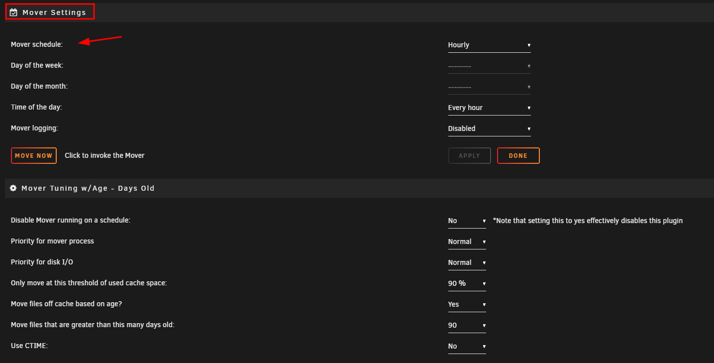

So, I recently installed this plugin, and have it set to Move All from Cache-Yes shares when disk is above a certain percentage:Yes and the threshold set to 75%
I manually invoked the mover, so the cache was empty. I then transferred media to the server, and it filled the cache drive to 88%, and the mover wasnt initialised by the plugin. What have I missed?
how often do you let the mover scheduled run ?
if you use it like me with a treshold, i let it run hourly.
OK, that might have been it. I had it scheduled to run daily (at 1am). Changed it to hourly. So effectively that is how frequently the mover tuner will check those thresholds?
Yes

Thanks for the help. So what are the two different thresholds for then. One to ignore move if the cache is at least than say 50% then the other to move if the cache is more than say 70%... What's the difference?
As an example, how could I set the mover to run every night at 2am, or if the cache disk is more than 70% full?
I use a user script to move all the files at a certain time and use this plugin to move all files at a certain percentage.
#!/bin/bash
/usr/local/sbin/mover.old start
Edited by wgstarks

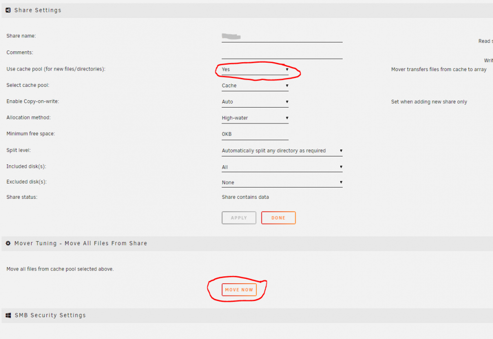

New Release
###2021.11.23
- Add GUI button in individual shares to move just that shares files from the cache. Must be cache yes
- Fixed bug where original mover would overwrite syslog instead of append.
Suggested from Tomr
*Guess my wording could be a bit better.  Basically sends all files on the cache pool name it find in the share path (example: /mnt/cache/TV) to the array.
