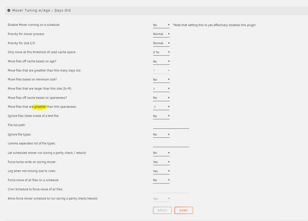

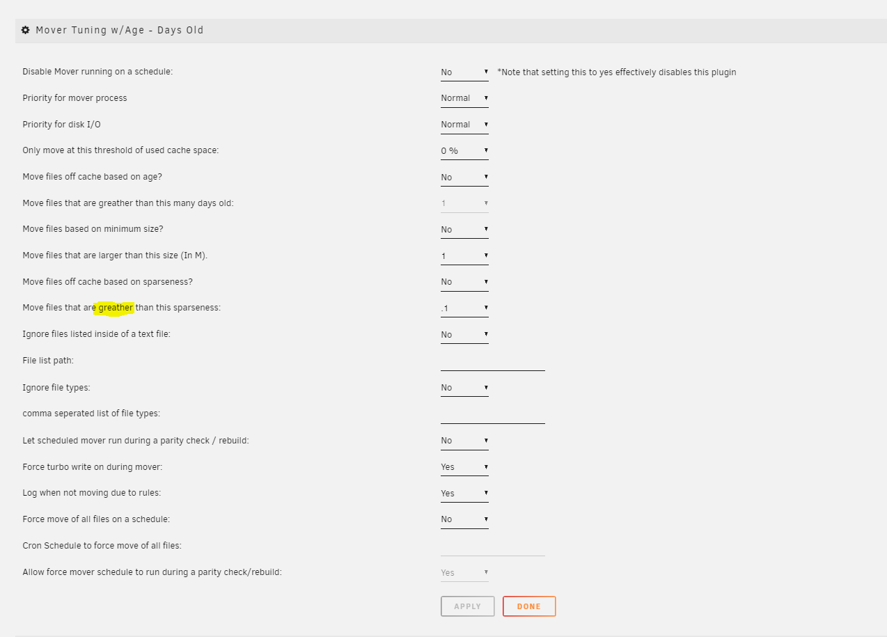

@hugenbdd I think I also mentioned this to you in my notes from first testings with you as well, All file Paths need to be encased in "" otherwise the script language thinks its a new parameter or command.
Also form one terrible speller too probably someone how made a mistake, you have a spelling error :)
Missed the space issue in the notes.. Sorry.
Will fix my fat finger mistake shortly...
