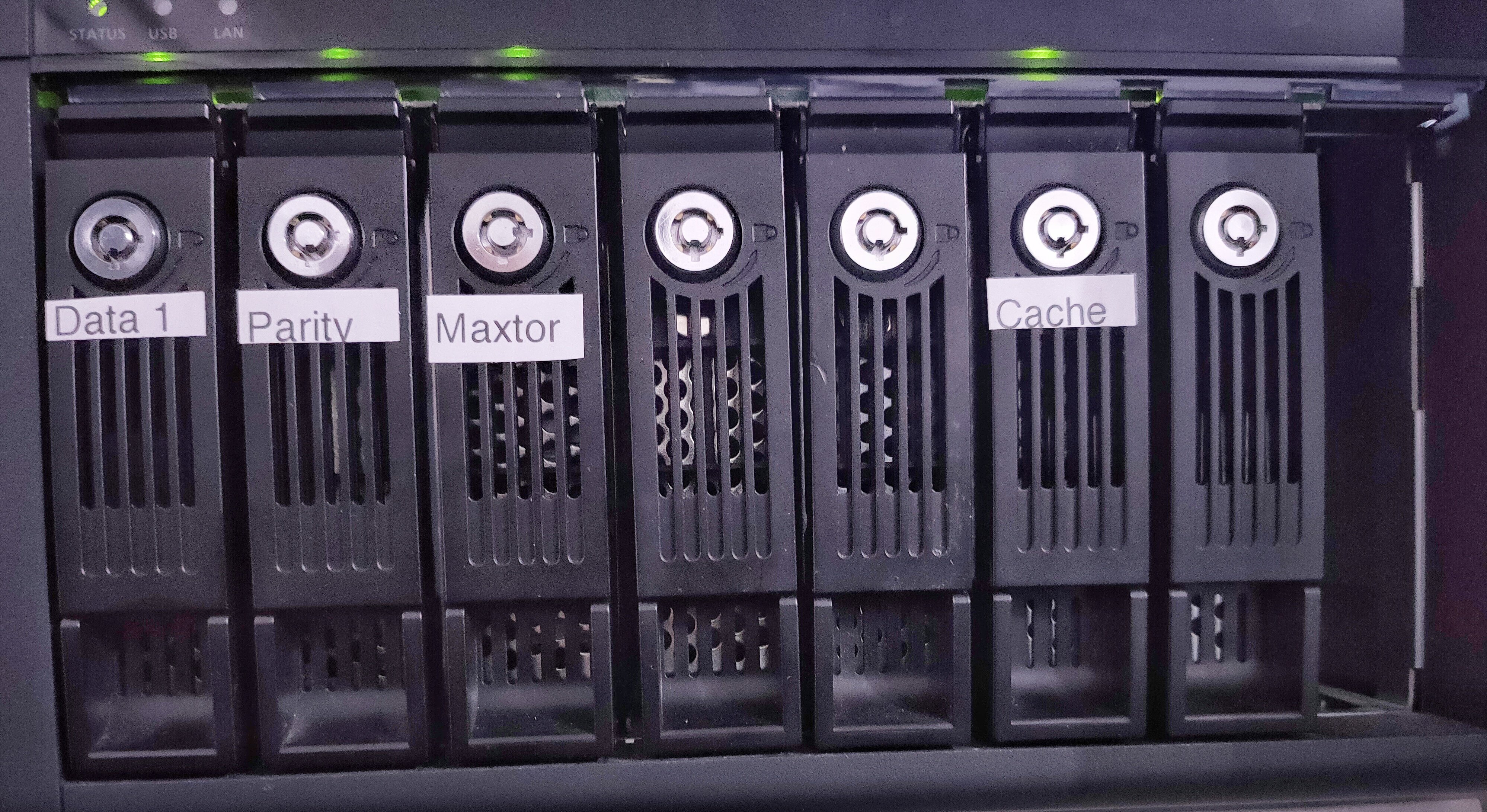

Oh, and I'm marking the drives externally so I won't get them mixed up again!
I'd recommend using the last 4 digits of the serial number for the drive, since the serial number is how Unraid keeps track of assignments.

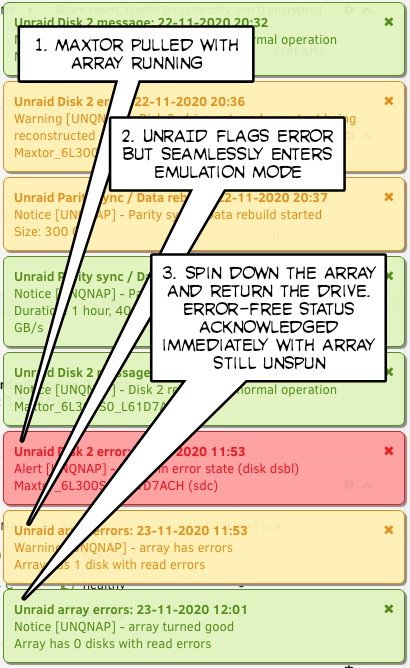

OK, I said I'd try a clean rerun of this without a) the senior moment about which drives are where and b) my misunderstanding of when you can hot-swap. This is that clean rerun.
1. I start with an entirely sane array. It's running but I then pull the Maxstor, simulating a sudden drive failure.
2. UnRAID flags the failure and straightaway goes into emulation mode. In this mode I'm able from my Hackintosh to tap into the (emulated) Maxtor share, use VeraCrypt to mount the encrypted disk image therein and play any of the multimedia files it contains. No buffering or glitches. Exactly as if the Maxtor were present.
3. The big mistake I made last time (I believe) was to plug the drive back in with the array still running. This appears to confuse UnRAID and it keeps using the emulated drive instead of the real one. This time I spun down the array before reinserting the drive. With the array spun down, UnRAID appears to recognise the returned drive almost immediately. I'm not clear how it does this. Is there a checksum of the whole drive somewhere on the Maxtor that corresponds to a checksum retained by the parity drive?
What I've learnt here is that, yes, you can pull a drive while the array is running without affecting services across the LAN to client devices. But it's a good idea (probably mandatory) to spin down the array before returning the drive. And I'm assuming that if your hardware supports hot-swapping you should be able to follow all the similar procedures suggested in the manual but WITHOUT having to power down the machine. But do spin down the array.

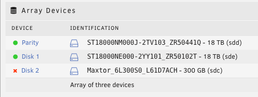

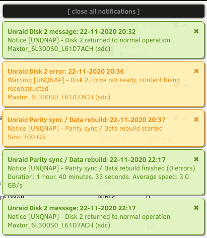

The drive will stay disabled until it is rebuilt.

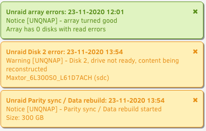

I believe you are mis-interpreting the messages, but it's understandable why, it's misleading.
The last green message is referring to whether or not the read error column has a non-zero value, and those columns (read / write errors) are set back to zero when the array is started, regardless of whether or not there is a disabled drive slot.
You're right, jonathanm. The drive is still marked as emulated. So what the green message is saying is "There are no read errors because I haven't actually read the disk. And if I do read the disk, I'll be reading the emulation, which by definition, won't have any read errors."
So the question arising from this is how do we get the array to acknowledge the physical drive and use that instead of the emulation?
Chris
So we're saying the rebuild is mandatory. That seems to be a real shame.
OK, I'm going to spin down the array, leave the drives physically where they are. Then restart the array in maintenance mode, unassign the drive from the Disk 2 slot. Then spin down the array, reassign the same drive to that slot and spin the array up again.
It should then rebuild?
I see "Replacement disk installed", which does suggest a rebuild is being triggered.

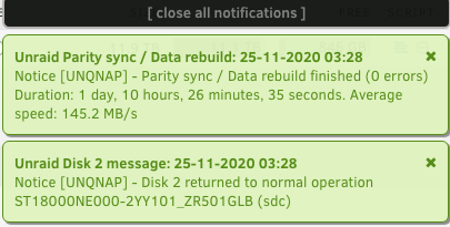

And indeed...
But this rebuilding of a perfectly good drive seems to me suboptimal. Is there really no user intervention that can say, trust this drive until the next scheduled parity check*? I assume a workaround would be to leave it as an unassigned drive and share it out from there.

1 hour ago, bidmead said:
confuse UnRAID
Not confused at all. No point in replacing a disk with array started (or even under power) because Unraid won't use it until rebuilt, and it won't begin rebuilding until you assign a disk to the emulated slot.
You will have to stop, unassign the slot, start the array with nothing assigned to the slot, stop, reassign, start to begin rebuilding.
It is out of sync. Either rebuild it or rebuild parity, and the data disk is the one that is wrong in this case.

Sorry, trurl, I was late reading this. Yes, that's what I've done. Rebuilding now.
Recommend to UnRAID management how the reporting of the replaced drive might be better handled?
This, sort of. How could the notifications be worded so that you understood that the specific drive was still disabled, when at that moment in time you believed everything to be OK?
Should the disabled drive notice be spammed? Too many notifications can cause people to ignore them, thinking "ok, ok, I got it" when they really don't "got it".
I'm trying to find a way for Unraid to help people understand the urgency of the issue without overdoing it.
