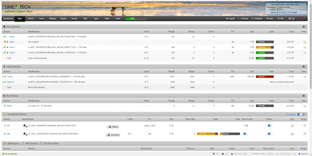

I was attempting to encrypt an array of three discs and one parity disc by emptying one disc, reformatting it in the xfs - encrypted format,  and moving data to it from the next disc to be encrypted. On the last disc it gets 708 GB of data (4 TB capacity) then gives a full indication and the rest of the data goes to the cache which intern fills up creating an error. I have taken the disc that is not accepting new data out of the array and used it as an unassigned device to copy data to the remaining array but again the cache fills then gives an error. tried to upload diagnostics file but got error that only 25 files were allowed so here is a link to the zip file. Any help or insights will be greatly appreciated.

You have a stale browser windows open filling the syslog with wrong csrf token errors, making finding any other error very difficult, close that browser window, reboot, try to copy again so you get the out of space error and grab and post new diags, also explain exactly from where to where are you copying.
Filesystem       Size  Used Avail Use% Mounted on
rootfs           7.8G  7.8G  9.8M 100% /
If I was going to take a guess, you've been copying via the command line or something, and a typo is causing everything to go to RAM.
Using Krusader to transfer files. Will get that stale browser window closed and try again. Thanks.
From where to where?
e.g.: /mnt/disk3 to /mnt/disk1
