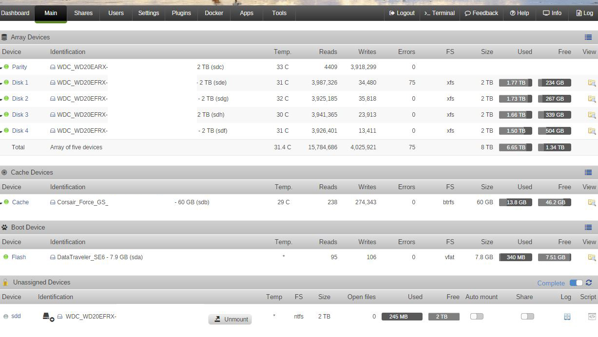

Hi guys, long time lurker here. I recently swapped my server from an N54L microserver to a dell r720. The transition went smoothly or so i thought. Decided to add a parity drive and cache drive (I confess previously, i was running with out either). I have read a lot about CRC errors, read errors, and write errors etc. Can someone just verify if this is something I should be worried about or not ? I.e. do I need to correct the parity / ignore or replace the disc immediately.

Disk1 need to be replaced, there's missing time on the syslog but assuming the read errors were during the parity sync there will be some corruption on the rebuilt disk.

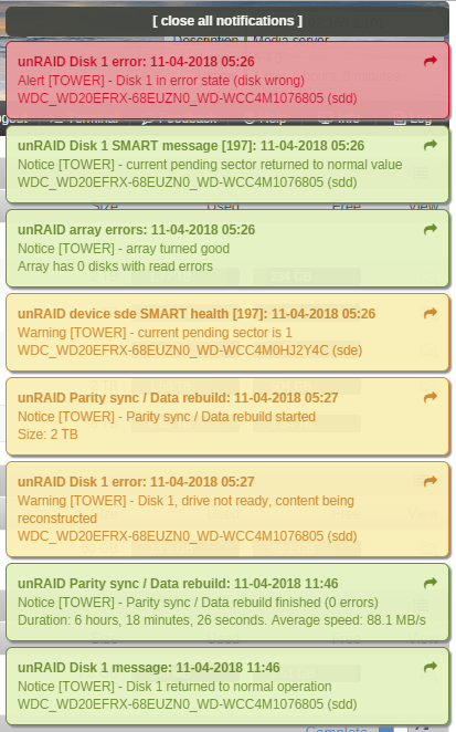

So I rebuilt disk 1, and now have zero errors, so everything seems to be ok. From what you guys analysed earlier on the previous disk, is there anything that can be done to re-utilise it, or is this one for the scrap heap ? Below were some of the notifications i got, but ignored, and it finished itself. Thanks for everyone's help. I'm glad we got it solved.

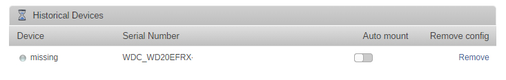

Is it safe to remove the config at the bottom for historicals. Just checking it wont affect the newly built drive.
yes
Make sure you have Notifications sent to you by email or some other agent so you will know about them even if you don't open the webUI.
Remember that you had 75 read errors from disk 1 when you created the parity drive.
That means that the parity drive have 75 blocks with incorrect content.
Which means that when you replaced disk1 and had unRAID rebuild the content, there will be 75 blocks on the new disk1 that has incorrect content.
So having zero write errors now doesn't mean you have no file corruption on the replaced disk1. It just means that the new disk1 has no known hardware error so unRAID is able to read/write all content.
