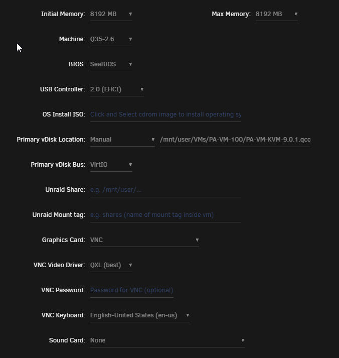

July 27, 20188 yr I'VE DONE DONEIT! K, so here are my findings. Test was done with Check Point "R80.10_T462_Gaia.iso" downloaded to my ISO share. I generated a 30-day eval license from CP's website. You must create a RedHat VM. YOU MUST! You can see attached, but basically... In my environement (dual intel xeon) Tested with 80GB vdisk, 8GB RAM 4 cores and 8 threads... way overkill for CP. Also, I haven't seen CP utilize any threads.. I'm sure its just the nature of CP. =================================================== i440fx-2.11 SeaBIOS Sata (MUST HAVE) --- IDE and SCSI do not work. VirtIO disk (80GB in my case) No shares... VNC no sound selected two "v"-NIC's I'm running br0 and br1 =================================================== done! Check Point supports Red Hat Enterprise, so I guess we got lucky this time! On to Palo Alto! Edited July 27, 20188 yr by RifleJock Spelling

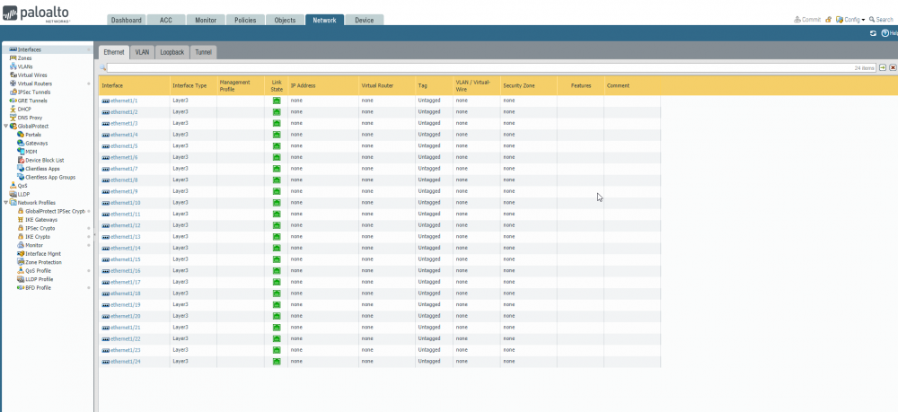

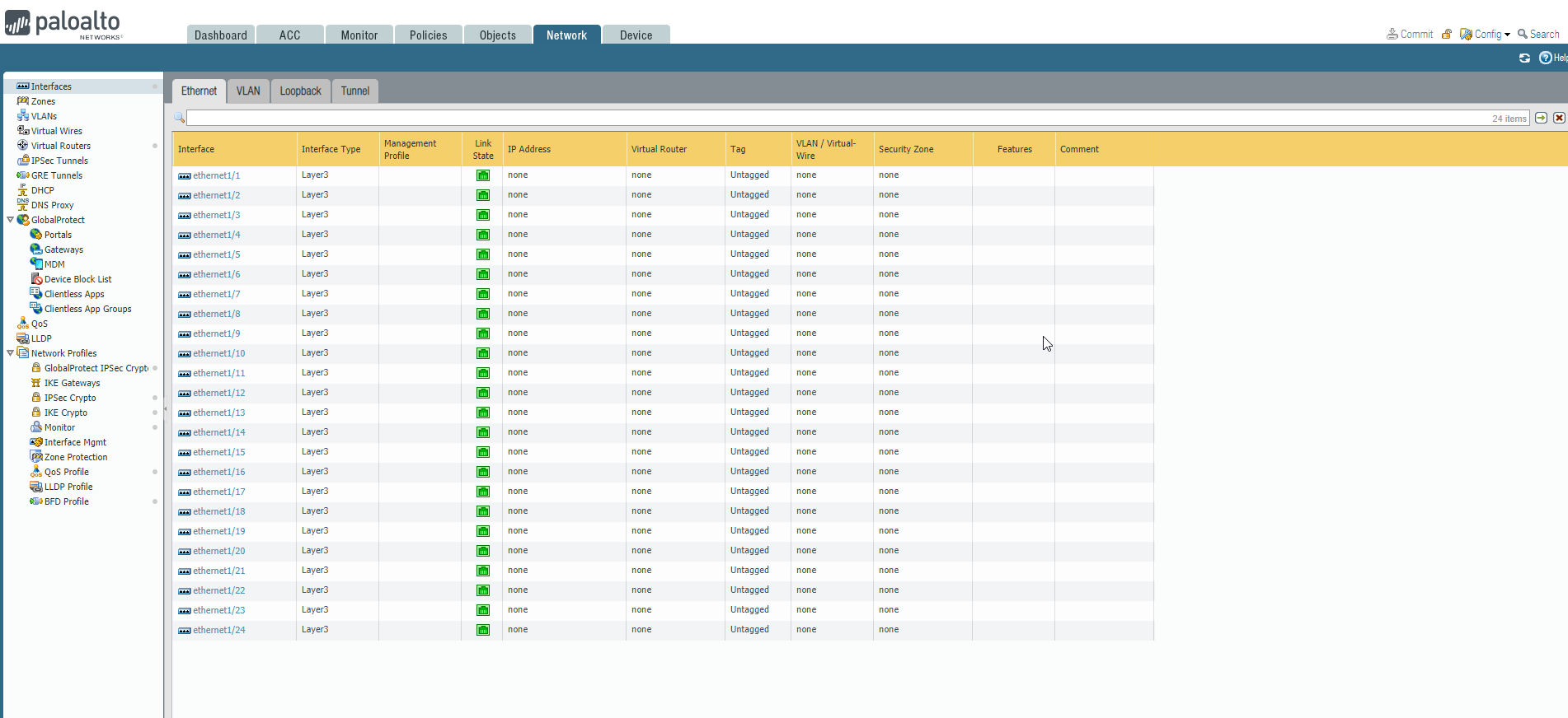

September 12, 20197 yr I've got PA-VM (KVM) working. Here are the settings so far and the issues I've ran into. =================================================== I've been able to get 11 network interfaces to work. Any time I attempt to add the 12th network, the "Guest has not initialized the display (yet)" comes up. I've got nothing out of the ordinary in the logs other than the "hostnet12" is never registered. Additionally, all but the first CPU max out when attempting to initialize. ... -netdev tap,fd=48,id=hostnet10,vhost=on,vhostfd=49 \ -device virtio-net-pci,netdev=hostnet10,id=net10,mac=52:54:00:b7:f8:2a,bus=pci.13,addr=0x0 \ -netdev tap,fd=50,id=hostnet11,vhost=on,vhostfd=51 \ -device virtio-net-pci,netdev=hostnet11,id=net11,mac=52:54:00:a4:8c:87,bus=pci.14,addr=0x0 \ -chardev pty,id=charserial0 \ -device isa-serial,chardev=charserial0,id=serial0 \ -chardev socket,id=charchannel0,fd=52,server,nowait \ ... A force stop and removal of the 12th interface works great! I'm beginning to wonder if this is a limitation with UnRAID's ability to have that many iPXE bootable nic's registered to a single host vm. I'm going to be looking into how to disable the PXE capabilities to troubleshoot this theory later. Anyways, here is what it looks like in the web-ui for the PAN-OS. Interfaces start off grey as they are by default in "tap" mode. Configuring them to all be layer3 (and committing configuration) will bring the link up/down lights active. Yes only 10 interfaces show here, because the management interface counts as the "first" interface. This can also be proven when reviewing the MAC address in the console (vnc window) and in the configuration of the vm via unraid's web-ui. Oh, and additionally, my br0 is a 10Gbe NIC, Palo is only registering this as 1Gbe. Not sure if this is a limitation of the linux vm profile or if this is a limitation of the PAN Software for their VM builds. I do know their physical device do have 10Gbe capabilities. Here is the rest of the configuration in order to get this to work: Started out with "Linux" VM. In the past, I've used CentOS, but this limited me to 5 interfaces (4 active + mgmt) and only when custom added by XML rather than adding them additionally via the gui template. Even though SeaBIOS was used here, I've gotten a UUID (which I believe means that the device is booting UEFI capable.) My initial image was the 9.0.1 kvm build downloaded from Palo's site. This should give you a .qcow file. You can place this in any share (I've placed mine in the VM share(/device name/file.qcow) and manually selected it and used VirtIO for the bus. This, by design of palo, created a 60G vdisk as seen below. I've not found a limitation yet on how many cores can be added (Unlike Check Point) Thus far, I've had up to 80 "cpus" or 40 cores and their respective threads. In my system, this spans my dual E5 2696 v4's which are 22cores 44threads a piece. VM runs fine when spanning across both CPU's in the system. Additionally, I was able to register a license via palo's website and gain a serial number for the device. Which also allowed me to download and install an even newer version of code. Based on these findings... This could be a promising setup for those wanting to run Palo in a Virtual environment from an UnRAID build. Edited September 12, 20197 yr by RifleJock Added note about the physical NIC being 10gbe.

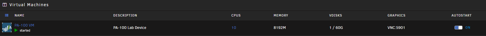

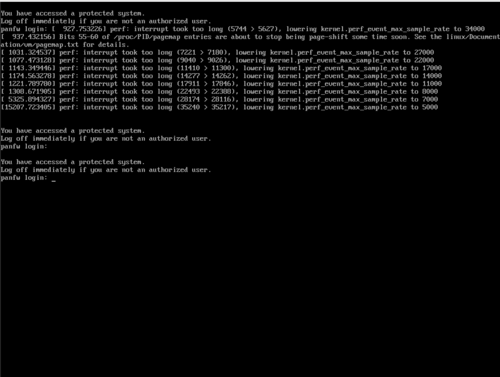

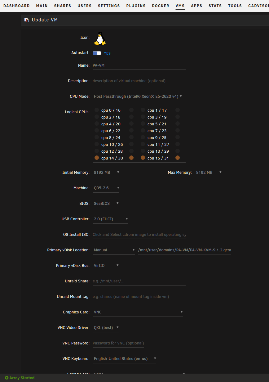

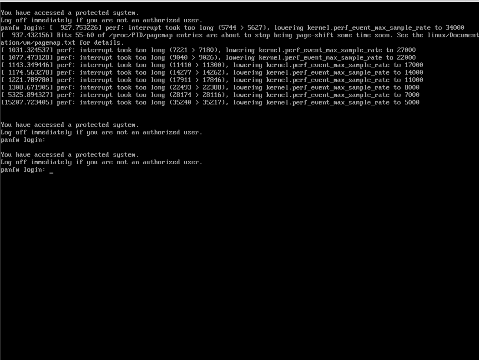

July 20, 20206 yr I know this is an old thread, but for anyone that stumbles across it looking for advice. I did get this working on 6.8.3 with the PAN os 9.1.2 qcow image (I did not try any other version). See below for my setting and I added 8 NICs the first being the management NIC. It takes a while to startup and I do get some errors (see screen shot), but it works well and I get the performance I need (500mbps down and 20mbps up).

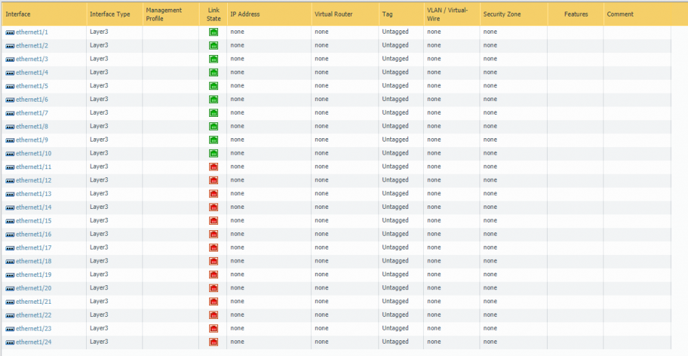

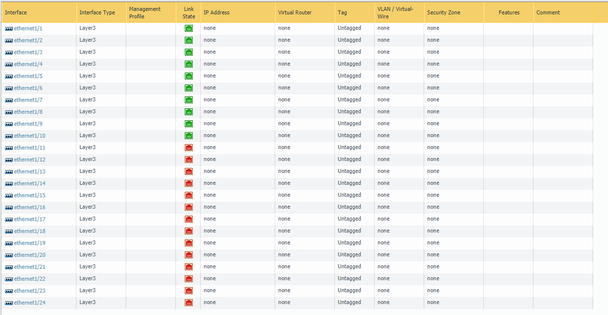

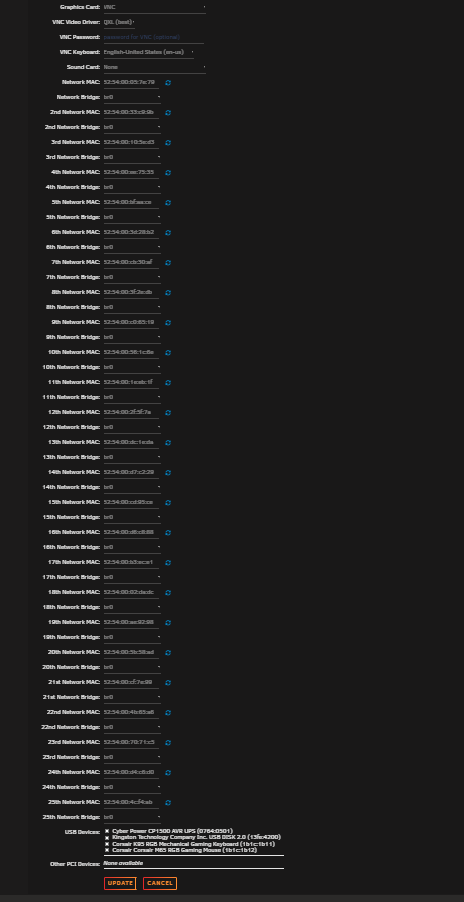

July 21, 20206 yr Hey jwiener3 and all others, As far as the perf: interrupt messages, I receive these as well, and the system seems to limit my login until it is done spitting those errors. Not sure if there are other processes still booting in the background. I'm assuming the "accessed a protected system..." is your banner/motd. As far as I know, those alerts don't actually cause any issues (that I have found). OH!!! Also, Update. Running Unraid 6.9.0-beta25. I'm now able to run much more interfaces. Currently running 25 (24 + mgmt). Adding the 26th does.... welp, apparently nothing. only eth1/1 - 1/24 show up, nothing after that. Even looking for the logical 26th unraid interface (25th palo alto, other than mgmt) I'm unable to find it's mac address. -Jockie Edited July 21, 20206 yr by RifleJock spelling
