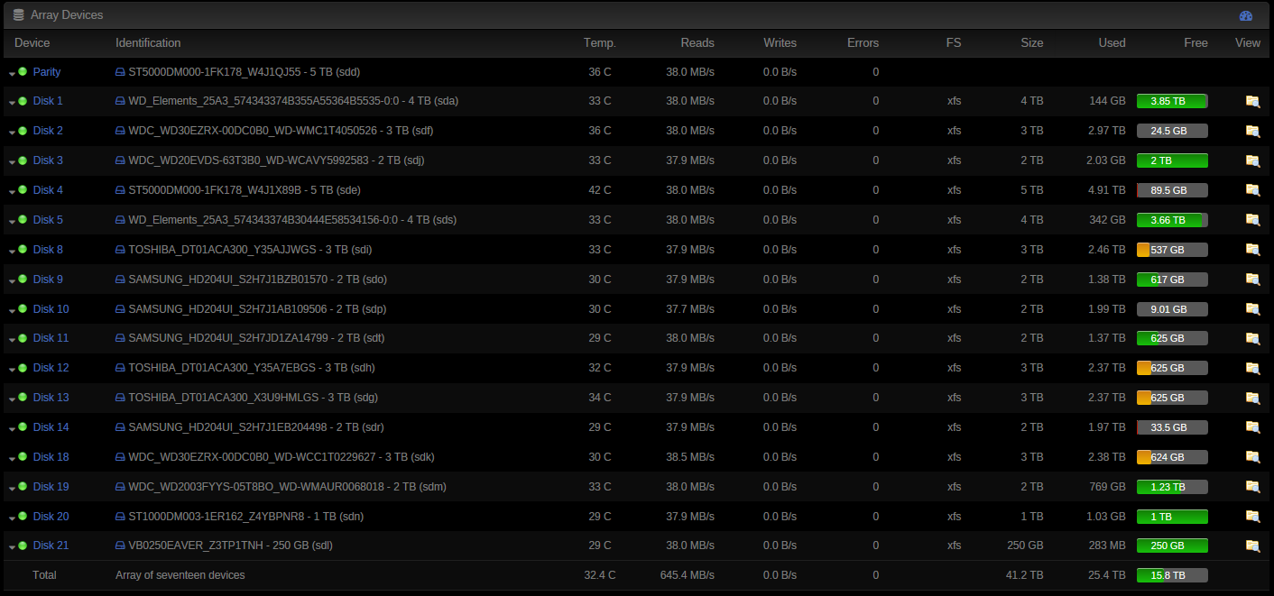

Before we start i will say i am a new user, always used windows, i have moved from a server 2016 setup to Unraid
after a few weeks i have it setup just as i want it streaming plex and downloading via nzbget, when i was moving to unraid a few drives
appeared as failed so i have swapped all them out with new drives, but i am still getting errors, anybody that can point me the first
place to start looking for a fix i would be grateful, i will say the uptime is not high only about 4 days, from the main tab the array looks ok
thanks

Disk3 needs to be replaced.
Disk13 needs a new SATA cable.
Disk11 is also having issues but these look controller related, looks like you're using a Marvell controller connected to a port multiplier (or a controller with a pm built-in), both are not recommended, but especially not recommended using any port multiplier.
Edited by johnnie.black
I will add some to what johnnie has said above.
Your logs are so large that only excerpts are included in these diagnostics. Lots of disk errors in the logs I can see and probably that is at least part of the reason logs are full.
Also many of your disks are very full, some completely full. You have a share set to cache-yes (possibly named Media but it is anonymized) but you don't have any Minimum Free set for that share. So possibly you are also getting a lot of errors from mover logged as well since it may be trying to move files from cache to disks that are already full.
Please turn on Help and take a much closer look at the settings for your User shares. It is critical that you set Minimum Free if you are going to run with disks so full.
Also when you replace that disk make sure you check all connections, both SATA and power. Bad connections are a much more frequent cause of disk problems than bad disks. Possibly some problems you had before you asked that caused you to replace disks were really just bad connections.
And make sure you set up Notifications if you haven't already. It is especially important when you have so many disks.
