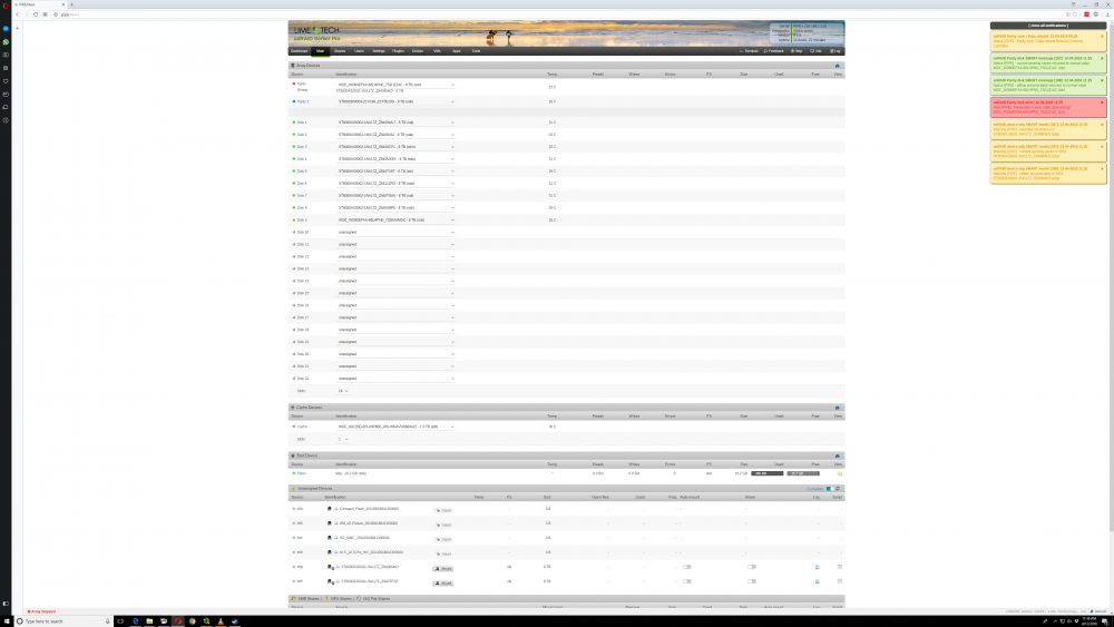

I replaced a disk that showed as faulty with a disk which had not been precleared and i had shucked from a seagate enclosure.  I added it to the array in place of faulty disk and started array with parity sync/data rebuild.
see attached screenshot. it appears to be rebuilding the disk, but there is also an option to format (unmountable disk present) - Is it or is it not rebuilding properly?
I thought it was possible to insert a disk to array and not preclear it first?  Did preclear plugin ever get fixed? I am unclear on that and in this case would prefer not to preclear the disk.
I know that as tempting as it is to hit that format button - it is not the thing to do - been there done that!!! -   I still think this trap should be fixed.
EDIT - replaced screenshot with proper one.  sorry.

based on what i quoted below, did i bring the new disk into the array wrong? i am going to stop the rebuild and try it this way , see if it works.  Not even sure if the data rebuild was really going to work out in the end the way it was going in above screenshot?

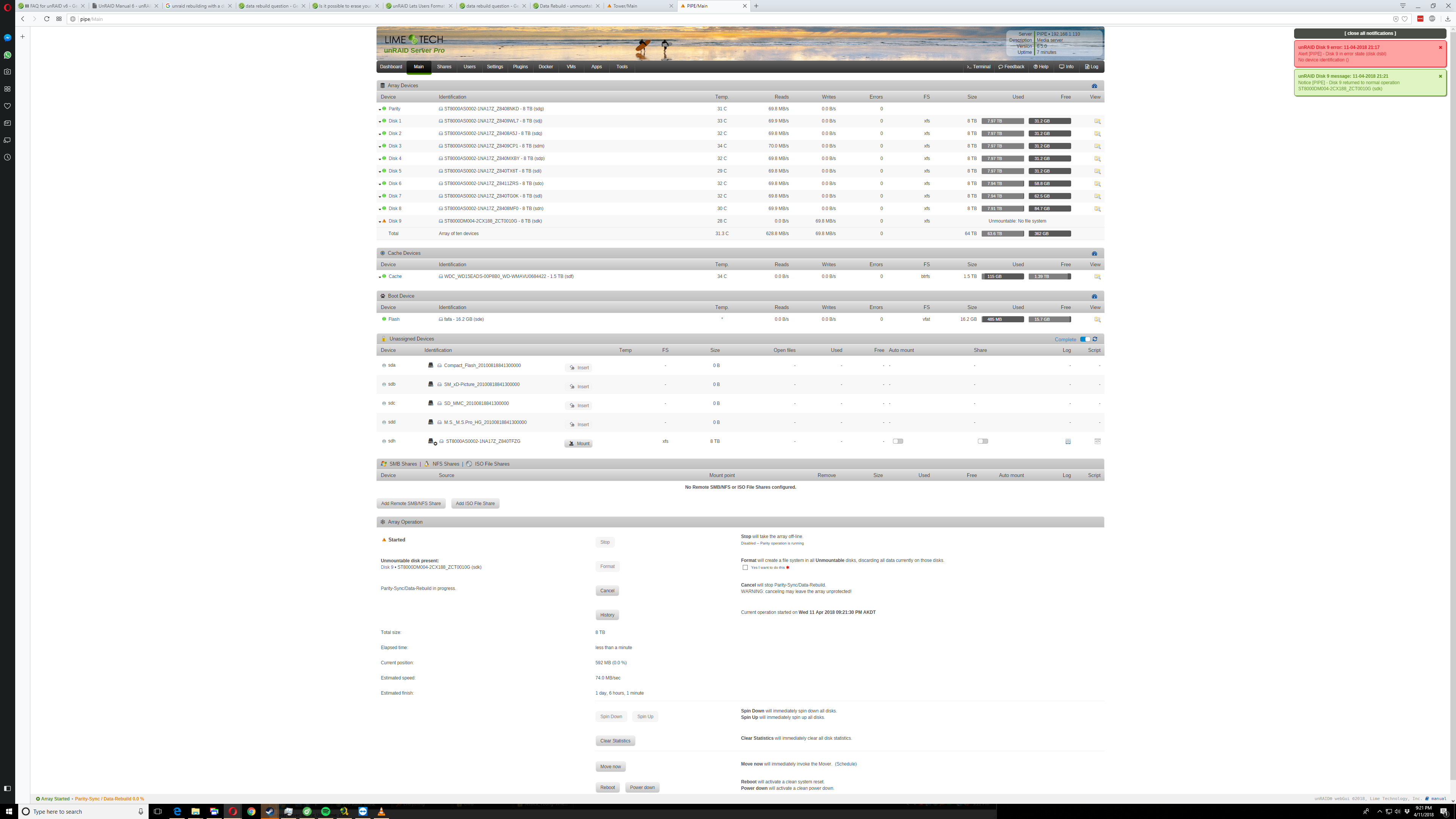

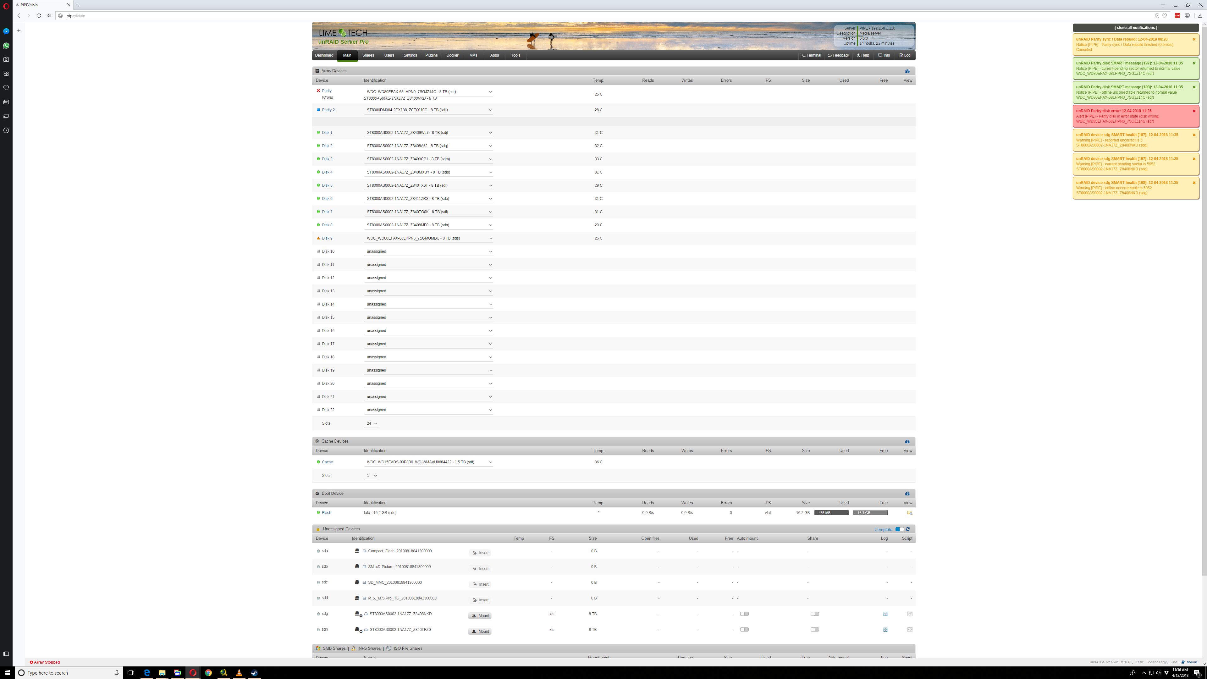

I tried this  - canceled rebuild, removed disk, started array with out disk 9 ( i didn't do any reboots though as both disks are in the machine already)
At this point it still gave me the option to format disk 9 even though it wasn't there - see screenshot
stopped array, started again with new disk in disk 9 slot.
started array with rebuild - option to format is still there.
Something seems very wrong.  No i  am not an advanced user, perhaps i am good for dummy testing things.. It just seems really dangerous.

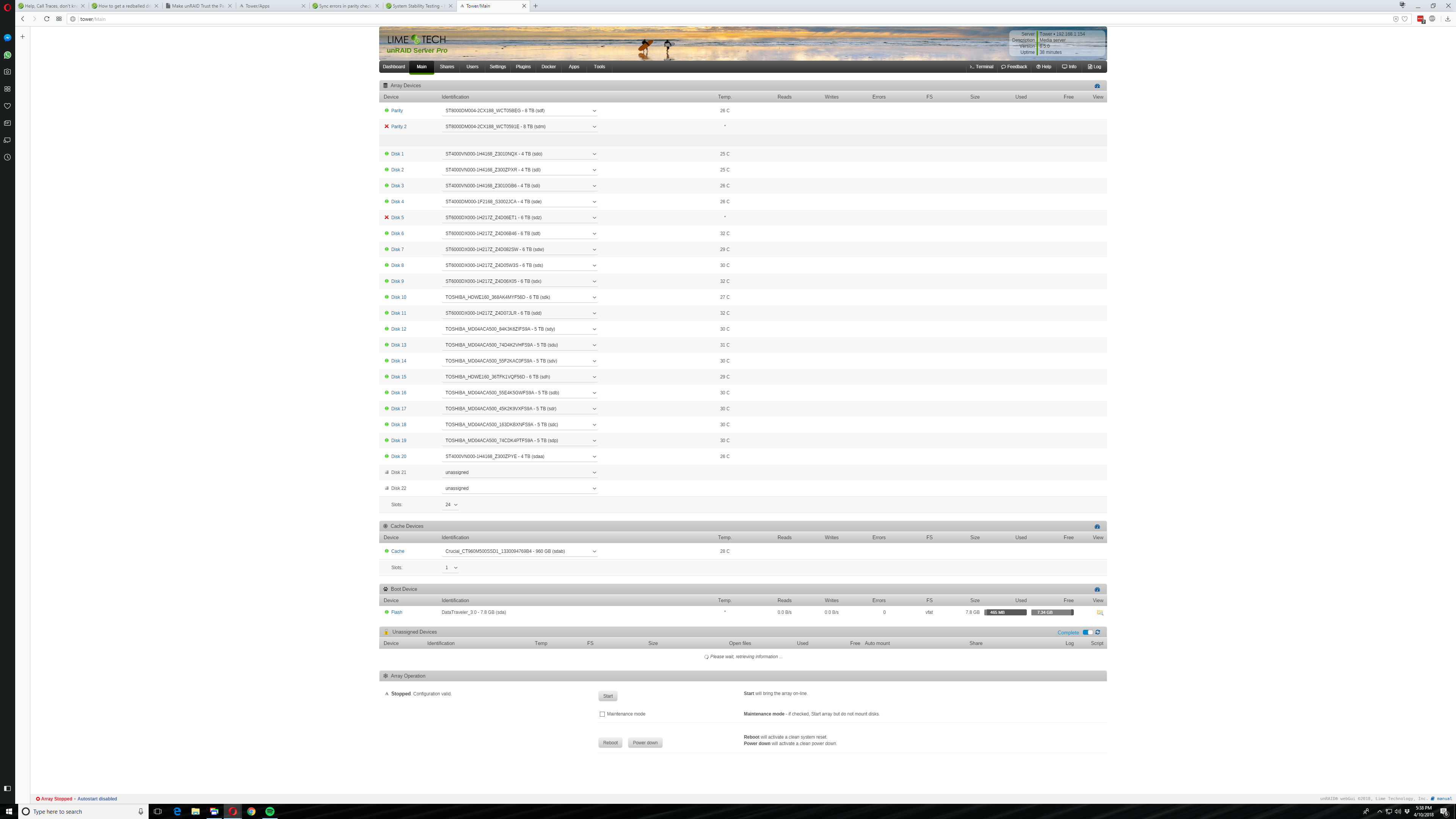

I am ready to press start but it says too many wrong and or missing disks on parity 1 - see screenshot. it also doesn't give me an option to start on bottom- says too many wrong and or missing disks.
I did Tools -> New Config -> Retain current configuration: All -> Apply
then i made the following changes - changed old parity 1 drive to a blank new drive
removed drive i was trying to rebuild as disk 9 and put unassigned
added the drive which i was trying to rebuild as disk 9 as parity 2
added blank new drive to slot 9
5acfb5f368e14_Screenshot2018-04-1211_36_08.thumb.png.412454c83ab549301c453d8b942af435.png

Standing by, until i hear what to do here,  Either i did something wrong on new config or new config method will not work?  My assumption was that new config allows you to build an array with more removed disks than necessary for parity recovery?  see screenshot 2 posts above for error.
You didn't do a new config, or all disks would be blue (new), repeat the porcedure.

I believe that must be what happened - its all blue now.  Thanks to both for your help. I really appreciate it..  Really really really :), its a bad feeling not knowing what is gonna happen to your data.
The parity rebuild is going, disk 9 is formatting
