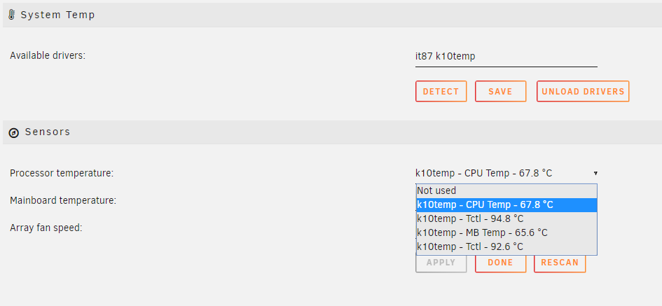

Temperature question for anyone with this motherboard, my motherboard is reporting at 95.8C, which seems unlikely to be accurate.  I know the CPU temp has a 27C offset but haven't seen anything about the motherboard.  I ran sensors-detect and added this to my go file:
# modprobe for each sensor
modprobe k10temp
modprobe it87
Is there a fix for this?  Is 95.8 accurate? Not accurate but have to live with it?  In dynamix system temp, "it87 k10temp" is in Available Drivers, and the mb temp is labeled "k10temp - MB Temp.  k10temp CPU die and tdi are in the high 60's, I think it's clear that these are CPU sensors.  Tctl is in the mid 90's, which is just the annoying 27C offset.  So there aren't any obvious alternatives.
Edited by bobobeastie

@guru69I have the same chassis and cooler and replaced the stock fans with some kid of Noctuas, which you did as well.  I don't see that you mentioned the motherboard temp, is it similar to mine?  If not what do your settings look like?  I'm assuming a spot on the motherboard actually being 95.8C is pretty unlikely, or if it was headed in that direction it would shut down before getting there. I suppose rebooting and checking in the bios would help, but I'm in the middle of a parity check, which I'm doing after a parity rebuild, because my 2 parity drvies decided to become disabled.
I'm not so worried about the CPU because of the 27C Tctl offset, and it looks like Tdie or CPU temp are without the offset, and they seem fine.  My CPU temp is reading 68.7, and I am running a handbrake docker that's running full tilt, not pinned to any core.  My best guess that the motherboard temp of 95.8 is also getting an offset for some reason, because that brings it back down to the same range as the CPU.

Temperature on this board wasn't available at all when I started, so I have kind of been driving blind until now 🙂 I replaced the Norco center fan plate with the 120" one, dumped their fans, put Noctua everywhere and used liquid metal on the CPU and hoped for the best. Here are what mine look like, I just assumed the CPU will be hotter than the mobo when picking, maybe have the sensors switched? I haven't had any thermal shutdown even when the room reached 90 one day (A/C died) and this server has been running around the clock for over a year, so guess its ok. I live in the deep south, always hot, so I have a 5,000 BTU window AC running cool/max 24/7 about 2 feet my server. I smoke one of these window AC units about every 2 years, but I buy a few of them when on sale.
I have been reading through and a bit confused still (not hard) is the CPU Temp real or is it tctl? you guys mention tdie but I don't see that?
Cpu temp is real. Tctl is the temp with 27c offset, that is used to control fan curve
Sent from my MI 8 using Tapatalk
Thank you, I don't have to worry then! 😄
