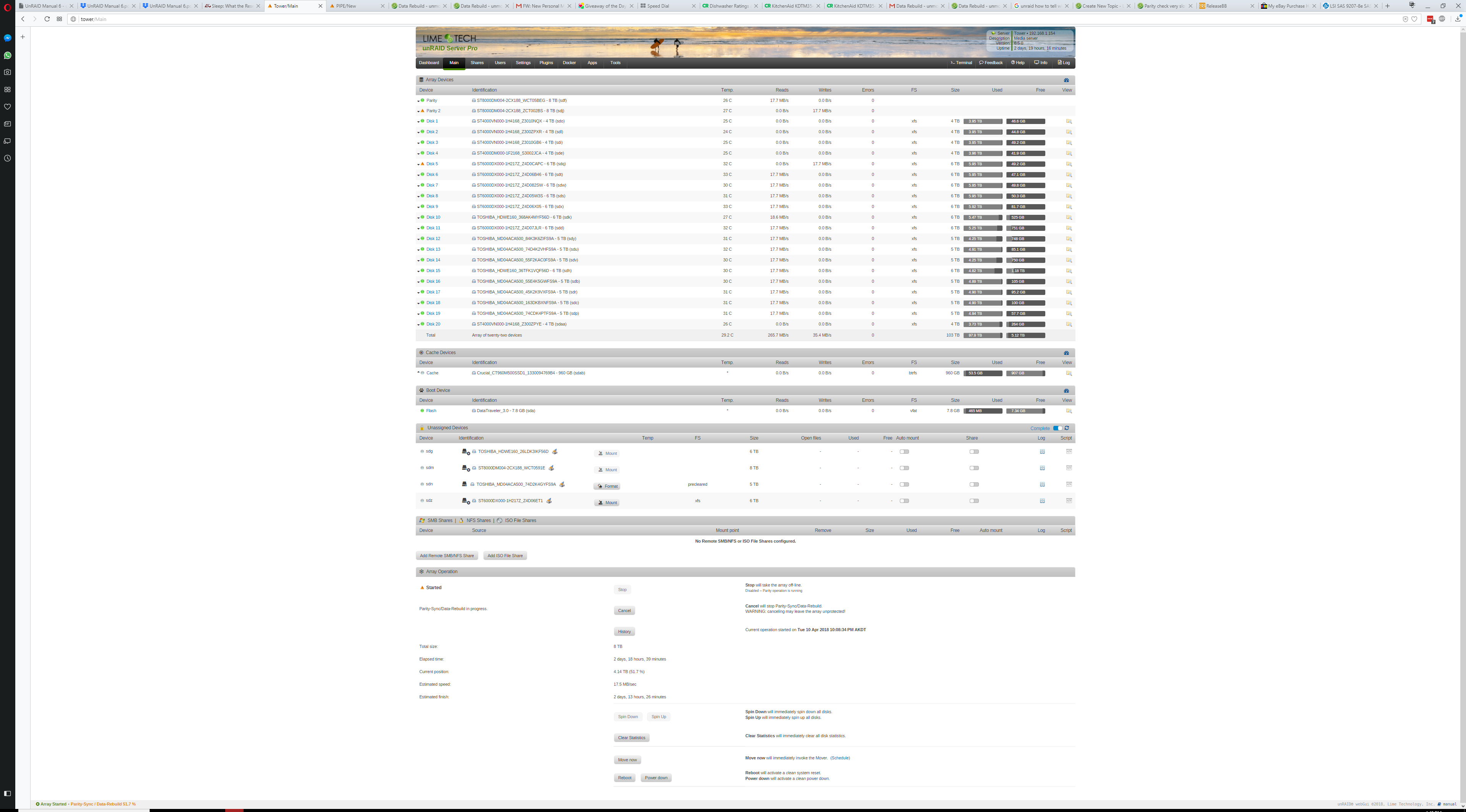

I am in the process of rebuilding 1 of 2 parity drives and another drive - see attached screenshot for drive config and current speeds.  It is taking about 5.5 days to do the rebuild.  It seems that the time really slowed down a while back when i installed 2 8tb Seagate (non archive) drives from 2 6tb seagate drives.  I have all my dockers turned off, i have directory caching to memory on.  I am using 2 silicon graphics se3016 16 drive caddies to hold the drives. https://www.servethehome.com/sgi-rackable-3u-16-bay-se3016-sas-expander-chassis-forum-deal/ They are directly connected with 1 cable each (not daisy chained) to a SAS9207-8e card, which is in pci express on mother board for video card.  I watched the speeds and was thinking, maybe its a 4 tb drive thats slowing things down, but speeds still bad going towards the 5 tb drives.  I will have to wait a while to find out if it speeds up once both 4 and 5 tb drives are eliminated from the parity check.

Screen shot 1 - of rebuild5ad151877a071_Screenshot2018-04-1316_51_46.thumb.png.b746d02f1167db4db09735c2643c4fe9.png

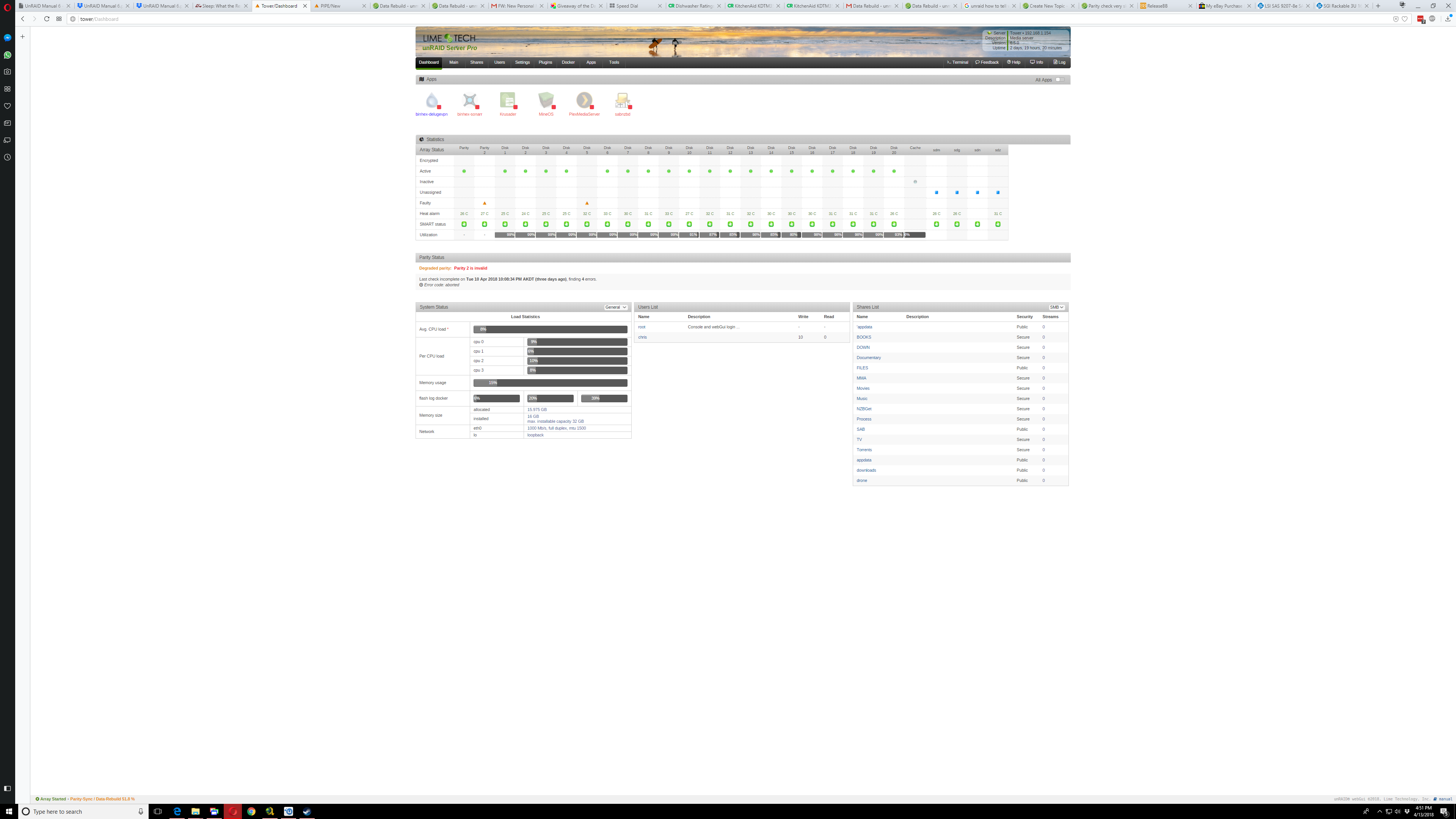

Screenshot 2 - of rebuild 5ad151b249e1d_Screenshot2018-04-1316_48_22.thumb.png.ee4b88e65a153f5fc9cb754cc6083407.png

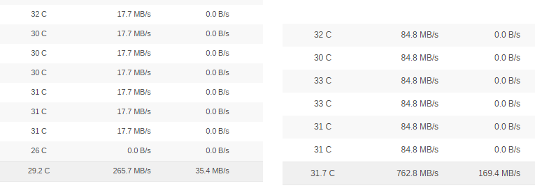

Seems Se3016 was 3gbps expander, if plug all drive in and R/W in sametime, then it really slow.

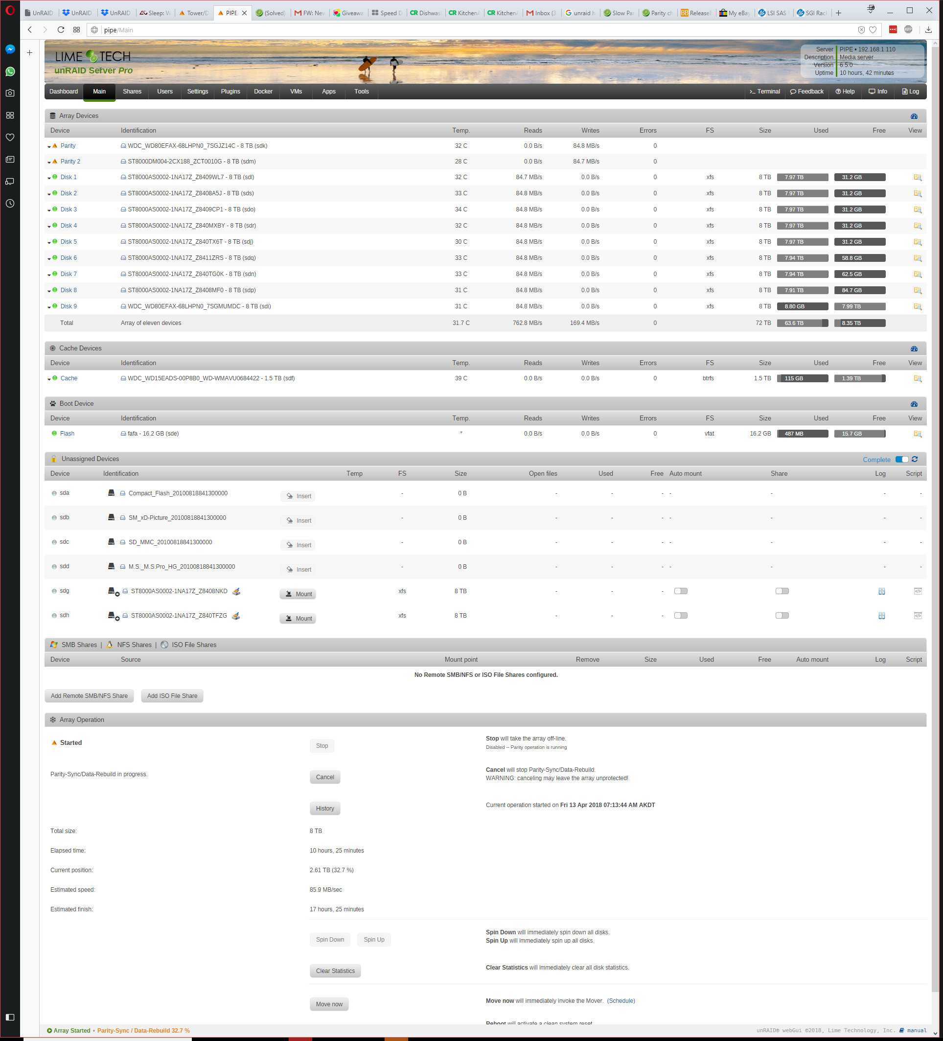

This is a screenshot of another server i have building 2 parity drives with same hardware except computer is much slower (but just 10 drives in 1 chassis instead of having 2 chassis going at same time) - total speeds are about 4x higher.  -
Could you explain how a 3gbps expander will got 763MB/s bandwidth ?
So the first screen capture seems reasonable ( assume those drive in Se3016 )
