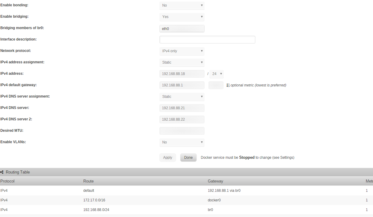

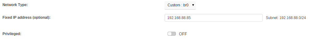

I cant get fixed ip to work.
If I bash into the container. It show the correct IP, but I cant ping the gateway or internet.

The DHCP range for your containers is set as 192.168.88.64/27, which means a range from 192.168.88.64 to .95
When you assign a fixed address it should be outside the DHCP range to avoid possible conflicts. Instead of .85 take another number. Also keep in mind that this number should not fall in the DHCP range as set on your router.

Everything on the unRAID side looks fine and is set as expected.
Perhaps it is an issue on your router? Does it have any firewall rules which may prevent communication?
